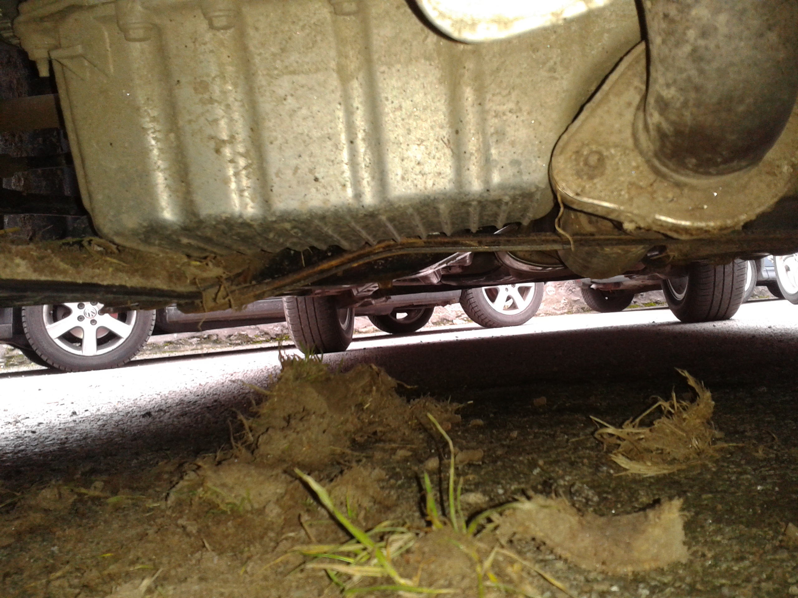

Problem solved though. Had to top up the coolant today so whilst under the bonnet i had a good look around.
That b****y bar that hits every rut on rough roads has gotten bent, I hit a rock at 20 mph just after i got out of the ice. Either that or it was when i was trying to drop into a piece of road with no surface when the idiot contractors decided to dig up the road in BOTH directions to my parents house so they where completely inaccessable.
See the attachments. If i can't straigthen it out then i will need a replacment. The exhaust is also dented where the bar crushed it.

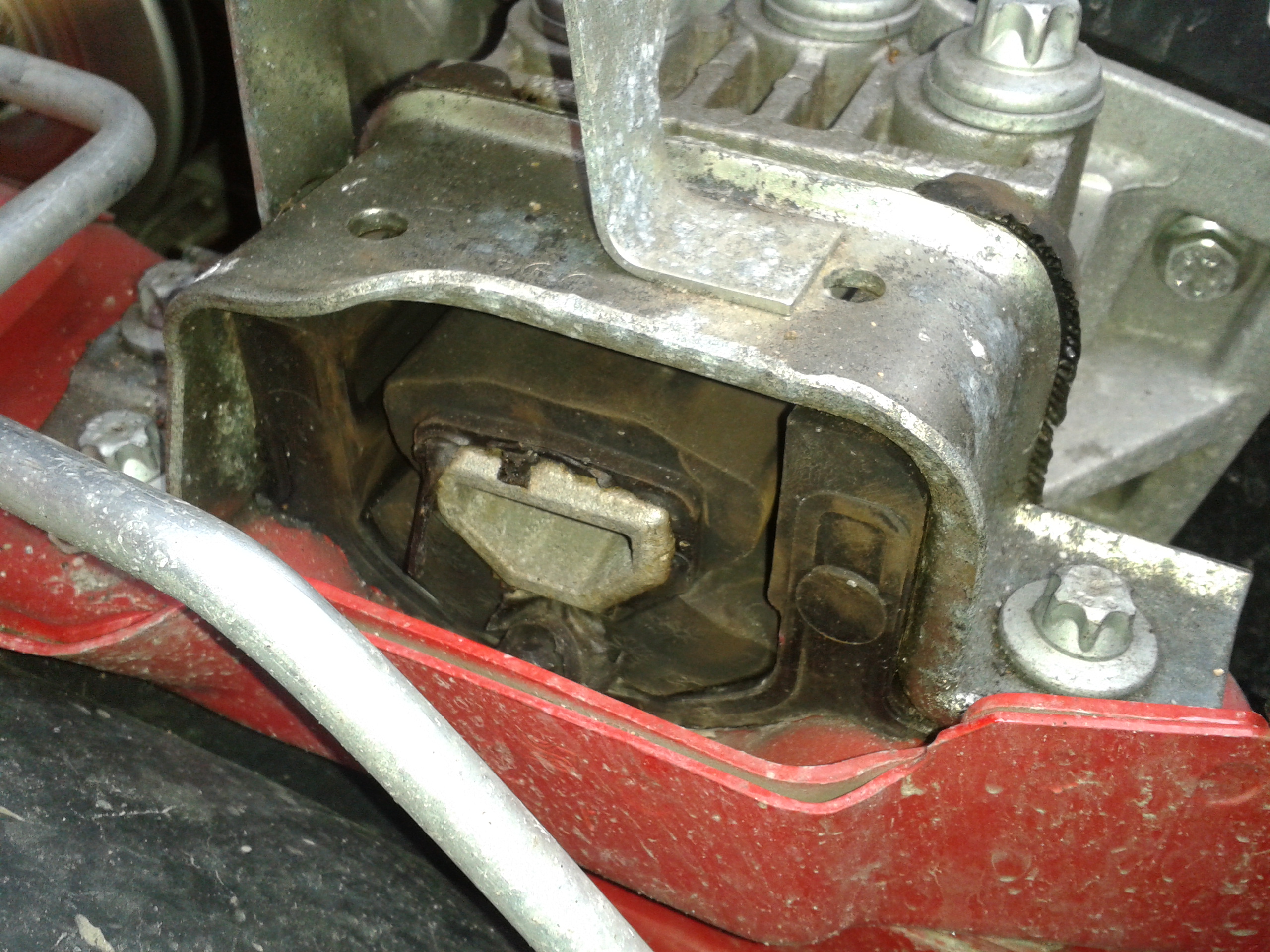

Also attached is a pic of my top drivers side engine mount. Should it look like this? The rubber is quite soft and there appears to be nothing to stop the engine moving up and down.

glad you found it..
can't quite tell with the bent bar what it is/ does,
is it just a lightweight support - holes / slots all along it's length?
if so just bent it back,
Engine mount.. MMmm - not too sure looks a bit worn / degraded,
maybe just book an oil change at the FIAT place and mention it ( if the cars still under warranty),
otherwise see if it's a common issue,
