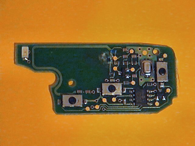

The remote locking is a different system again and depends whether your new blue key has a working remote CB inside like the one above. If it does then again Fiat should be able to program your car's remote locking to accept the different fob
