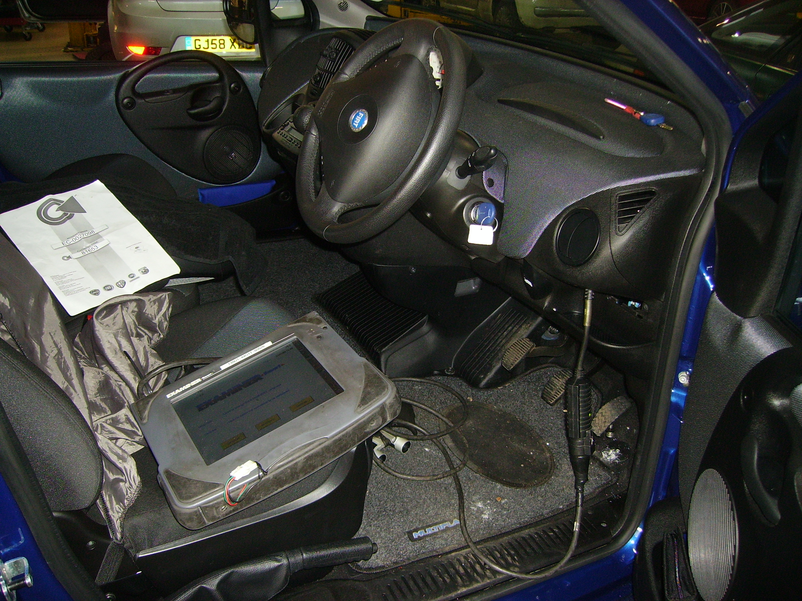

So, firstly Chris grabbed the now legendary 'computer' which reads the ecu on the car and looks for all sorts of faults. It looks like a laptop with a lead and pluggy thing coming from it. This lead plugs in under the right hand side of the dashboard on all Multiplas. Look under your dash, extreme right and there is a little panel that pops out and your diagnostic socket sits there.
We mated Myrtle to the computer. Just to demonstrate the computer's talents, he checked my ecu for faults and there were none (thank heavens, I'd just spent £10,000 buying the bloody thing!)

My existing key was placed in the ignition. As it was an approved key, the computer read the key code box and ecu and I was amazed to find that it knew that there were two keys in existence for my car. It had all of the info on those keys, including the electronic code which is necessary to program the key to the car. Chris then asked if I had the other key, which I didn't. So he cancelled this key. So if the old owner (an MD at FIat UK!) tries to nick the car with his key, it will no longer be recognised!
He then put the new key in the ignition. The computer was asked for the key code, which he promptly entered and after a bit of software wizardry, he turned the key in the ignition and, a roll on the drums (and a sandwich on the piano....), the car started. Cool. This key code is individual to the key and should come with it when it's delivered.
Unfortunately a problem then arose. The alarm would not recognise the key. When we pressed the plunger to arm the alarm, nuffin happened. Bugger all. Zilch. Not a lot.
Never mind. Chris whized off to Service Reception, prodded another computer and swiftly came up with an alarm code to program in. In went the new key into the ignition, more witchcraft and, wahey, one completely working key.
