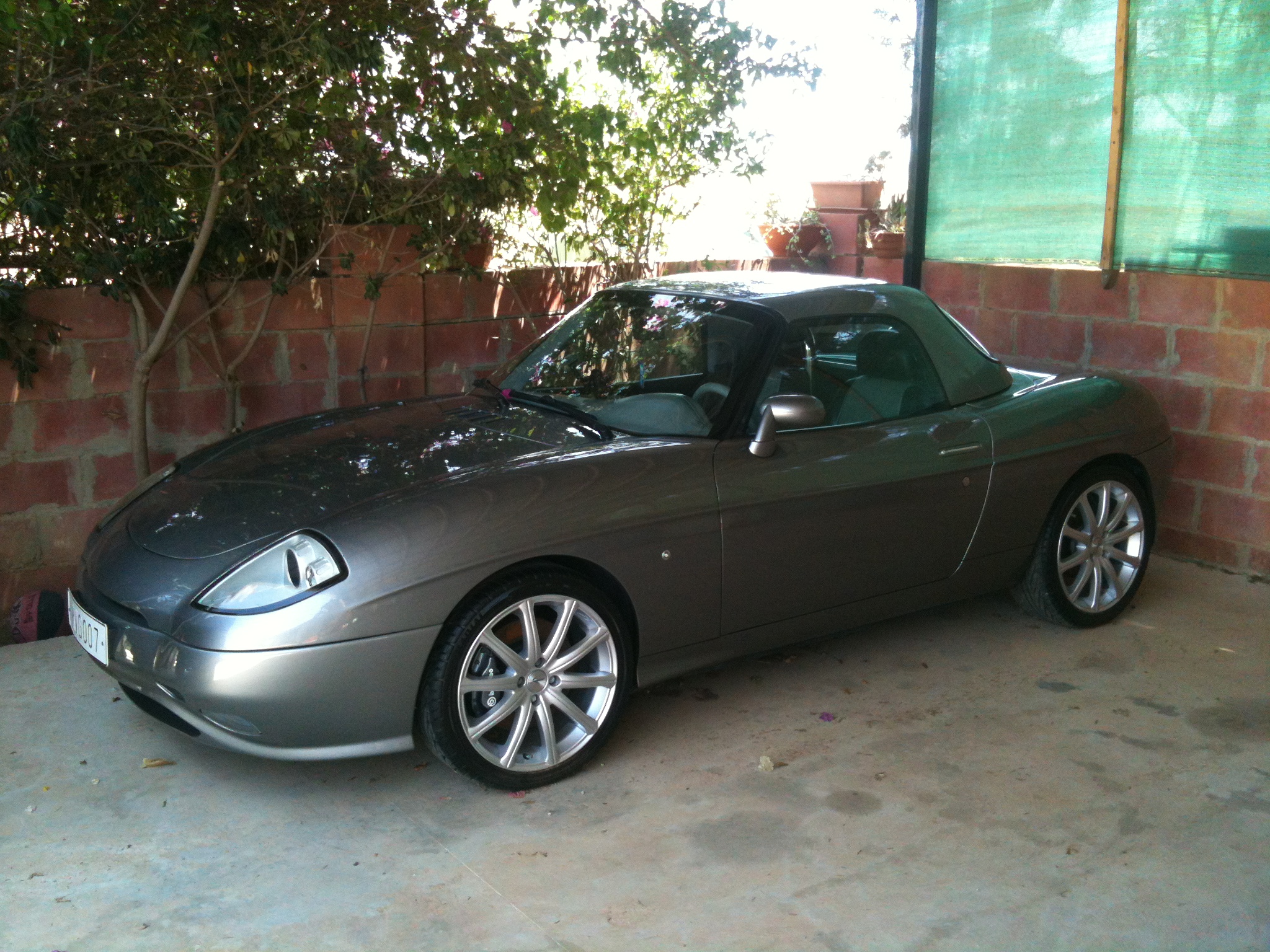

Hiya all,
Been a while since my last post , but finally got my rear glass windstop made.
Here's some pictures of the fitting.
Its a tempered/toughened glass and has the same colored tint as the rest of the car.
Its sealed in with a rubberized sealant and looks very OMP.. :D

Hiya Frank,
The windstop works fine with no blow out issues, The rubber sealant used is the type they use to seal windscreens in so should not have any problems, of course I haven't had the B up to speeds of any excess. :D
Although on testing my prototype with wood and tape there was no real pressure on the stop and it held in place.
May I ask! have you the speaker box too? My glass sits on top of the box and so seals the back out. on my test tryouts with just the stop between the bars, wind will push down and chill your arm. and also try to get max height as you can. I still get a little breeze blowing over but definitely a vast improvement than without.
Hope this helps, (y)

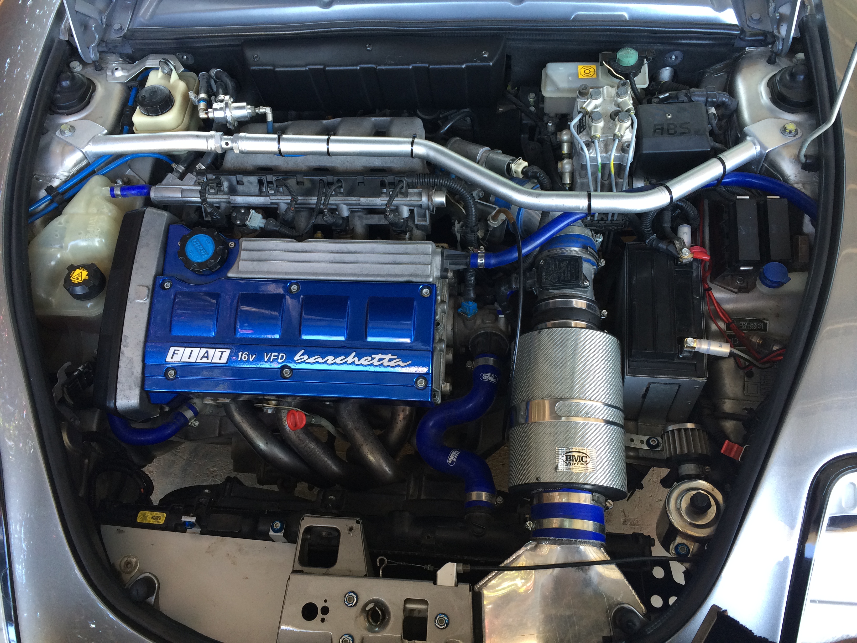

OK! After a long hibernation the B is up and running again :D
Here's some pics of her along with engine bay with its new battery and connections. I,m hoping I will make some time to fit my new intake and get her on the RR for testing. Its been such a long time but now are the best months for driving roof down in Cyprus, the weather has cooled of slightly and in the evening its perfect. :D
Thinking of fitting a power/battery isolator switch too, should keep the battery from draining.

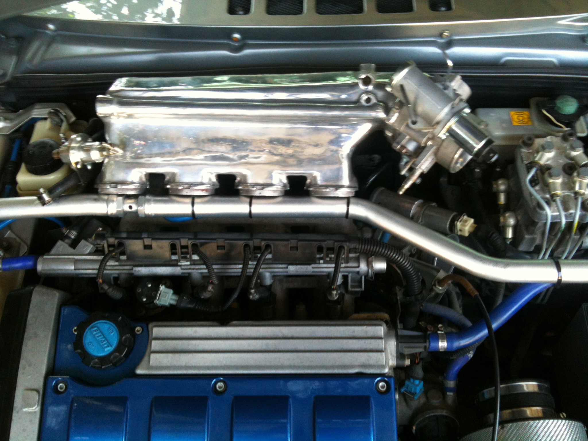

Hiya, Thought id give the B a Xmas upgrade present and been toying with fitting my new intake , Dave (Mr Fixit) made for me.
Have a few issues but nearly there.
I have had to modify the position of the idle control valve and made to new connections to extend its position elsewhere.
I will mount it beside the air filter where you see the new hoses.
I haven't started the vehicle as I need a small plug for the vacuum/breather system on the new intake which will arrive after xmas now but will let you guys know once its up and running again.

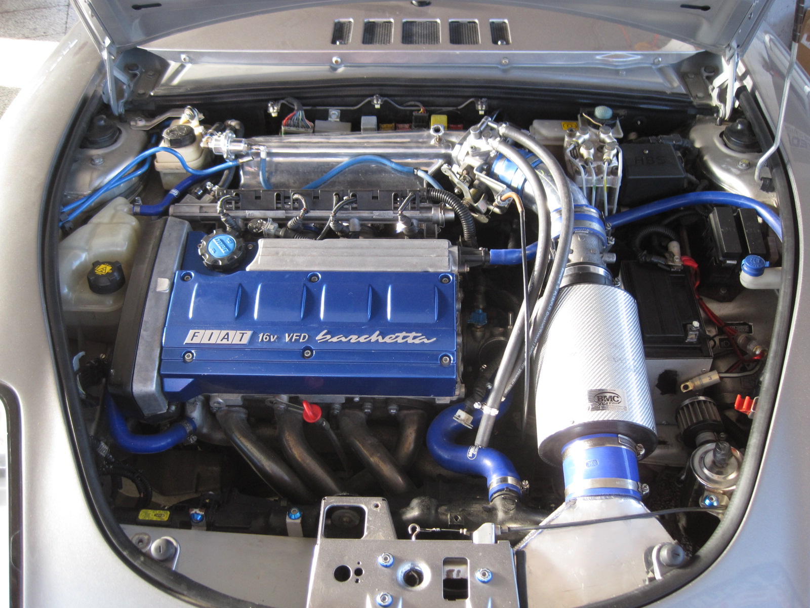

Hiya all, HAPPY NEW YEAR!
I have managed to get the B back together and running with the new intake.
There were a few issues like having to
1. Modify the position of the idle control valve.
2. Change the hoses that connect the new intake with the old.
3. Make a new bracket to hold at the rear.
4. Change injector seals and vacuum seal.
5. One new water hose.
6. Make a new bend coupling for the vacuum pipe.
Other than that everything seems fine although I will need to get the B on a Rolling Road to tune it and see what if any gains have been made.
