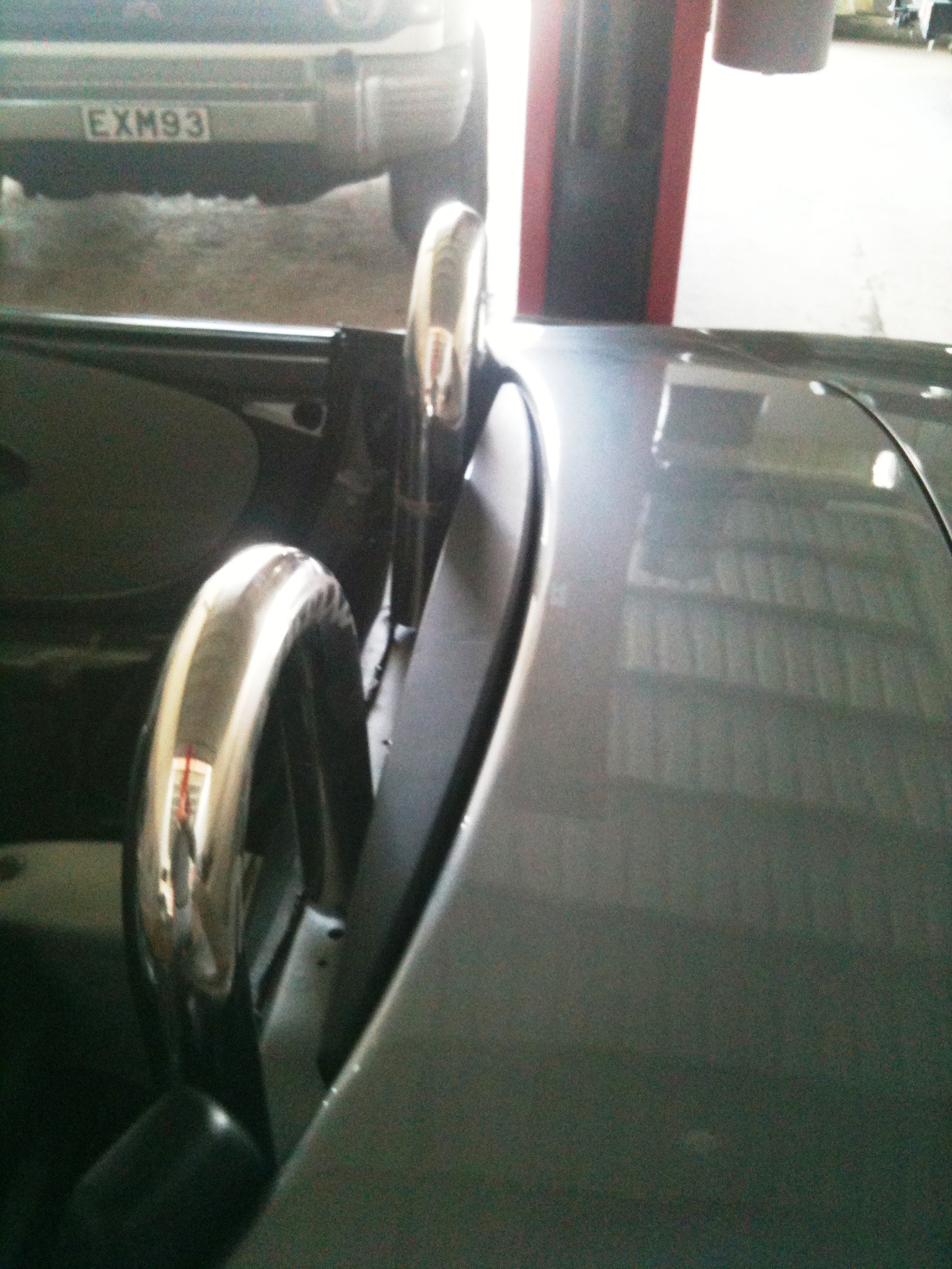

From what I can see in the pictures I think your 'ram air' induction will not work well and will actually reduce power and 'strangle' the engine in 90% of real-world driving situations by actually reducing the amount of air available. Am I missing something?

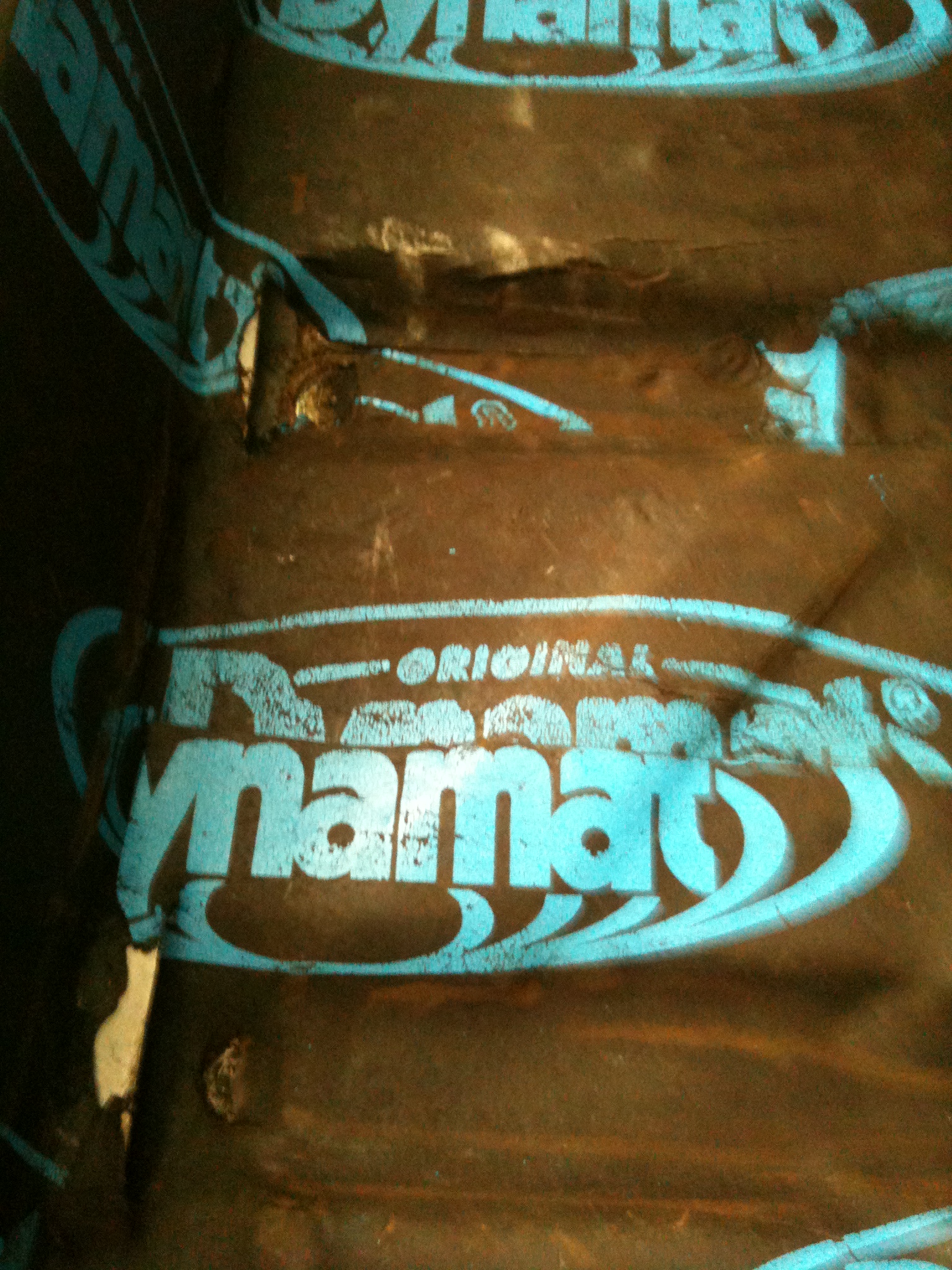

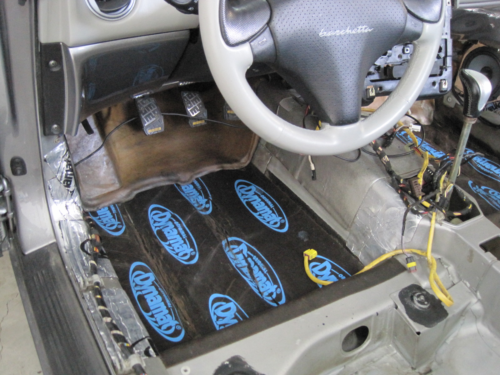

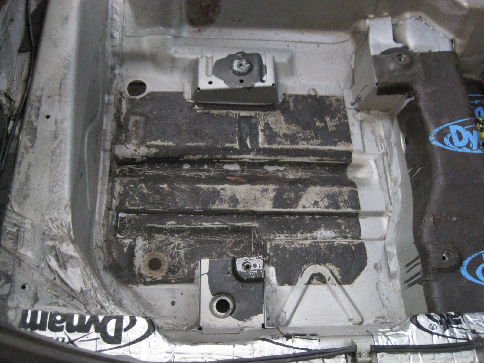

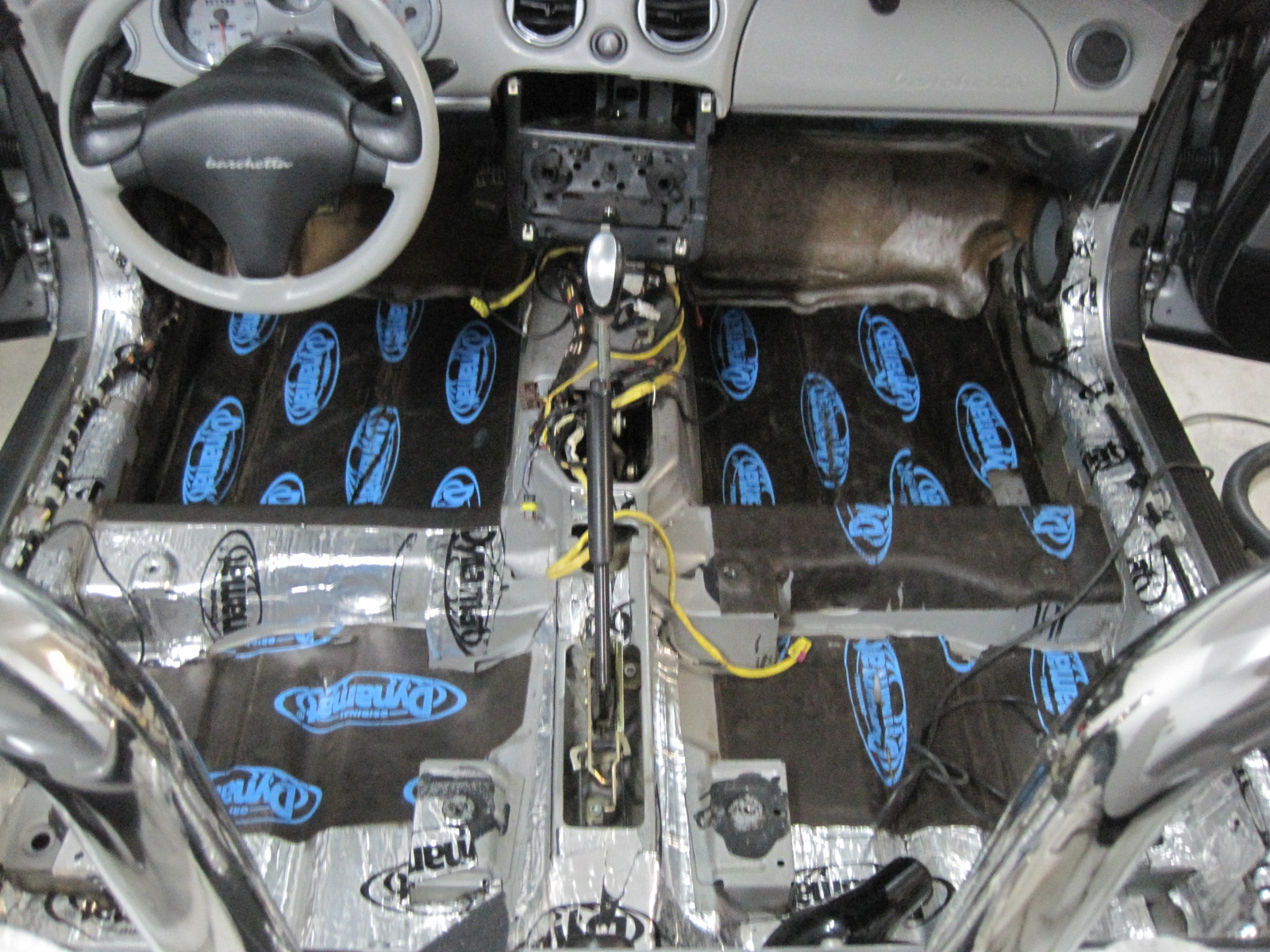

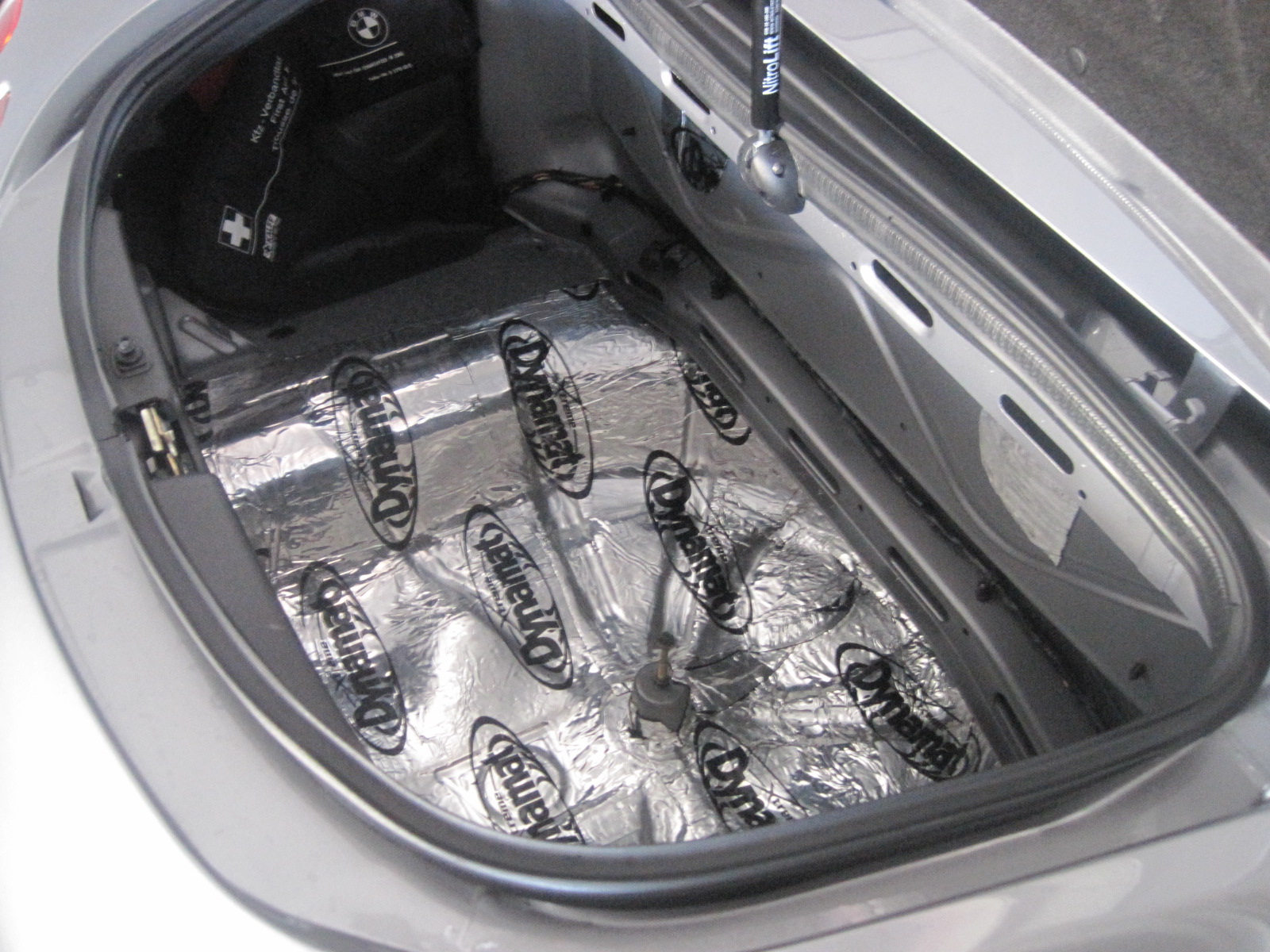

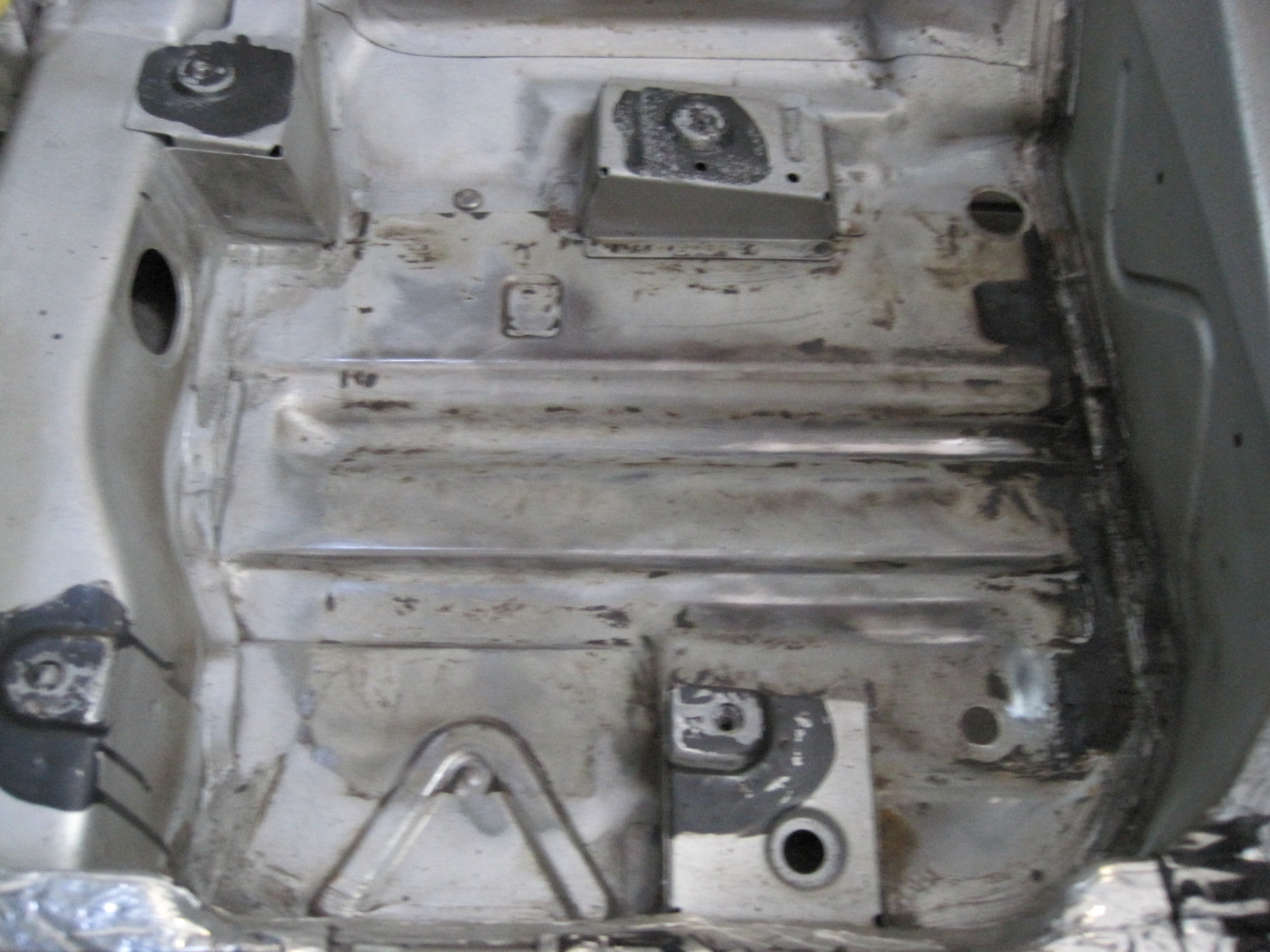

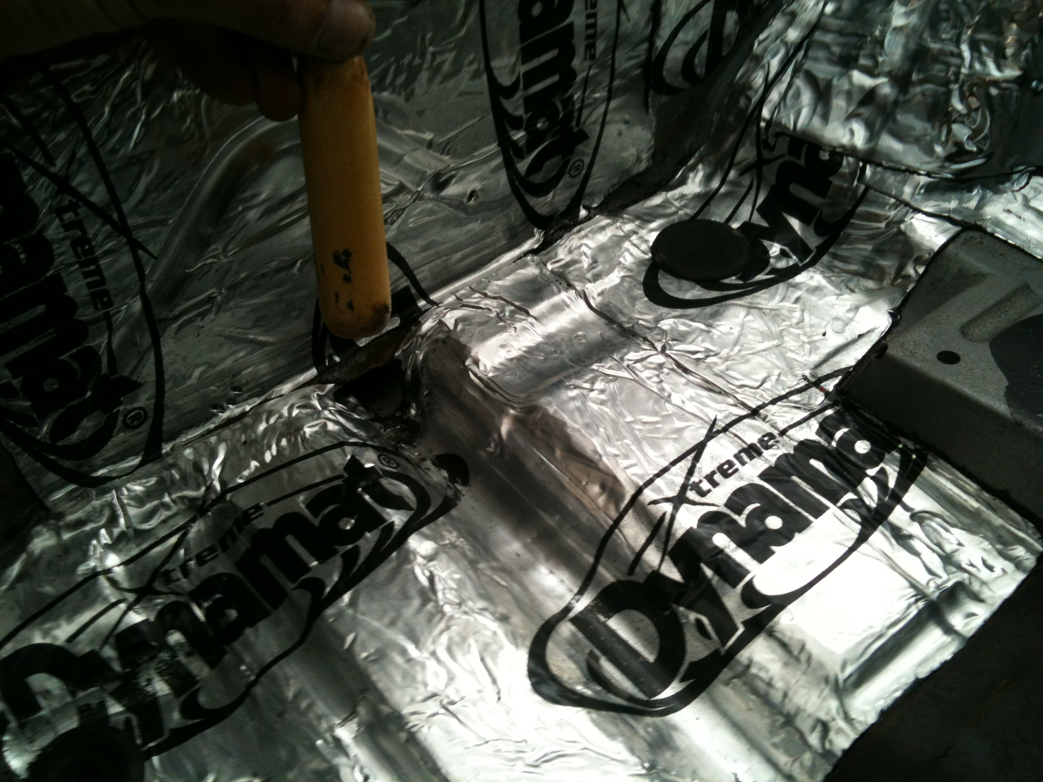

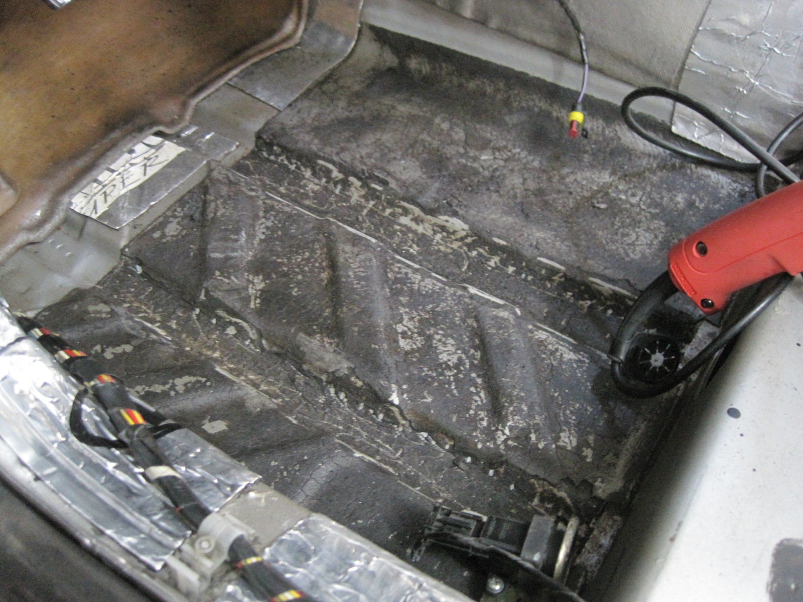

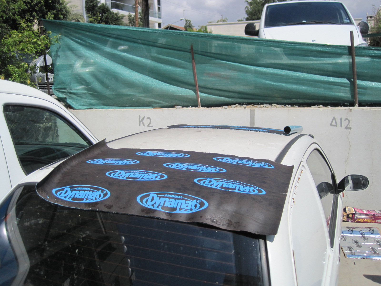

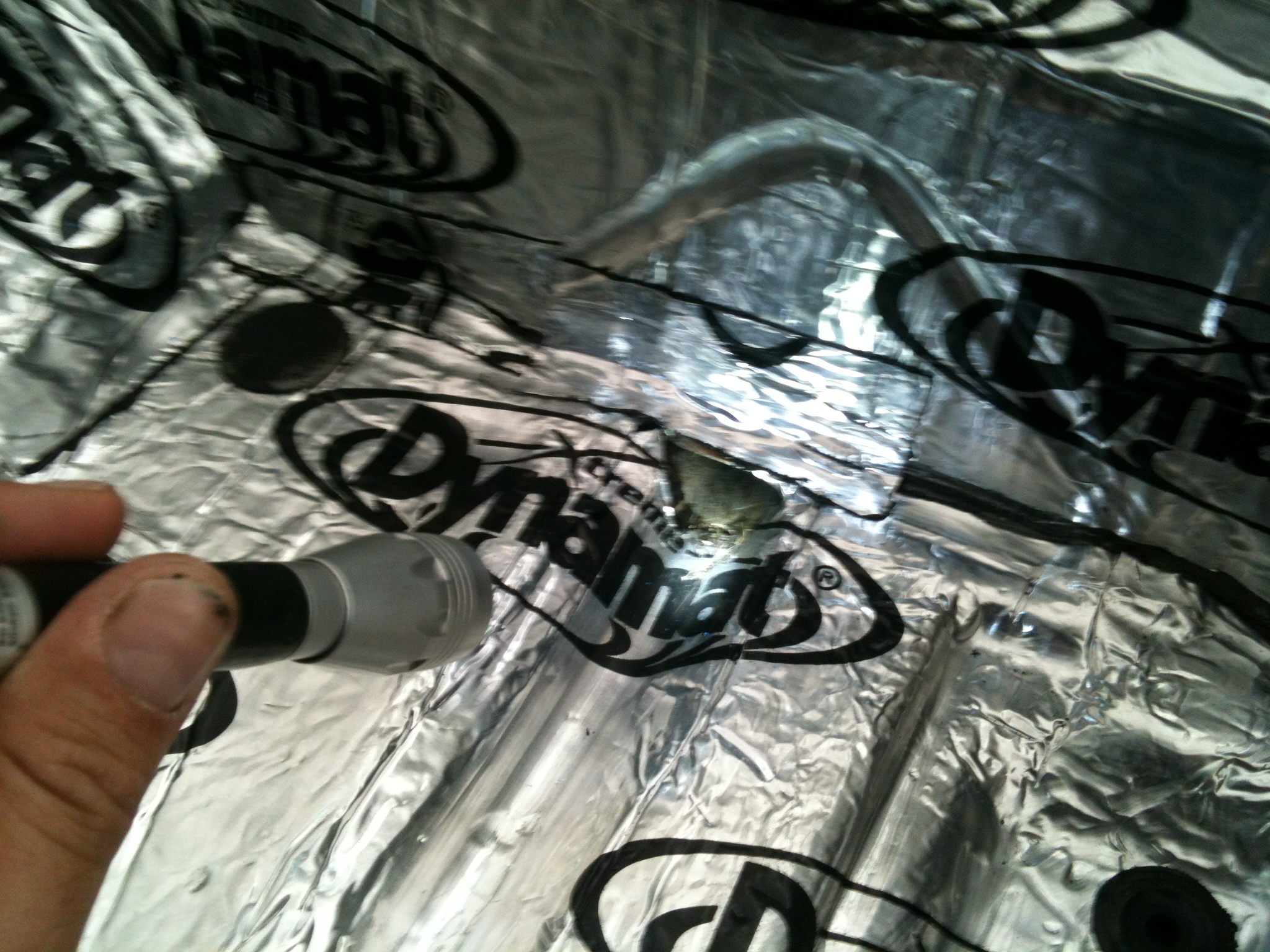

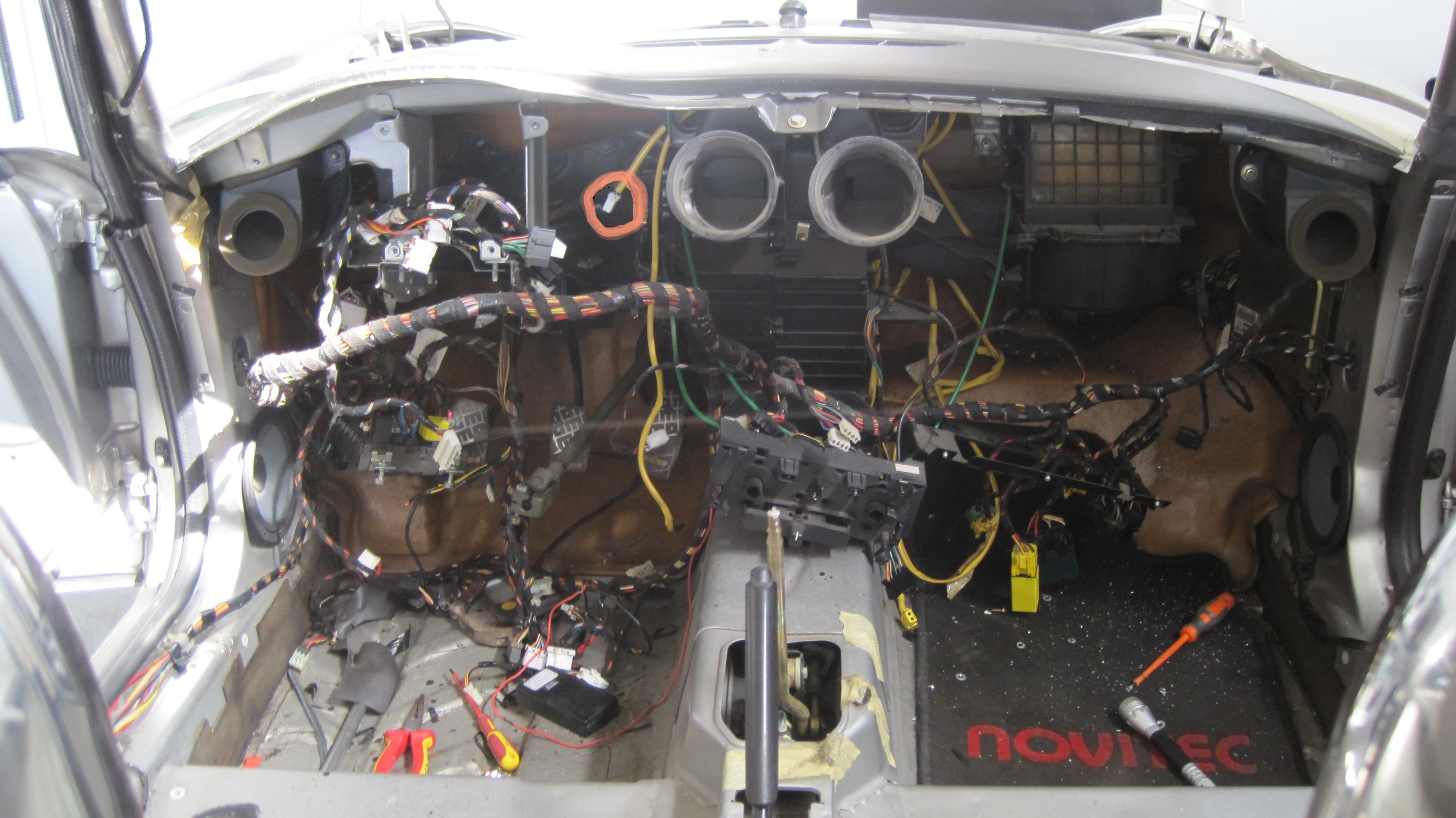

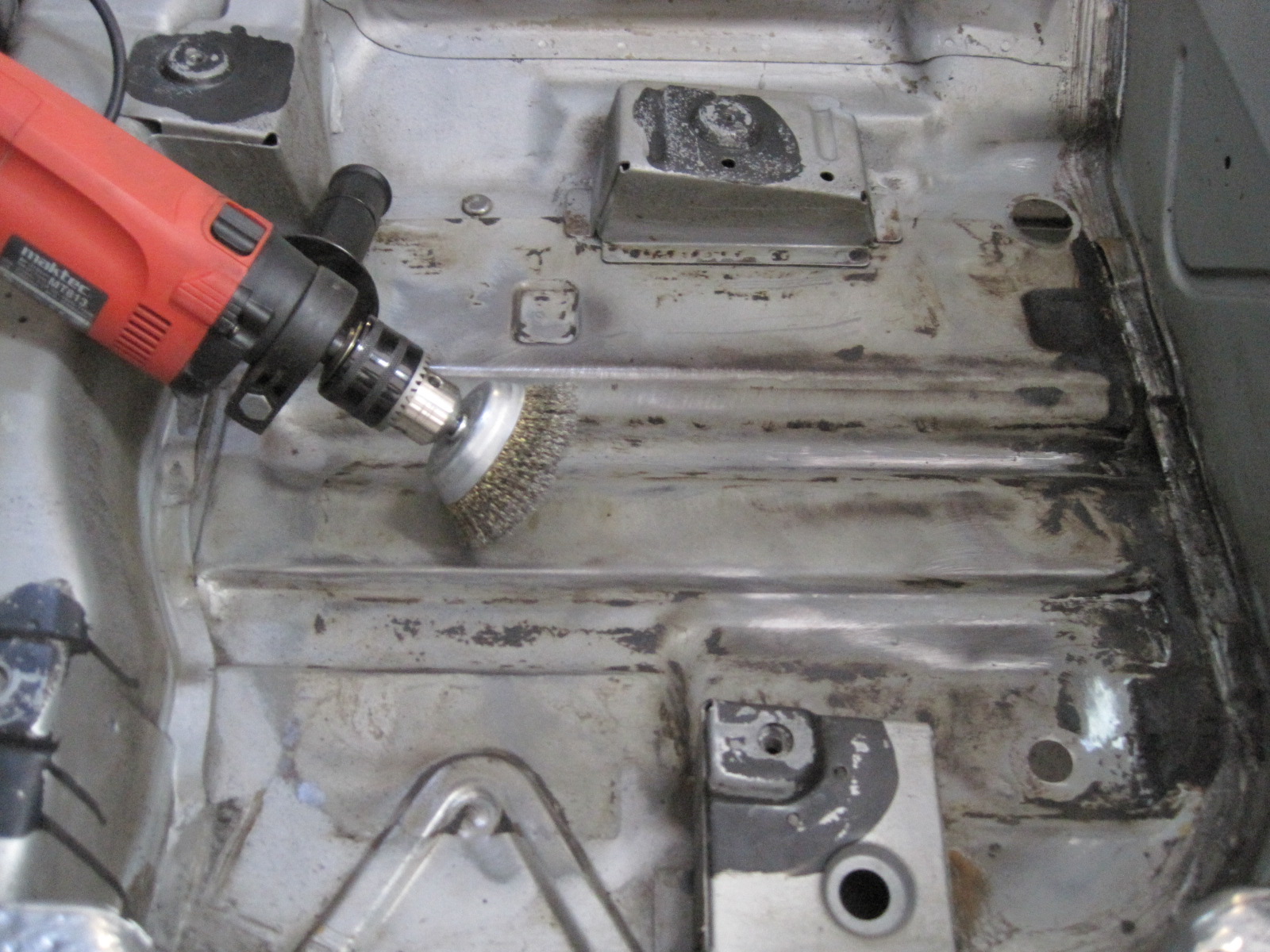

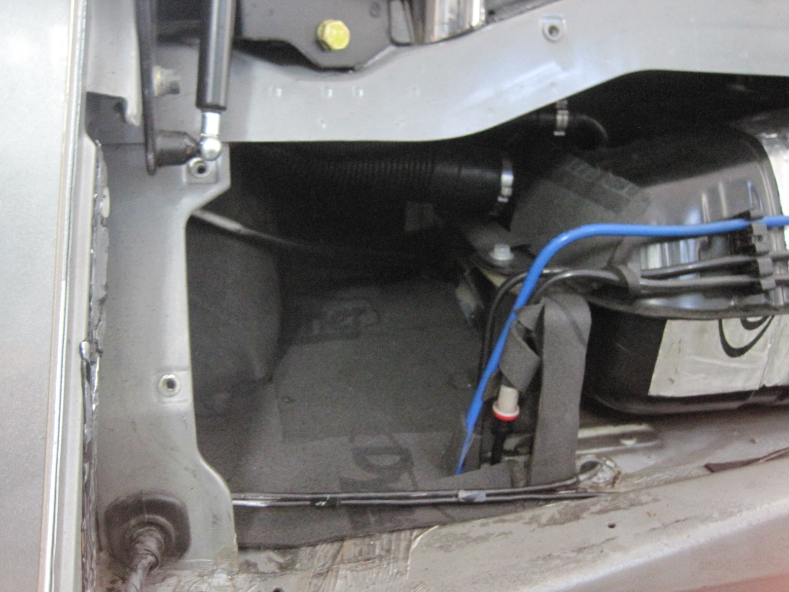

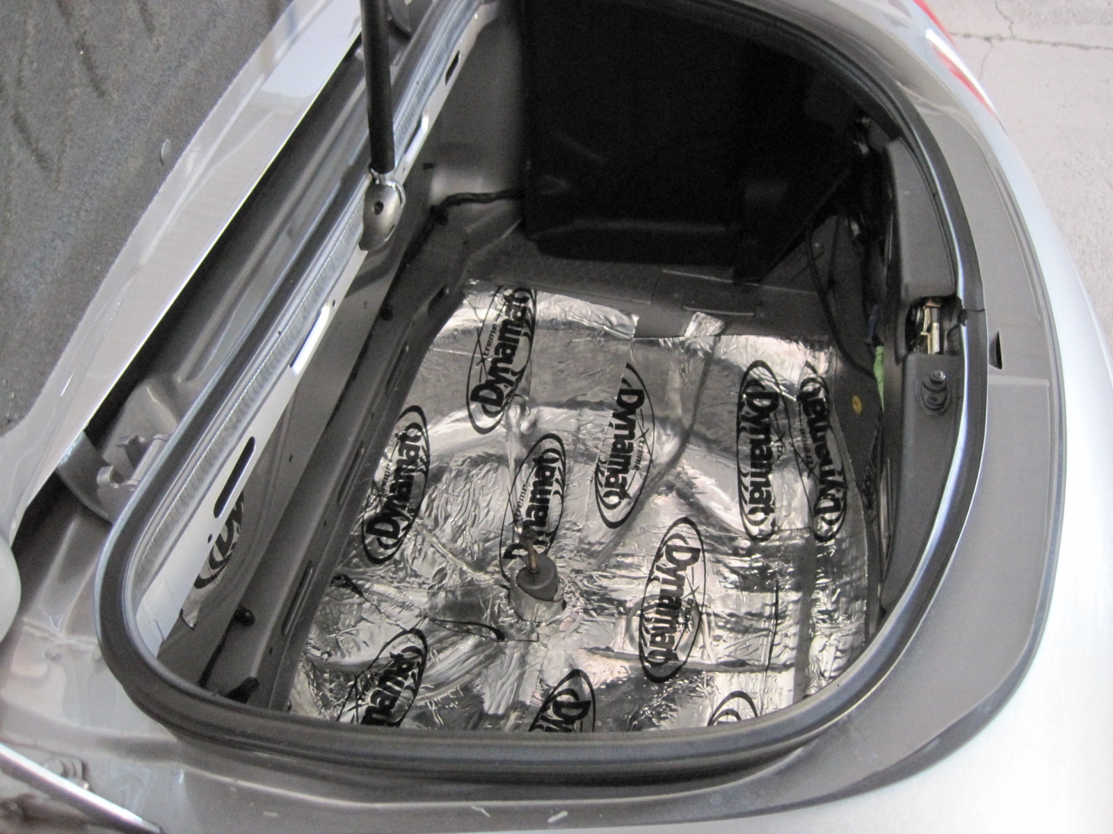

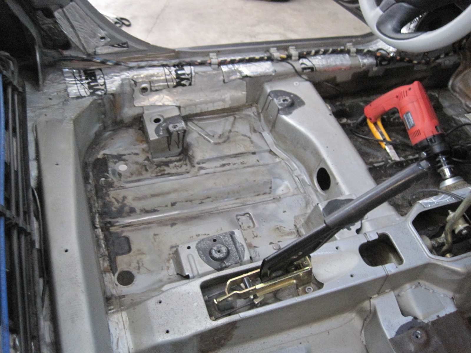

Over the last few days I have been adding some sound proofing to the B's rear boot area and its made such a difference to eliminating road noise and vibrations that I decided to relay the complete floor area.
Its been quite a task, with having to remove all the interior again,
then deciding it would be best to remove the old sound deadening sheets that have aged and not working as best.

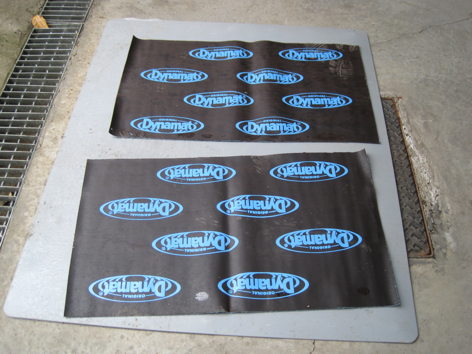

There is a choice of different dynamat materials dependent on which areas are to be covered although all are designed to eliminate sound/vibrations unwanted road and engine noise.
The new Dynamat (ORIGINAL) is a 3/4mm thick tar type material and fantastic sound/vibration absorber and much like the original pads laid although now I have covered the whole area will do a much better job.
I had to clean back the areas back to metal to gain a good bond, and then the new dynamat is laid, The material needs to be heated with a hair dryer to allow it to soften and mold to the floors shape and then it sticks and gradually hardens to it .
The dynamat (EXTREME) is much easier to lay as its a soft pliable sticky material that can mould around the cars curves and shape. You just cut roughly the shape required, remove the backing and stick it down using a small rubber roller or any other soft backed tool.
This helps to eliminate any air bubbles and create a good bond.
The Dynaliner is a grey/ sticky foam material which is used in area's like the bonnet/ boot and speaker enclosures. Its helps with heat soak and reduces noise/vibrations. I have used this on my bonnet and the rear boot and also laid this in the area where the space is by the fuel tank, in preparation for a subwoofer.
Here's some pictures of the progress so far.

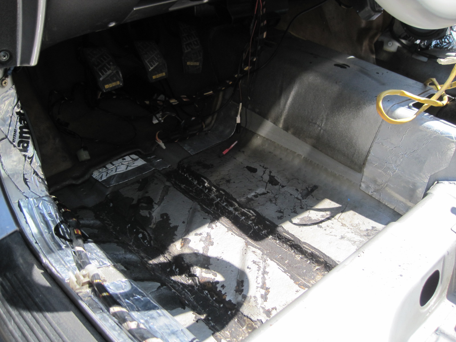

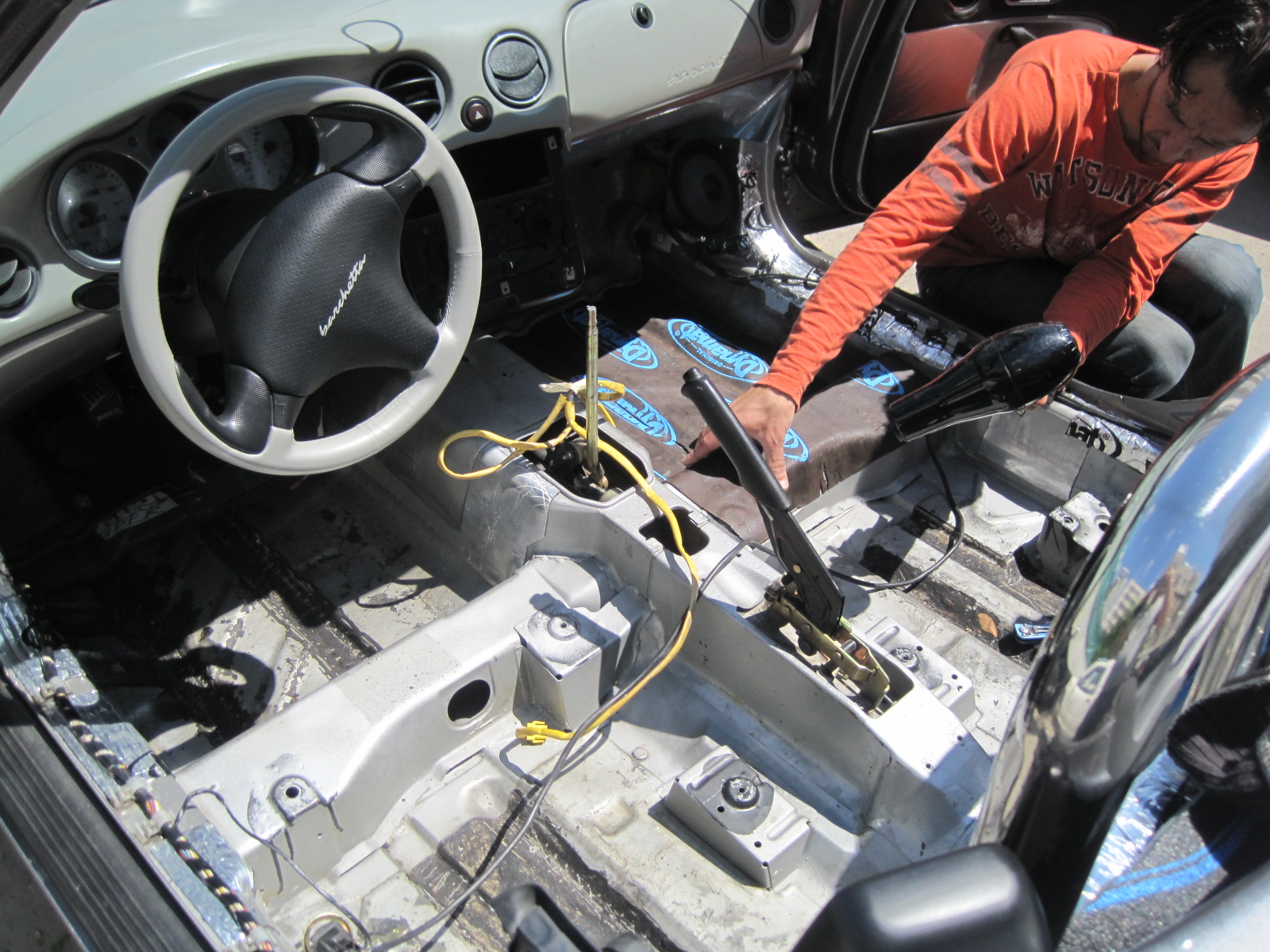

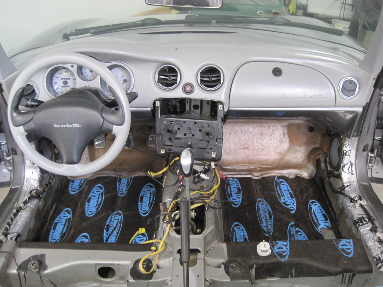

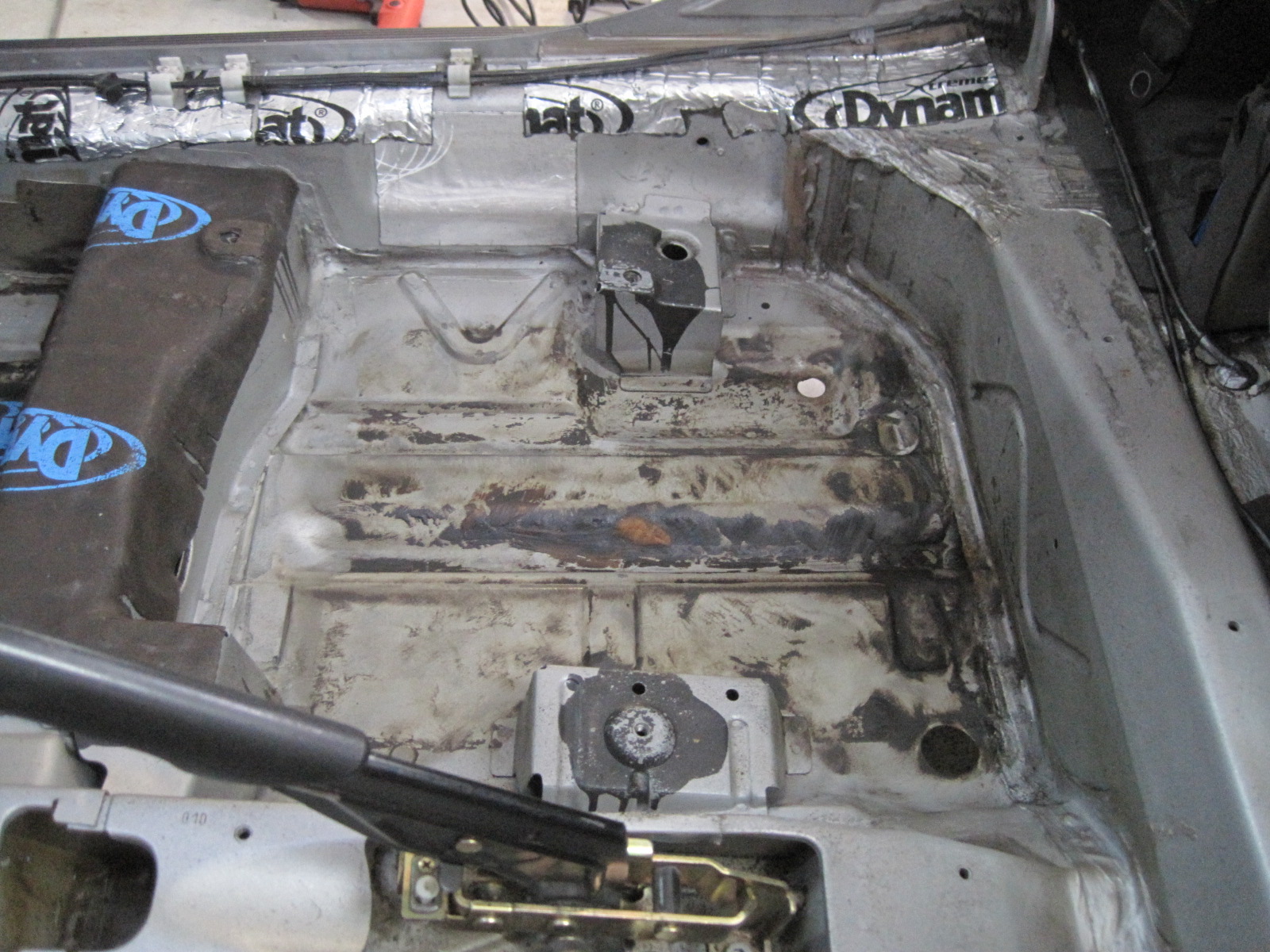

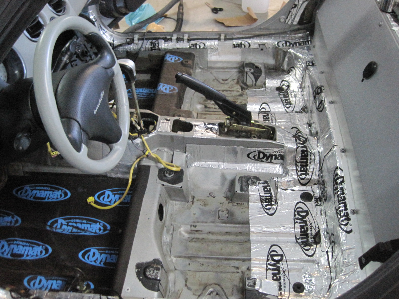

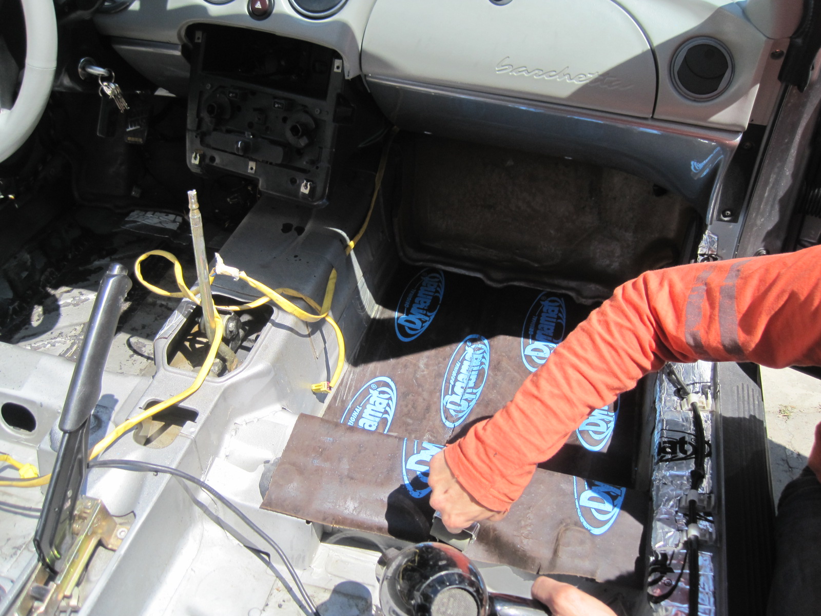

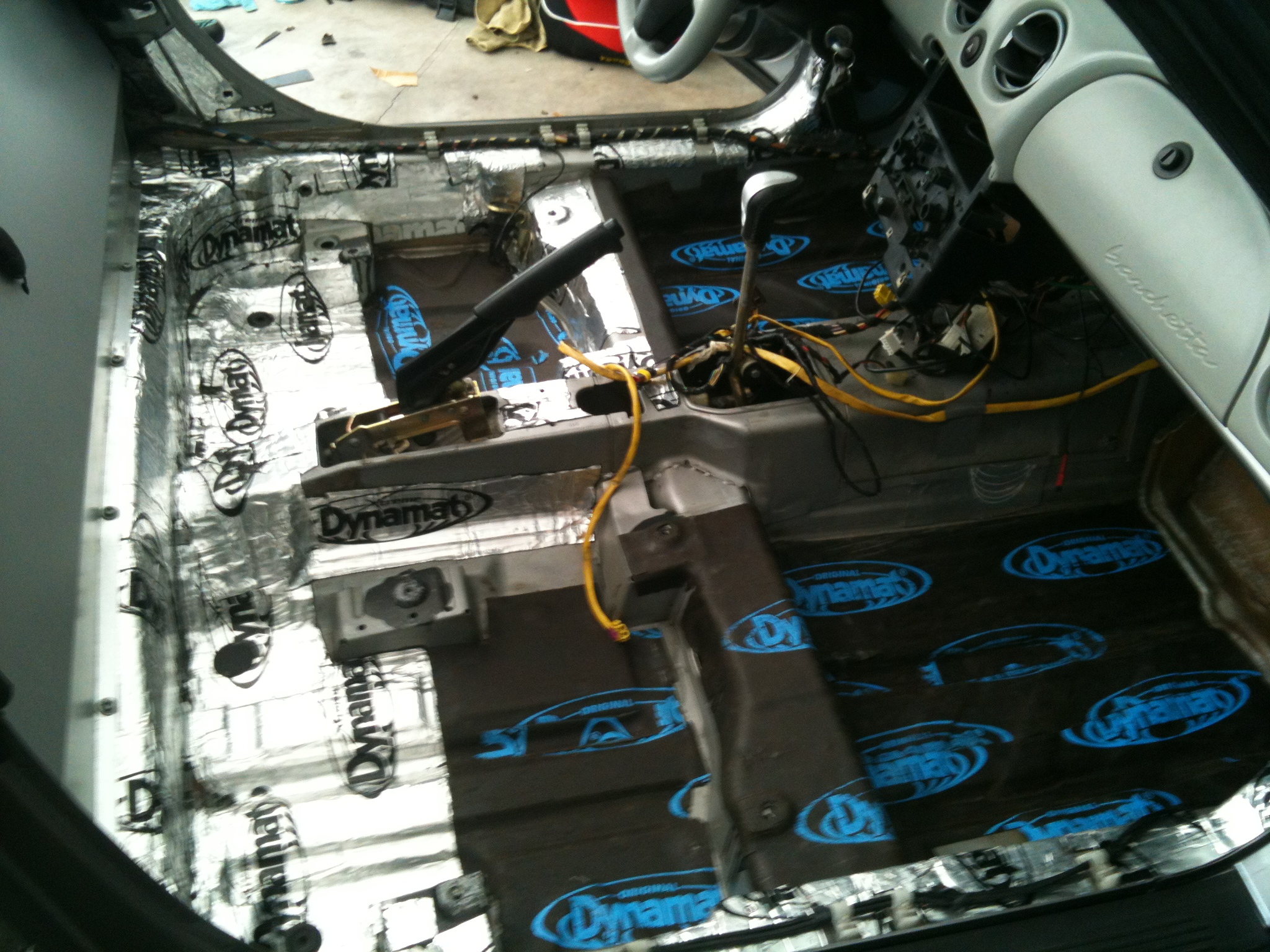

Some more progress and pictures.
After speaking and receiving help with a friend who does sound installations. He told me leaving the Dynamat original out in the sun helps it to soften and become sticky and then easier to lay.
So now covered the entire floor area and sides and also installed the extreme in any small cavities of the rear wings and wheel arches, now tapping on these areas all around the vehicle feels so dense and more like solid wood than a tinny metal sound. :D

Put the B back together today and WOW! what a difference. :D
The ride feels so more solid and quiet. Even over rough terrain any previous noises/vibrations have vanished, even my fuel pump winning has gone.
The front stereo sound has improved further and now looking forward to fitting my new custom built system with rear speakers and subwoofer.
Pictures to follow as and when I do the work.. (y)

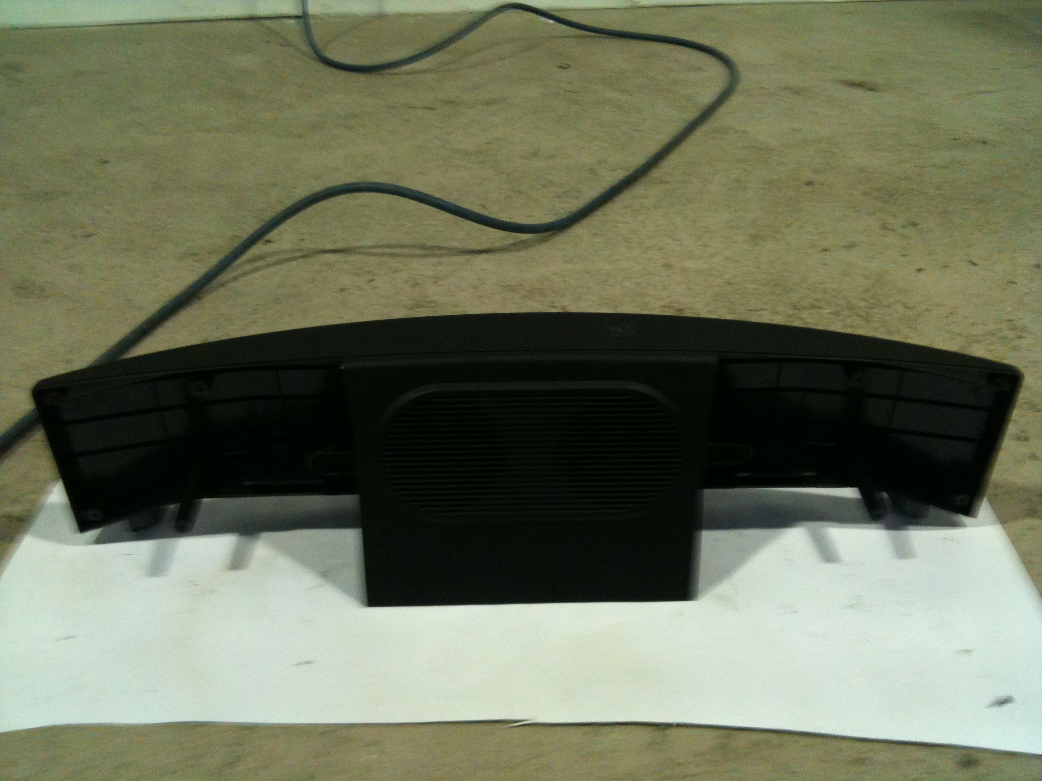

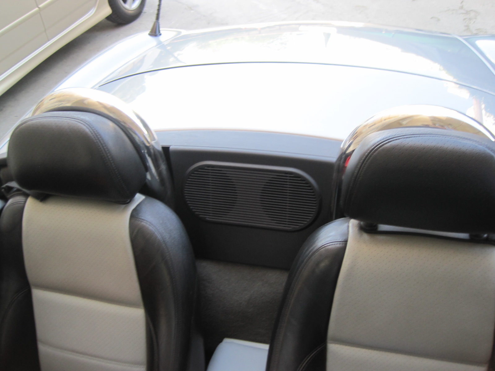

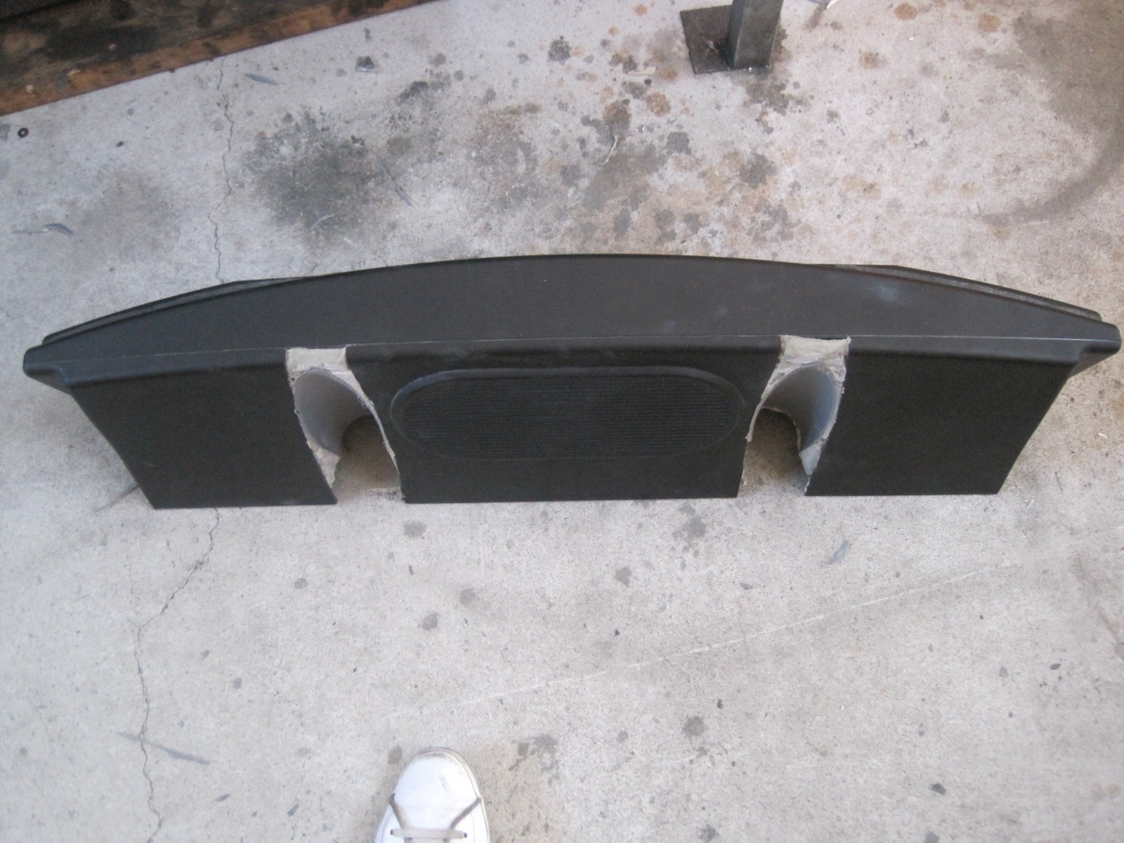

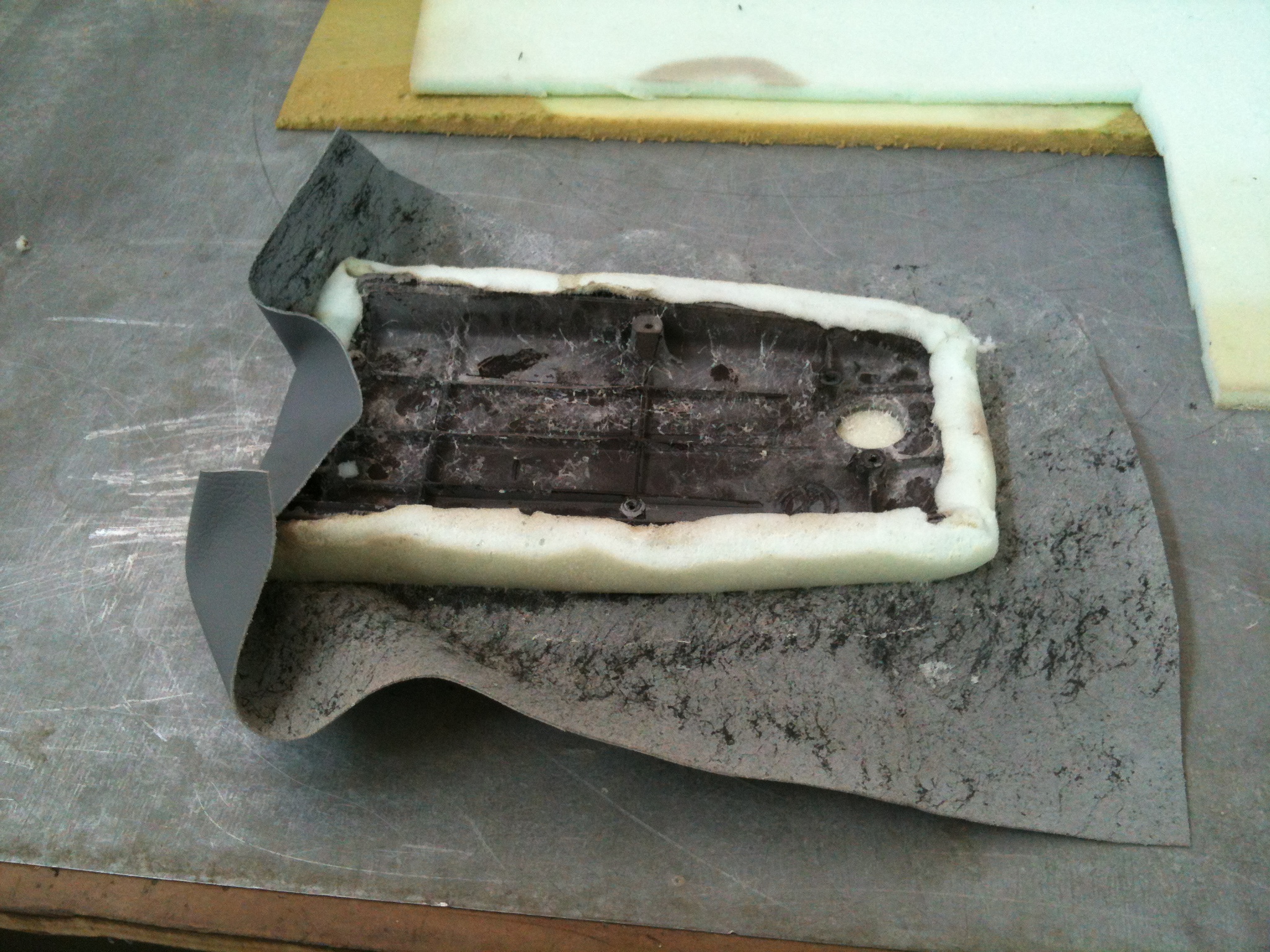

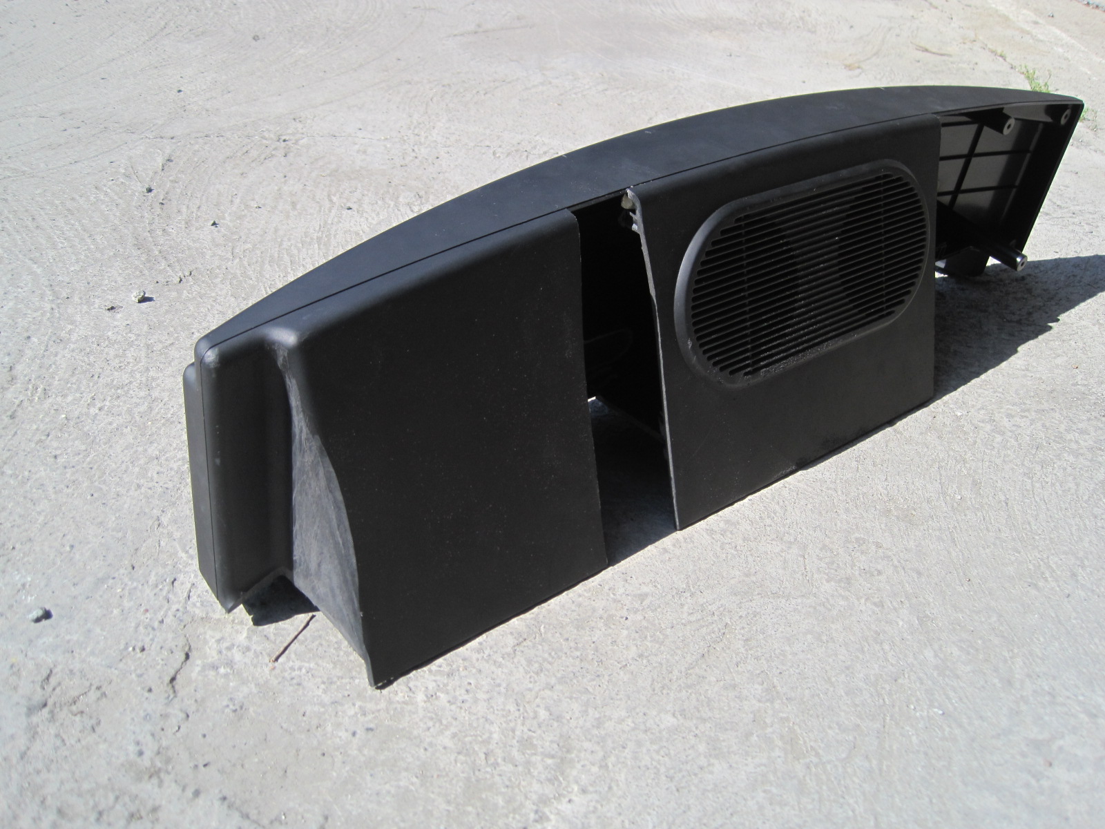

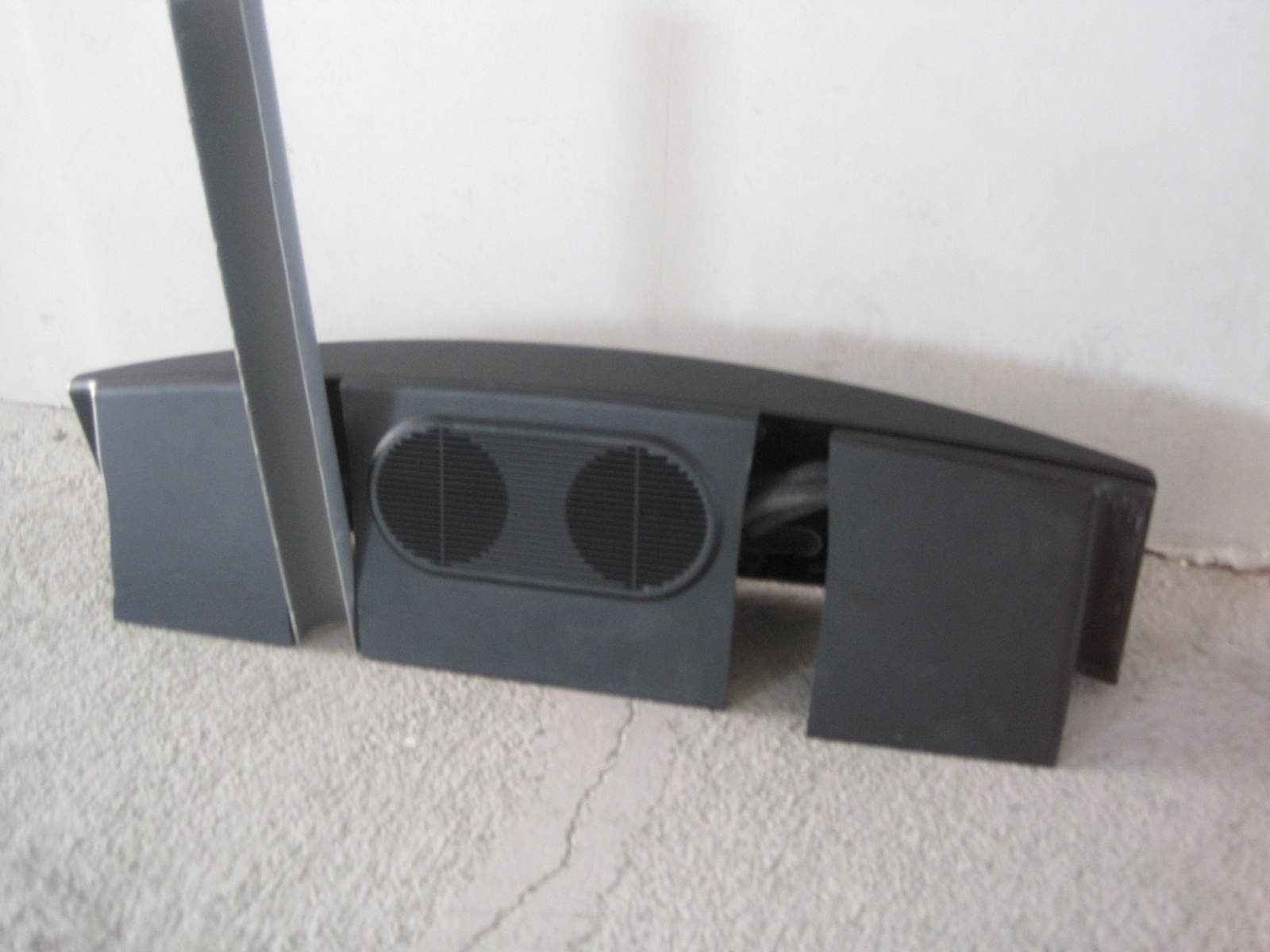

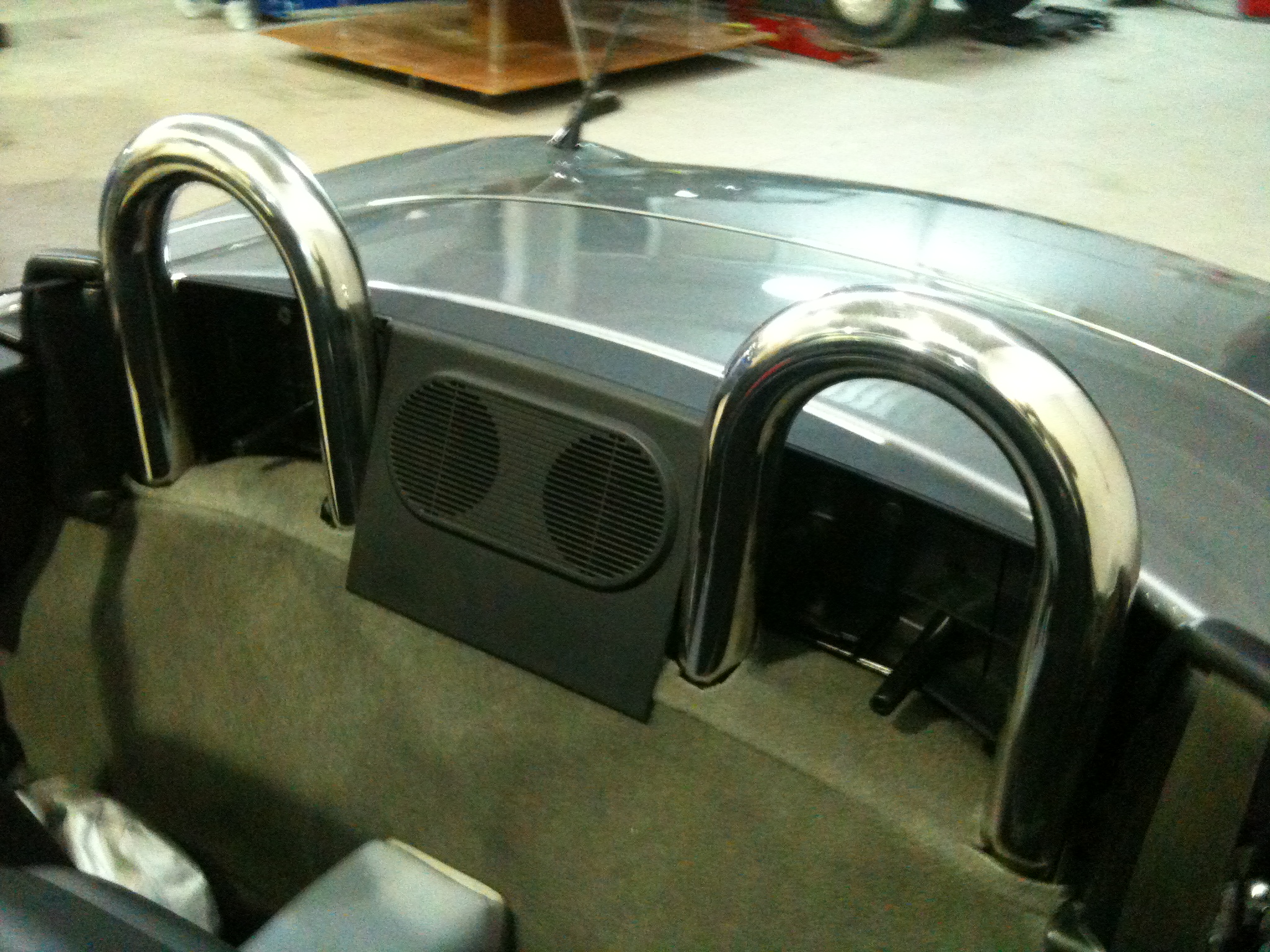

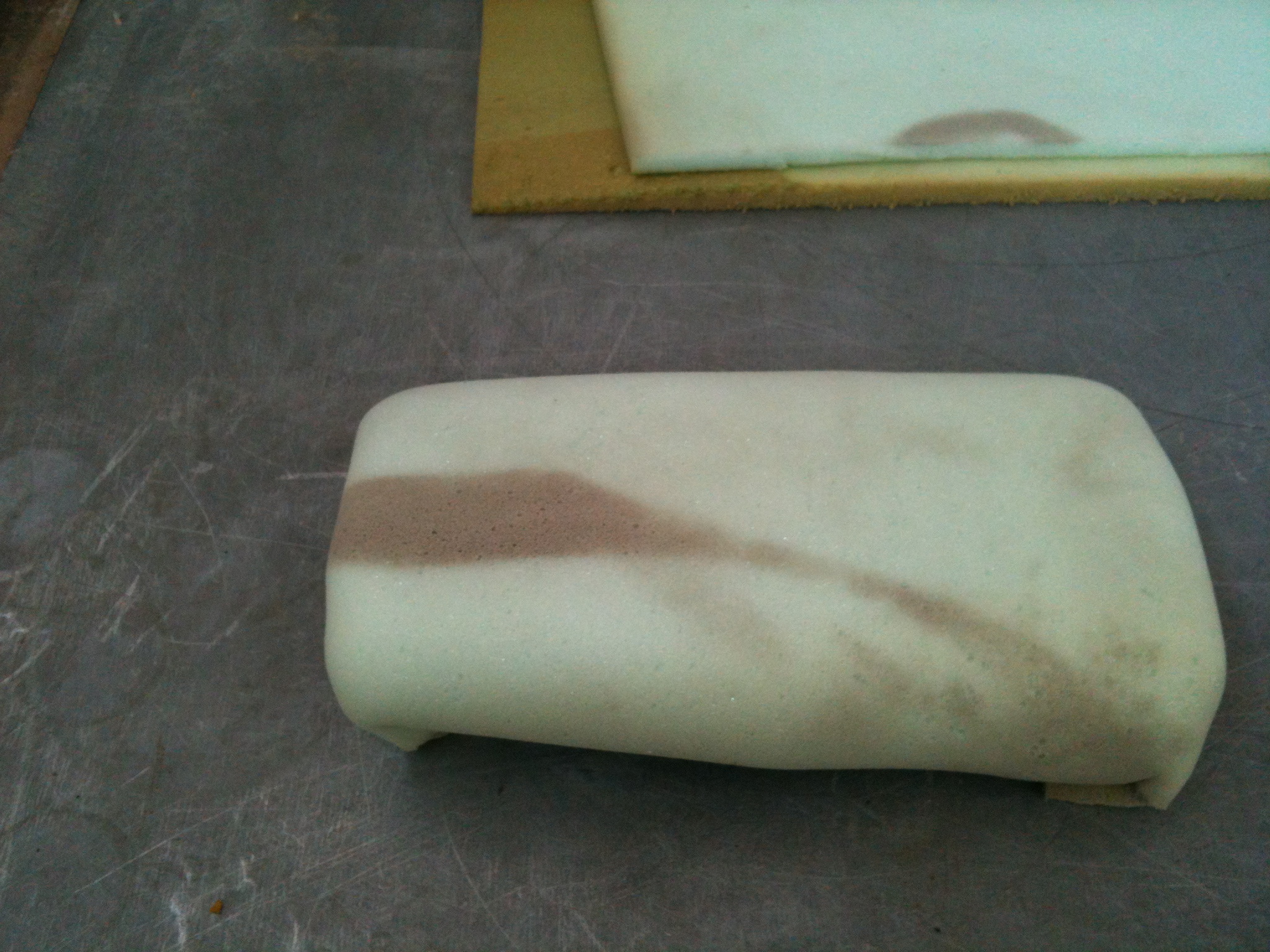

I've started working on the rear sound, and decided to cut into the original subwoofer, it still a working prototype but hear is progress so far.
And also had an idea to pad the armrest to make it more comfortable to lean on and dress it with leather.

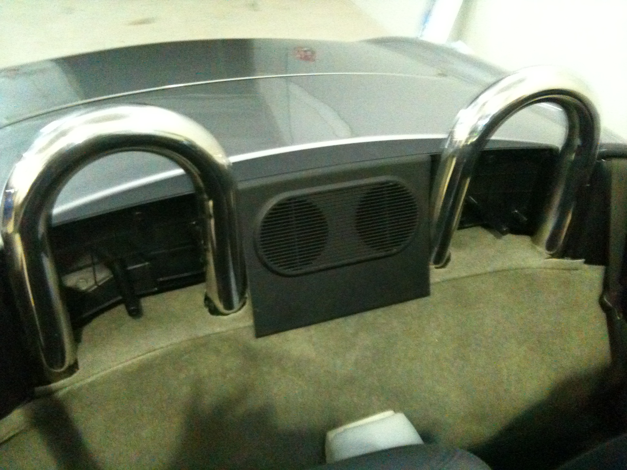

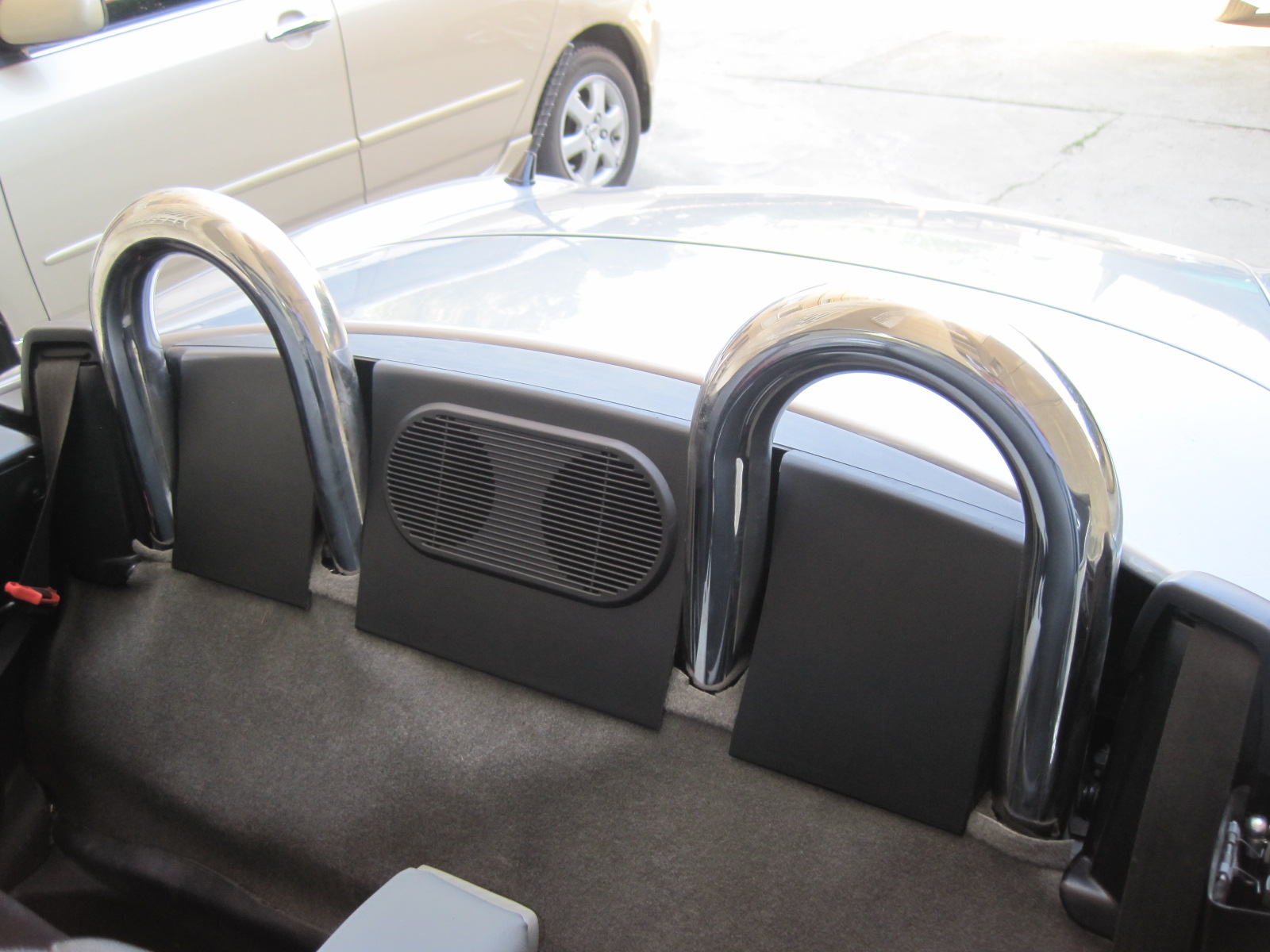

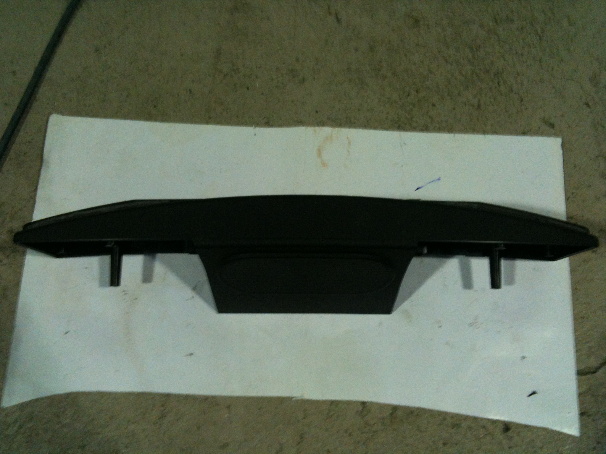

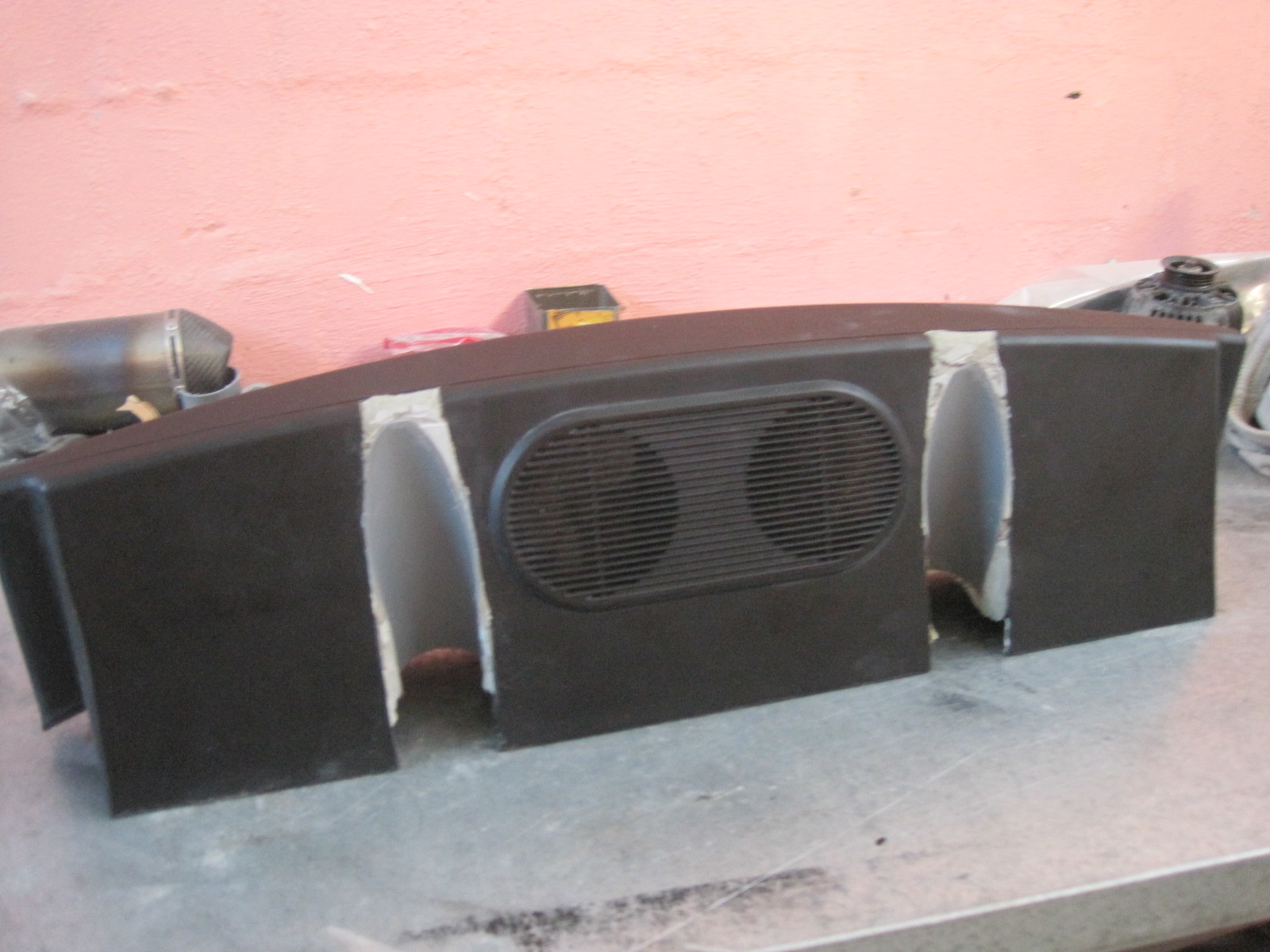

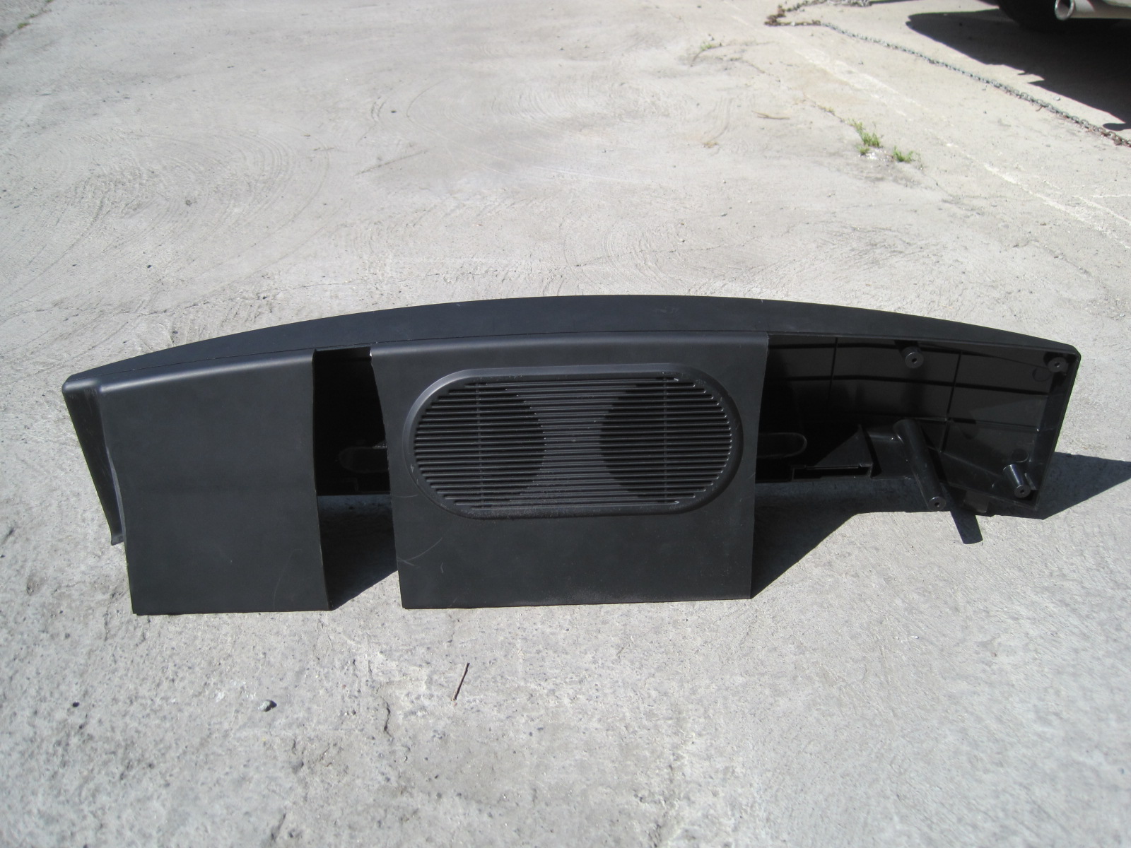

Some more progress to the rear speaker system.
I've just managed to squeeze the subbox in between the rollbars by just cutting into the front section where the bars lye and I will tidy the whole thing up and seal the open ends with fibreglass.
When finished should look like the original manufactured part. :D

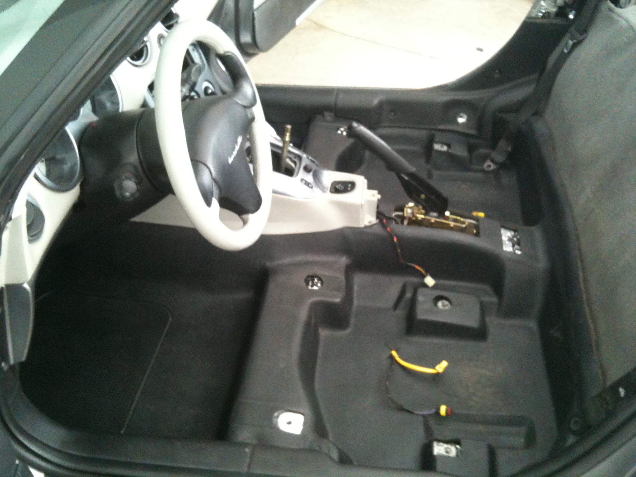

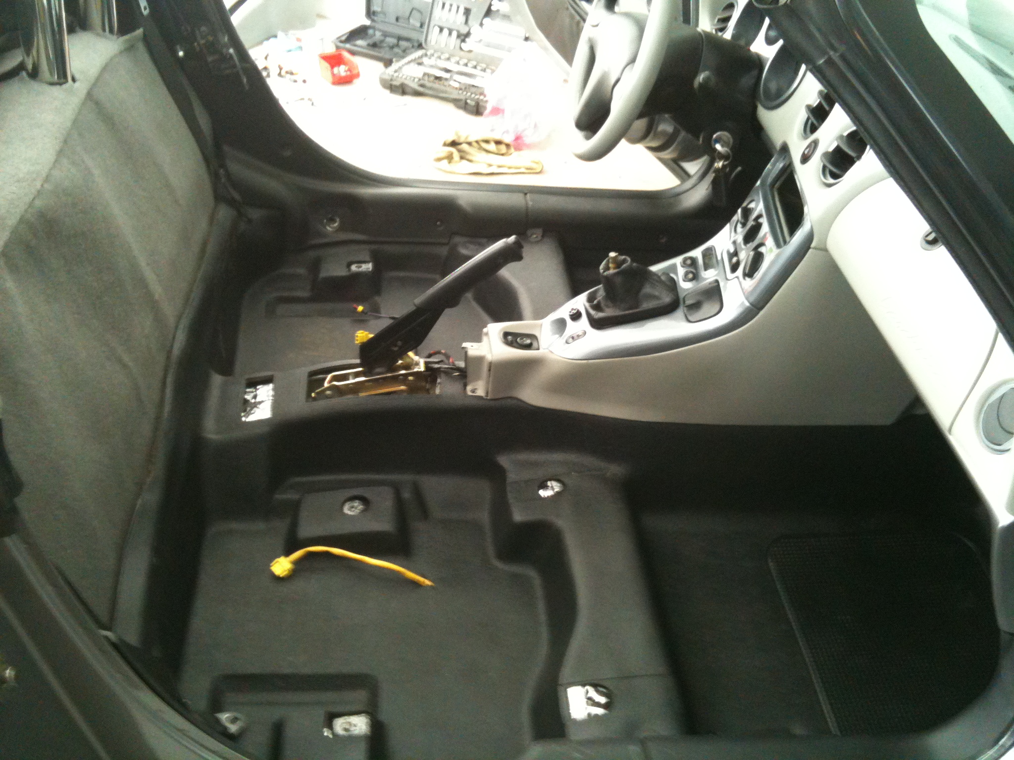

I have just one question, where does the yellow wire plug into up by the dash, its still the only wire I have not been able to detect. I had another look the other day and still could not find it.
Its for the airbags and must be the other end of the wires that come from under the seats.
If i'm not mistaken on the left side of the cabin you have 2 wires from airbag (yellow)
-one for the airbag (on top of steering stalk)
-one on the floor pan for the left seat.
Other ones are passenger airbag (if you don't have one it has a resistor on it)
passenger seat
airbag cable to connect with a computer
they all should go to the airbag ecu
And there should be one that is connected to the wiring harness to show up the airbag light in your speedo.
I think it is that one, but don't know exacly where it goes out of the blue
edit: if you have a late model with passenger airbag one is going to the glove box in between te seats (to disarm the passenger airbag)

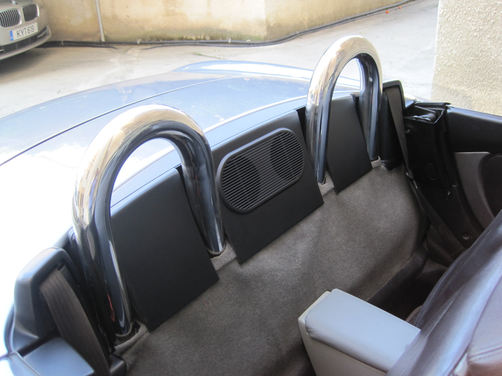

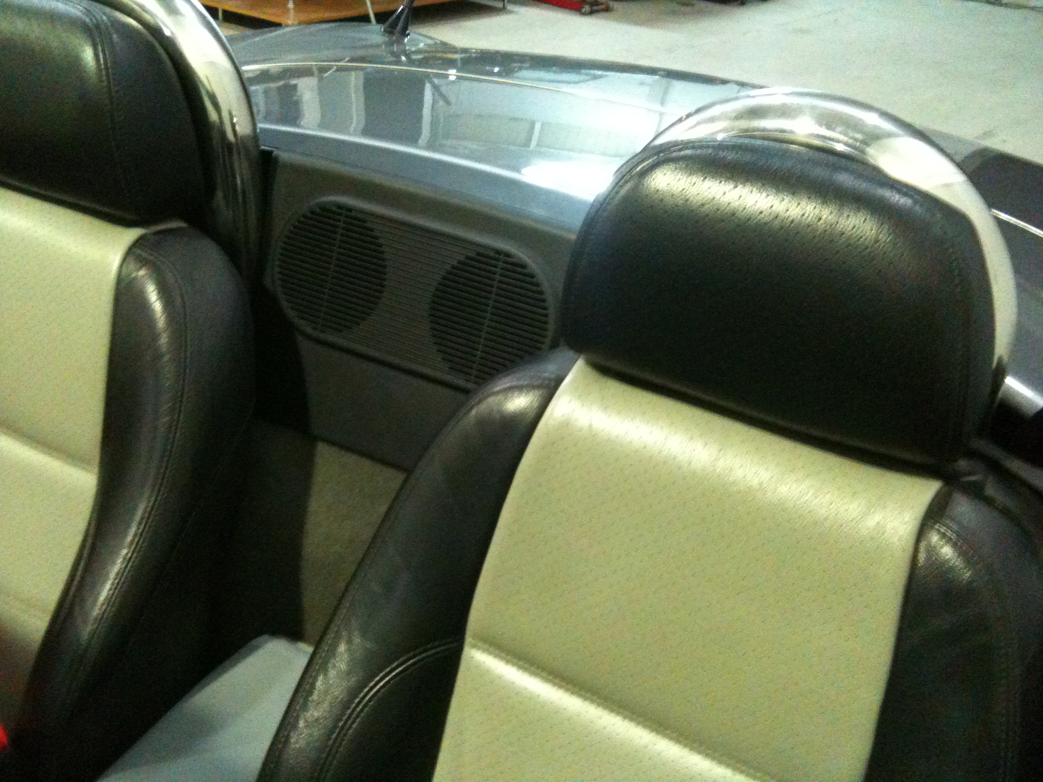

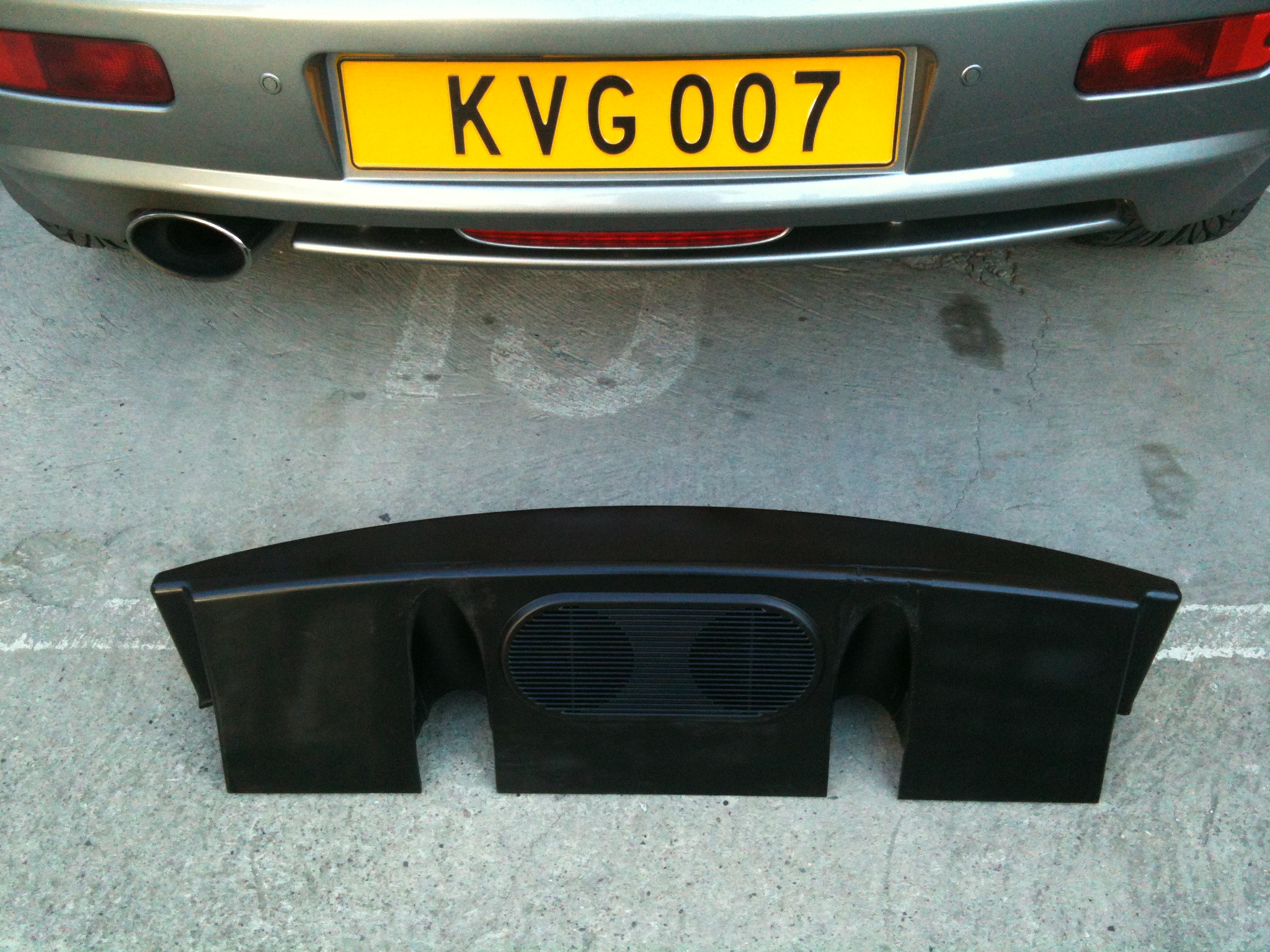

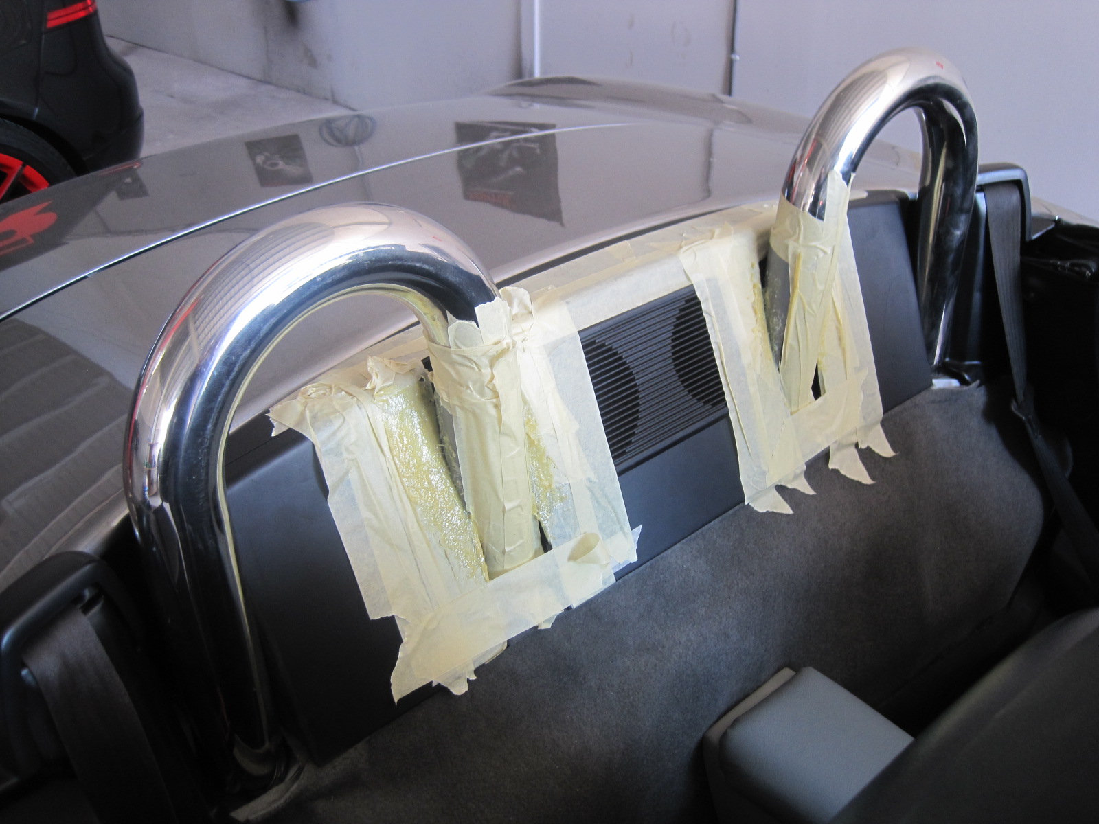

Some more progress with the roll bar speaker box.:)
I found some matching pipe to create some channels around the bars which were then cut to size.
I then glued them in place with the box in fitted so as to get the correct shape.
Once set I removed the box and went to work on filling the gaps with fiberglass resin, this will give more structural strength and give the unit the new roll bar fit look.
The final touch will to be spray a plastic coat primer and then some black spray for the finished project. :D
