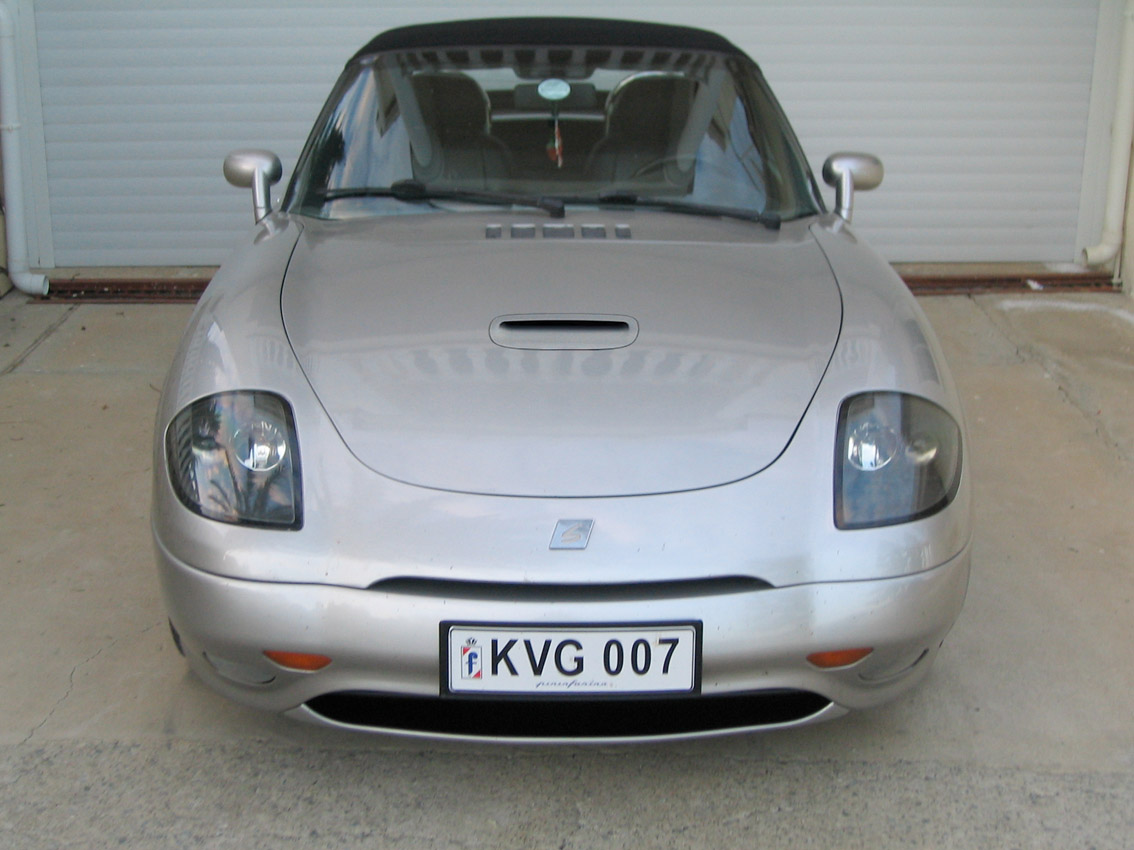

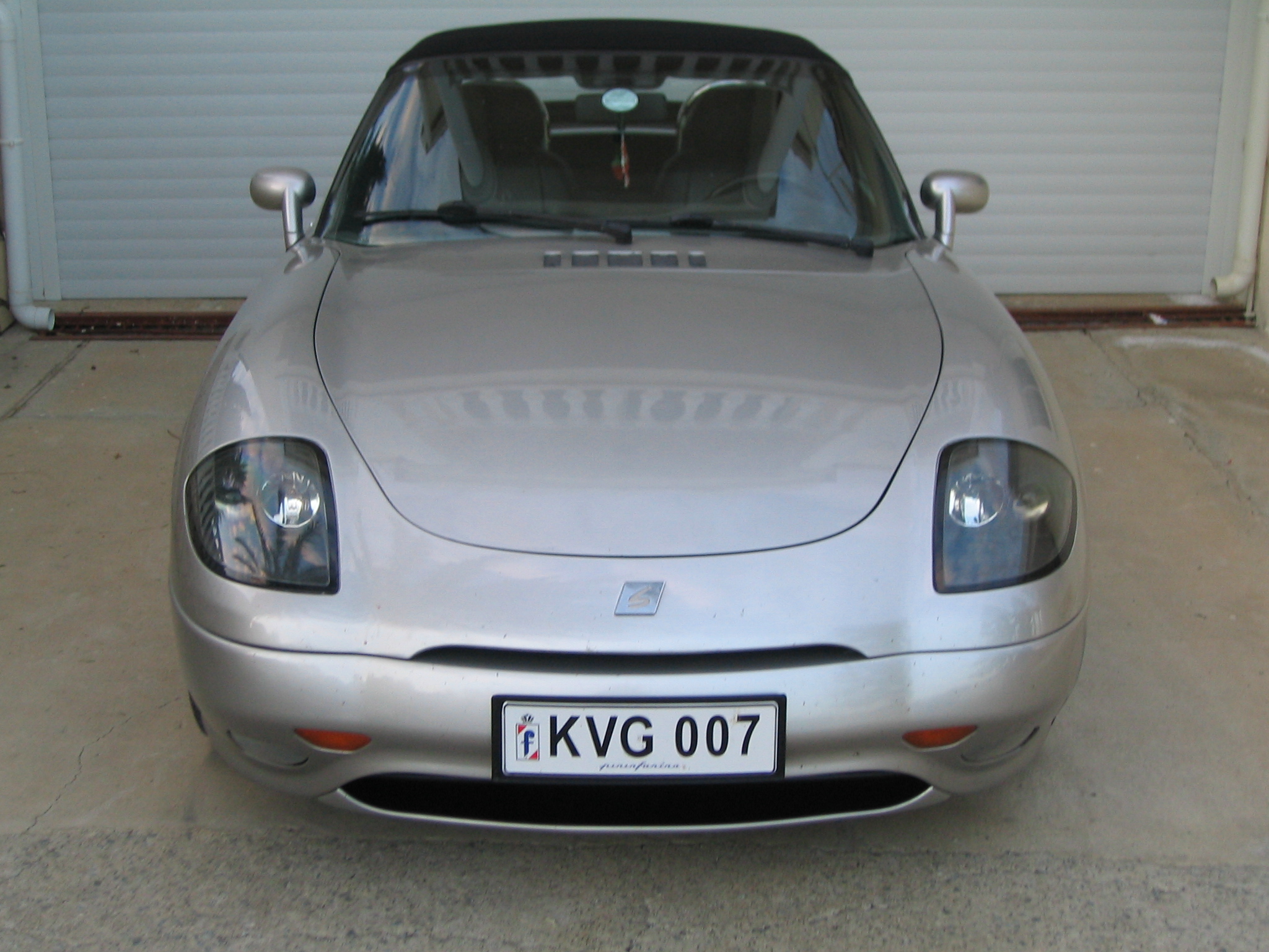

Today i found a guy who molds fiberglass and was asking if he could manufacture a new bonnet, rear bootlid and any other panels for the B. He said it shouldnt be a problem and so later in the future i will more likely have made a new fiber bonnet, rear boot lid and possibly the rear roof cover panel. It should shed some weight and i would like to add some air vents to the front bonnet to help cool the turbo.
can anyone photoshop a few pics of my B with some vents in the bonnet in appropriate locations. many thanks. (y) would be nice to see how it might look.

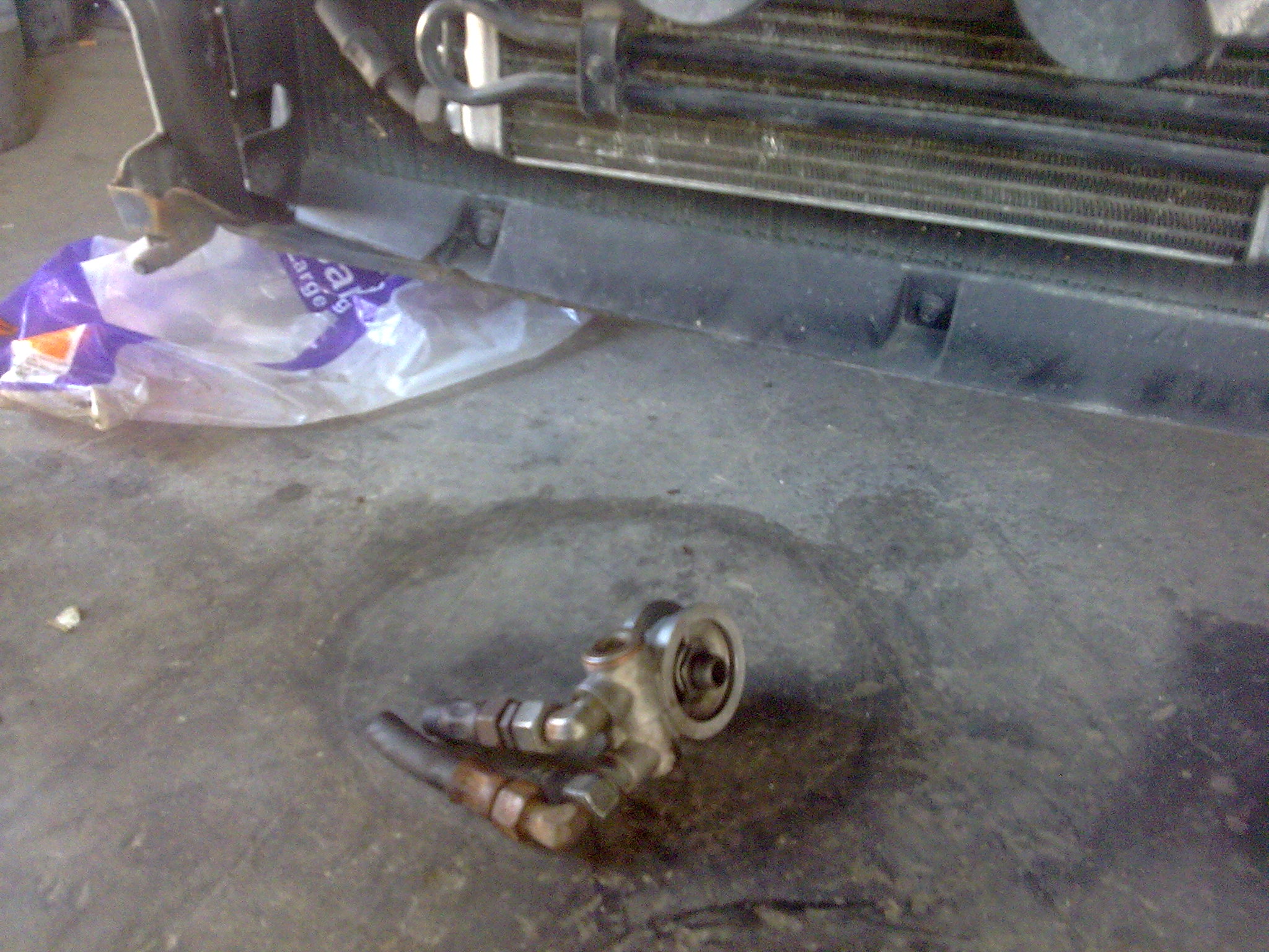

Installed a 12row oil cooler yesterday,
should help the B run smoother with all this extra heat here in Cyprus and one step closer to the Turbo mod. :D
For this modification, youl need
1x 12row Oil cooler
1x Sandwich Plate and necessary adaptors
2x 10bar Oil Hose
Also replaced the metal strip/bar that holds the Rad in place, they tend to go rusty very easy, most B's ive seen have this problem, Not much rain here so thats the end of that problem too.. :)
