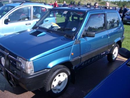

Technical Just started and could do with some 4x4 help.
