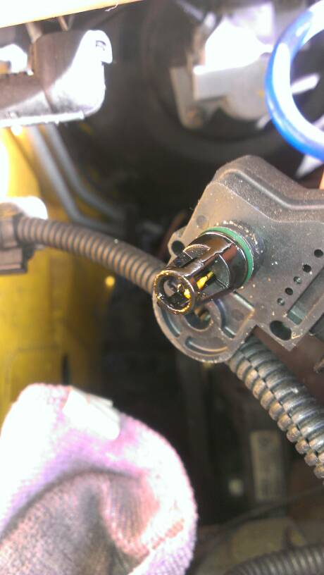

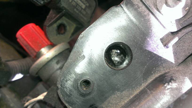

Also forgot to mention, does this look normal for the MAP sensor and the hole where the MAP goes? Oil on the sensor, and in hole.
Thanks :)

The only thing that realy stand's out here,
if you re-trace your step's (lamba sensor's)
You had one 'Moody one,that brought up the 'EML' Yes?
but when you swapped them round, the EML cleared,
but that'd only sugest to me that youve just moved a fault,
Indeed, I thought the fault code would move to post cat rather than pre cat, although I'm not sure if there is a code for post cat?
Mes doesn't tell me much about the lambdas on 16v version compared to 8v, would you recommend swapping em back round or just replacing the one that is the suspect?
Thanks
TBH, id just find one in a scrapyard or get one' off someone breaking one,
if then it dosent turn out to be the 'Lambda sensor. youve not lost much,
& then at least youve gained another spare part for a 'rainy day,
but as this 'Lambda sensor is or has been flagged up in the past,id be looking at that as suspect,
these things take alot of heat, and it couid be as old as the car,
it couid be feeding the ecu lies, making it overfuel or underfuel,
Will get a quote off scrap yard or pick up one off eBay, hopefully a working one!
Tbh both lambdas look 10+ years old!
Cheers, will get back with results
