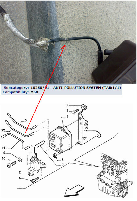

I have had the same case, with a little difference in the position of the demage. It's close to anti-poluttion system. Look the picture and watch the pipes! Better then turbos or VGT actuators... :cool:
I think I recognize that - isn't it the vacuum reservoir (feeds the VGT & stop valves)?

Because of the leak I think there was hardly any movement of the actuator but all the time the ECU would see low pressure at the MAP sensor and request the VGT valve to generate more boost. This would eventually cause some movement of the actuator but also due to the nature of the break in the tubing (check the photo) then the tube would temporary and suddenly seal itself.
Yes, that's it exactly.

I have Red Dot Racing remap and I'v got the explosion of power at about 2800-3200 rpm. At the lower rpm I could not see any movement of the actuator rod and I was prepare myself for turbo cleaning (and possible unbalancing :eek:) or just a VGT actuator repair / replace. But, we trace the problem from the actuator pipe, up to overboost sensor (replaced on batter case) and till to vacuum reservoir. At the vacuum reservoir we'v got the vaccum pressure, and the valve is working. Then we suspects on overboost valve and remove the pipe from it, but there no vaccum, too. At the end we'v start to trace the pipes and found the demage.
Now, in this perspective I think that was the problem due to some misstake with the fuel filter replacing and accidenlty change the pipe routing.
Now, my Stilo was alive, again! And I have the real boost. I'v made some tests and accelerate in 5th gear from 80 km/h to 120 km/h in just 8.4 s! Before remapping this was 10.7 s, and with the hole in the pipe it was 25+ s.
