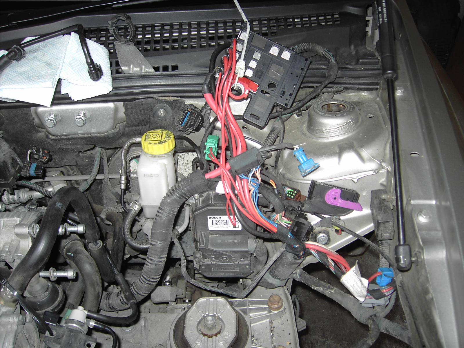

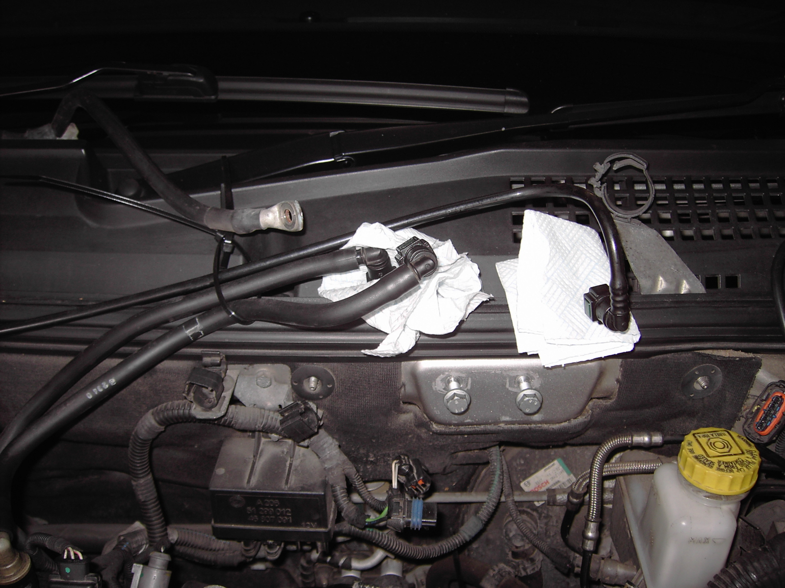

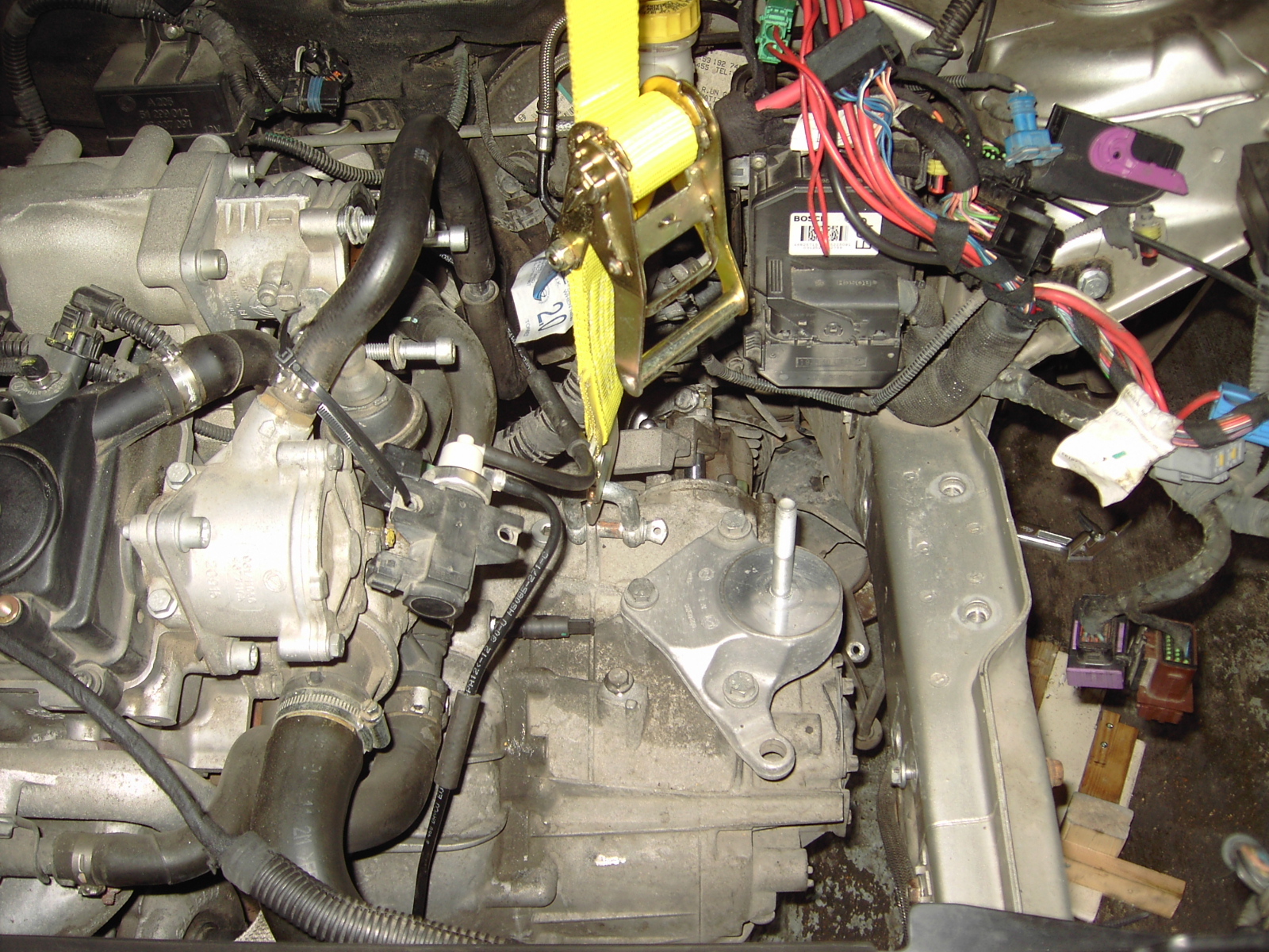

The subframe didn't need to be lowered. The engine and gearbox tilted down enough for the gearbox to come out under the chassis leg.
You will need to remove the fuel filter, battery, battery box, fuse box, front exhaust and a few other parts from around the gearbox for access.
