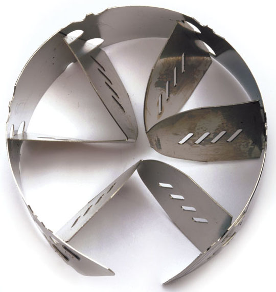

Some motorcycles use a simple bladed device to create turbulence on the induction side. It looks similar to the attached photo

If we use your figure of a reduction in area of 80% then there would be, everything else being equal, a localised increase in air-flow by a factor of 5X which in turn would cause heavy turbulence of the air-stream.
