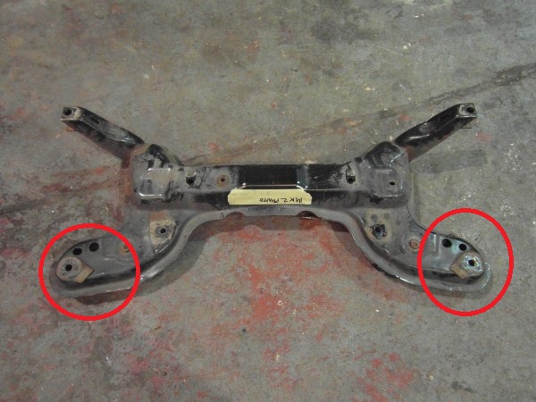

Where to place the jack exactly.
I presume under these points?

This pic should help, but I'm a bit unsure what I'm looking at there (without it attached to the car). Here are two pics I took. First shows where the second pic is zoomed. Is this a reasonable area to support the car? Would you then centre the jack on point 1, 2 or with a block of wood on 3?
Am I looking at the wrong place entirely? I very gingerly tried with a block of wood here and heard a "ping" that I didn't like, so let it down. Don't see anything off (and nothing had left the ground, so hopefully no harm done if I was doing the wrong thing).

If using point 1 (the bolt closer to the sill), would you put the cup of the trolley jack around/covering/over it (which will transfer load to the black metal) or would you put a piece of timber (I've 8mm thick pine off-cut) in between which would transfer load to the head of the bolt that is showing there? (or even drill a hole in the timber to accommodate bolt, again putting load onto the black metal but avoiding metal-to-metal contact)
My axle stands look more like the blue ones (they're pretty flat, slightly cupped) so I've to do something with timber to accommodate the edge/seam I guess.
Is there anywhere to get a diagram with things like "subframe" and lower-arms marked out? I had searched the forums and found guides on jacking, but none with pictures and my knowledge of terminology let me down a bit.
Actually, might try with something like a thin book/paperback in between? More "give" than timber, but still protecting the metal surfaces

Personally i like to jack the front up from
A - where the subframe bolts to the floor
B - where the subframe and wishbone meet
And the rear - i jack up on the rear beam axle, usually in the middle to beat jacking twice :)
Axle stands go normally where point B is for me
Are either of those spots where I highlighted (if it is, I'd guess I referred to B)
How do I identify these points A and B?
(my knowledge of terminology and under-car geography lets me down!)
