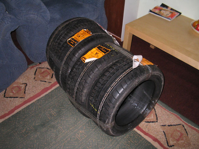

Just got home and found a new present waiting for me.
4 of conti's finest rubber(y)
