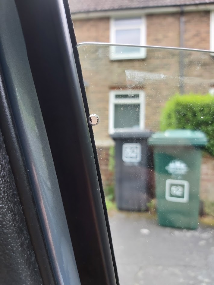

Hi everyone,
So I bought my 2009 Panda back in March and neither of the front windows worked. I did a bit of digging and discovered the pass. side window wasn't even plugged in. After doing so, I noticed why it was probably disconnected... The motor works completely fine, pushes the window up and down, however, the issue is with where the window sits.
I've noticed that when I put the window up it tends to rotate in the rails/housing so the top left corner of the glass pokes out of where it should be. (this means I have to push it back in place to avoid damage.)
There is a hole in the glass as if it should be clipped to something but I'm unsure how.
Does anyone in the forum have experience or knowledge of anything that could help?
