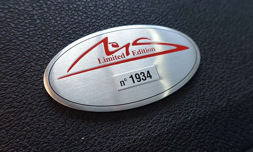

What number does yours have on the Schumacher badge on top of the dashboard?

So, is 2172 genuine ?, and if so, as it's only the 2nd known diesel Schumacher does it make it valuable ?
I don't know about its actual value.
But I can tell you that it is genuine, I bought the car about a year ago and it hasn't been modified in any way, it even has the original clutch.
