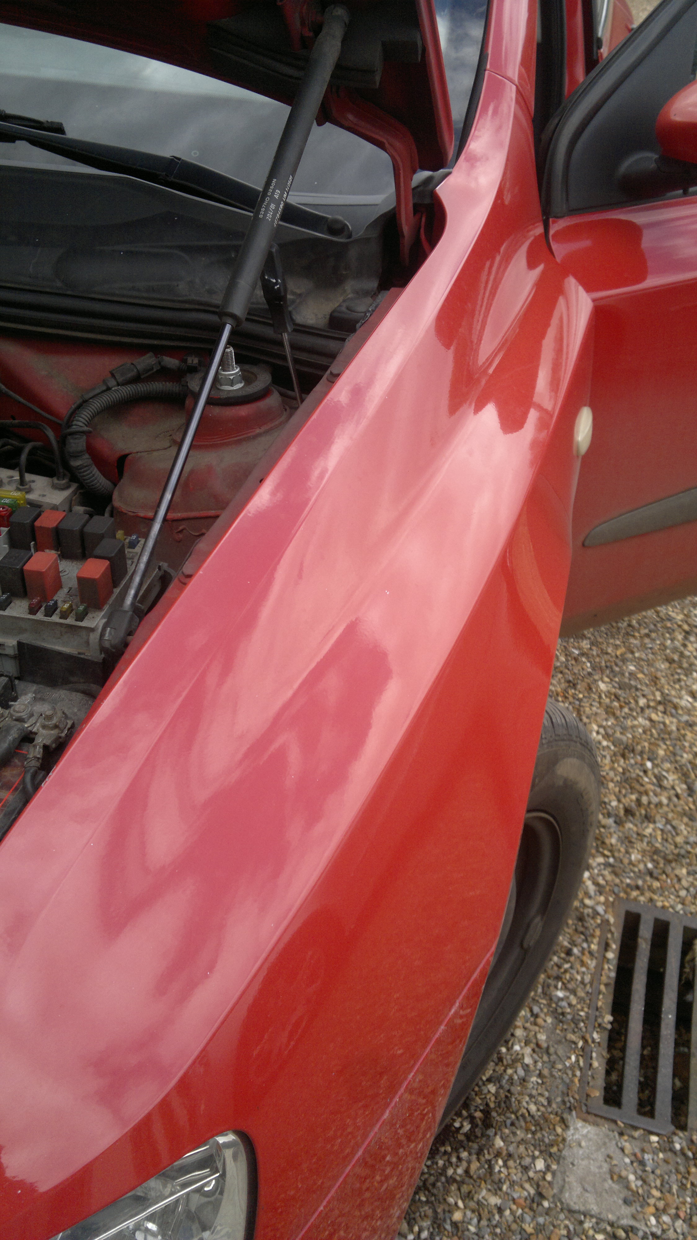

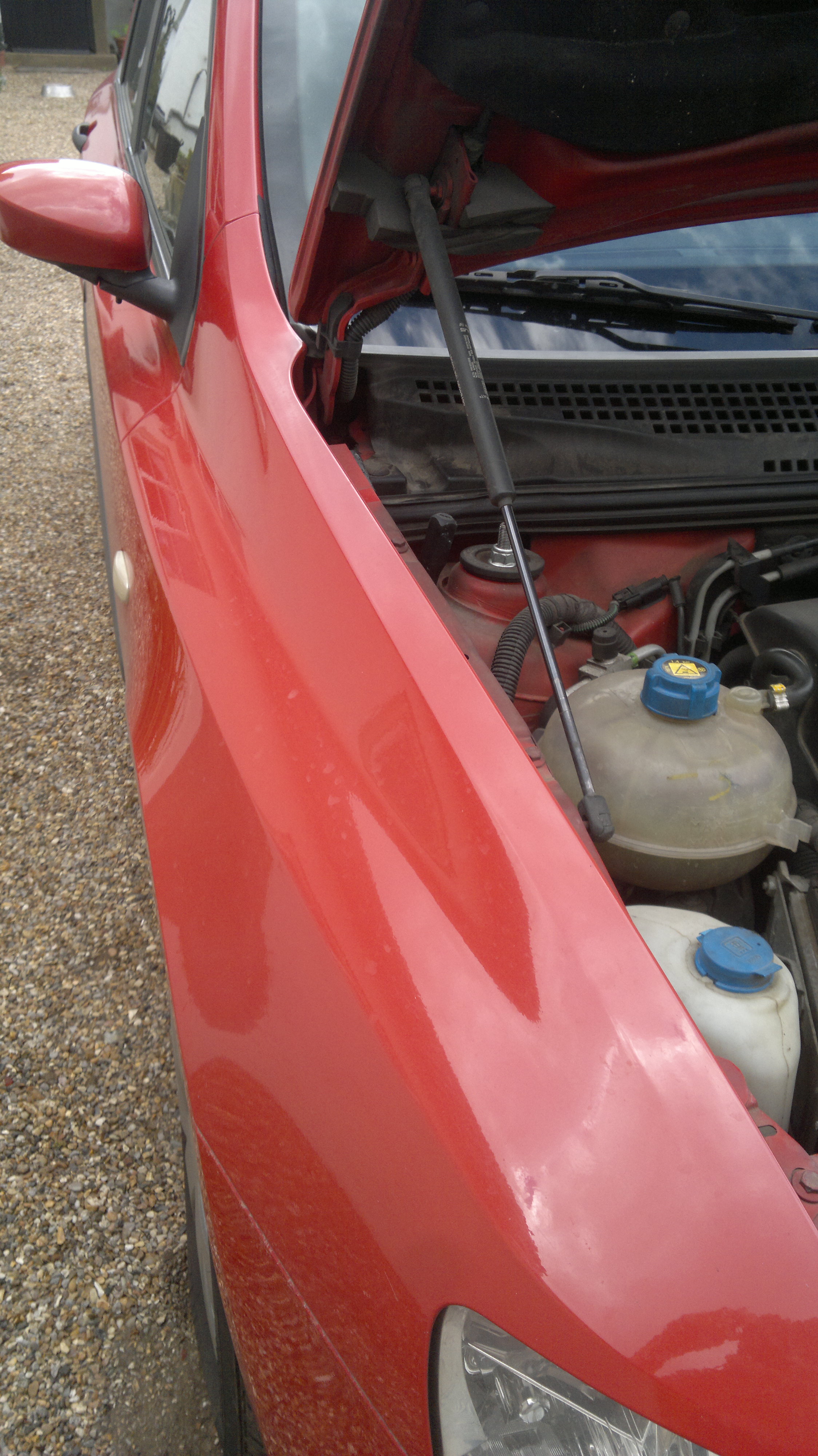

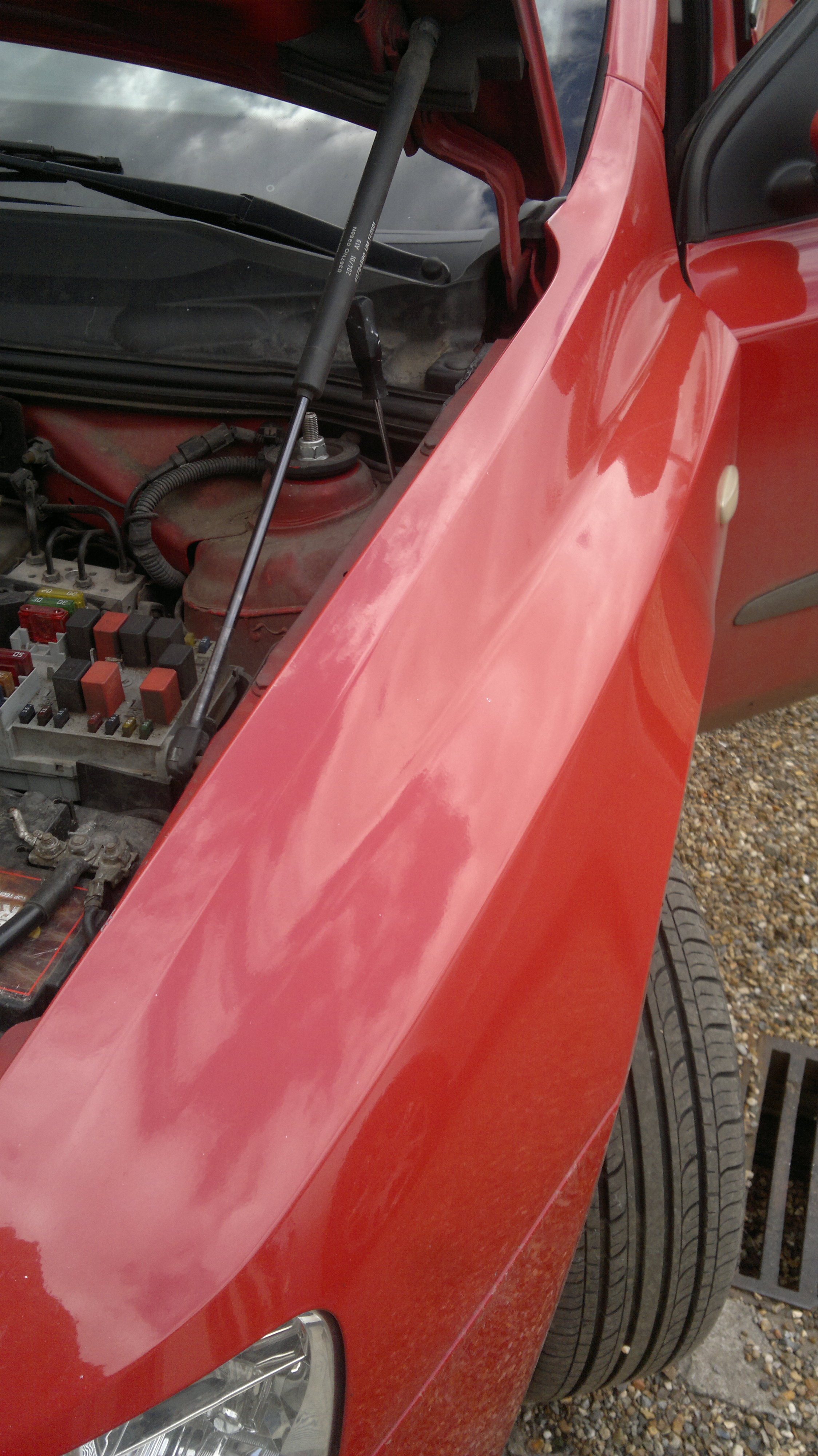

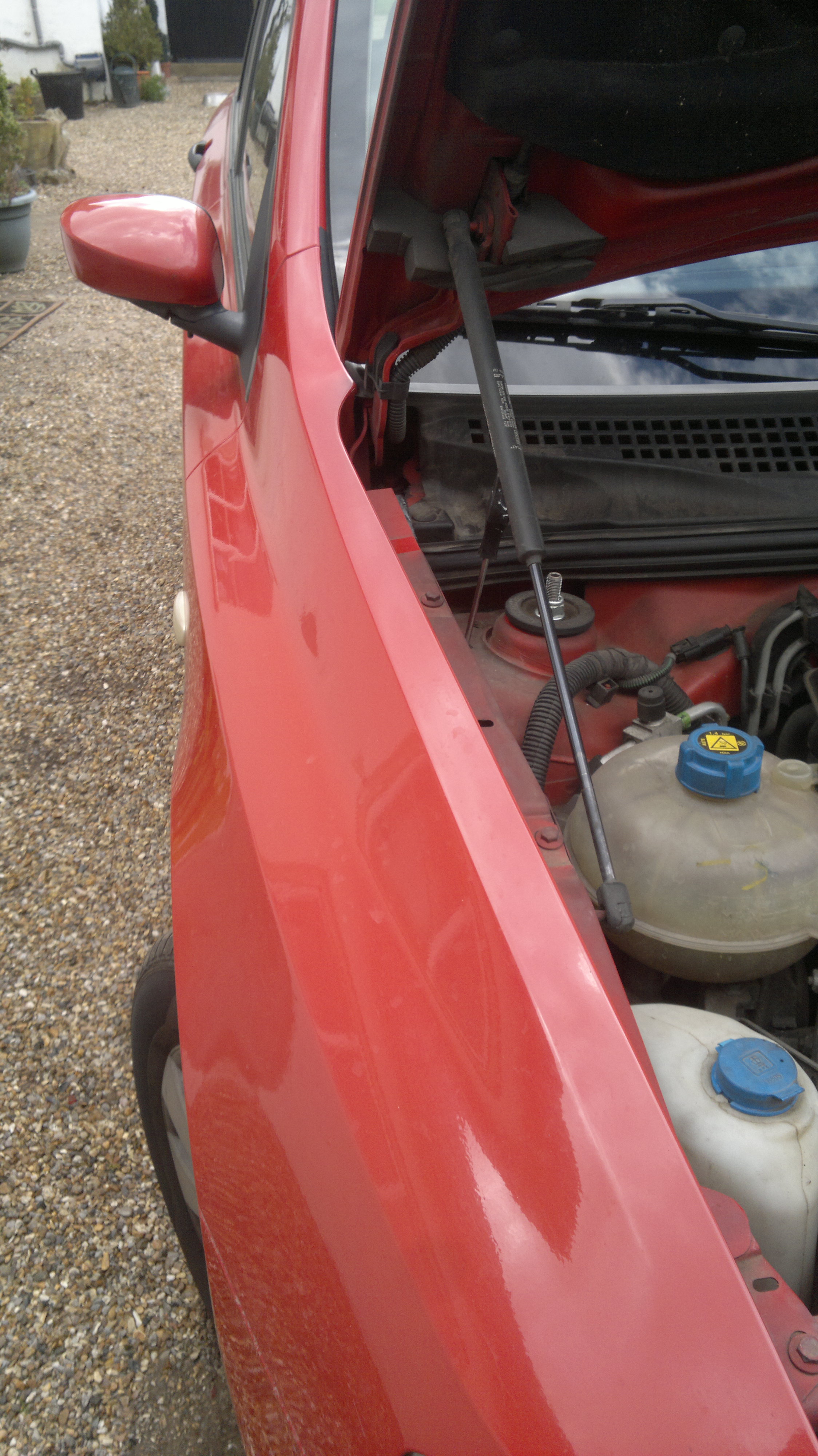

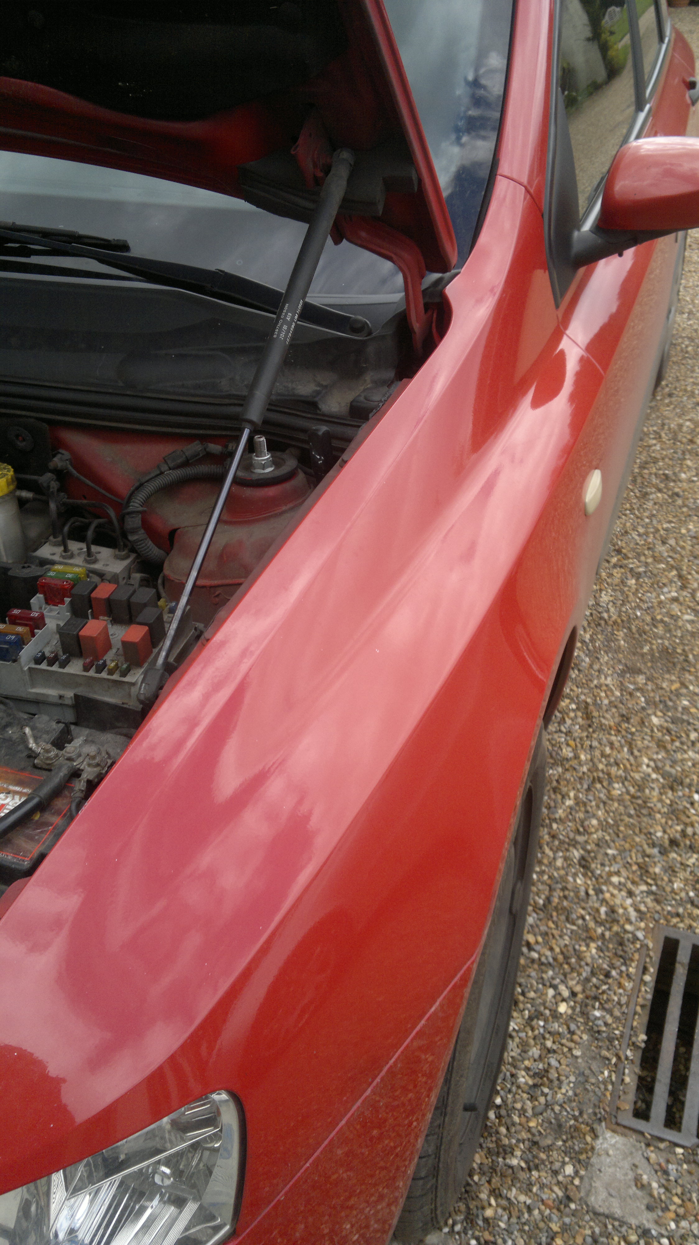

When the strut was assembled,but not fitted on the car I could not turn the top mounting.I barely managed to turn it like 1 cm but it came back realy fast.I am sure that the bearing is seated and in the right position.I've made some pictures with the car to see how the strut is.
In the first picture is the car and the wheels are aligned and you can see that the screwdriver is fully in the hole.
The other 4 pictures are with the wheels steered and you can see that the screwdriver is only 1 cm.
If the top part has turned inside the turret, the screwdriver will pass through because the hole moulded on the side of it will not be under the hole adjacent to the turret.
Is the hole visible at all times? i.e. with the wheels straight ahead and at an angle.
Check both sides again with the wheels straight ahead and at an angle. With the wheels at an angle, the hole should still be visible but the 4mm rod will not pass freely through both parts of the mounting.

Yes.If I open the bonnet and look trough the hole in the car body I can see the hole all the time.So the top mounting is not turning.I have reach to the end of all ideas that might cause this issue of mine,and do not know what to do further.
check post 20 as Davren said wheels straight ahead screw driver should pass both parts of mounting top and bottom the top bush should never move when turning steering. only bottom bush moves screw driver will only pass through both bushes when steering is straight ahead only.
That's exactly what I said.I can see the hole in the top mounting all the time(wheels straight or at an angle).Once I will turn the wheels the top hole is still there,but the screw driver wont go trough all the way,because the lower part of the mounting is turning,and the hollow is not on the same line with the hole.
