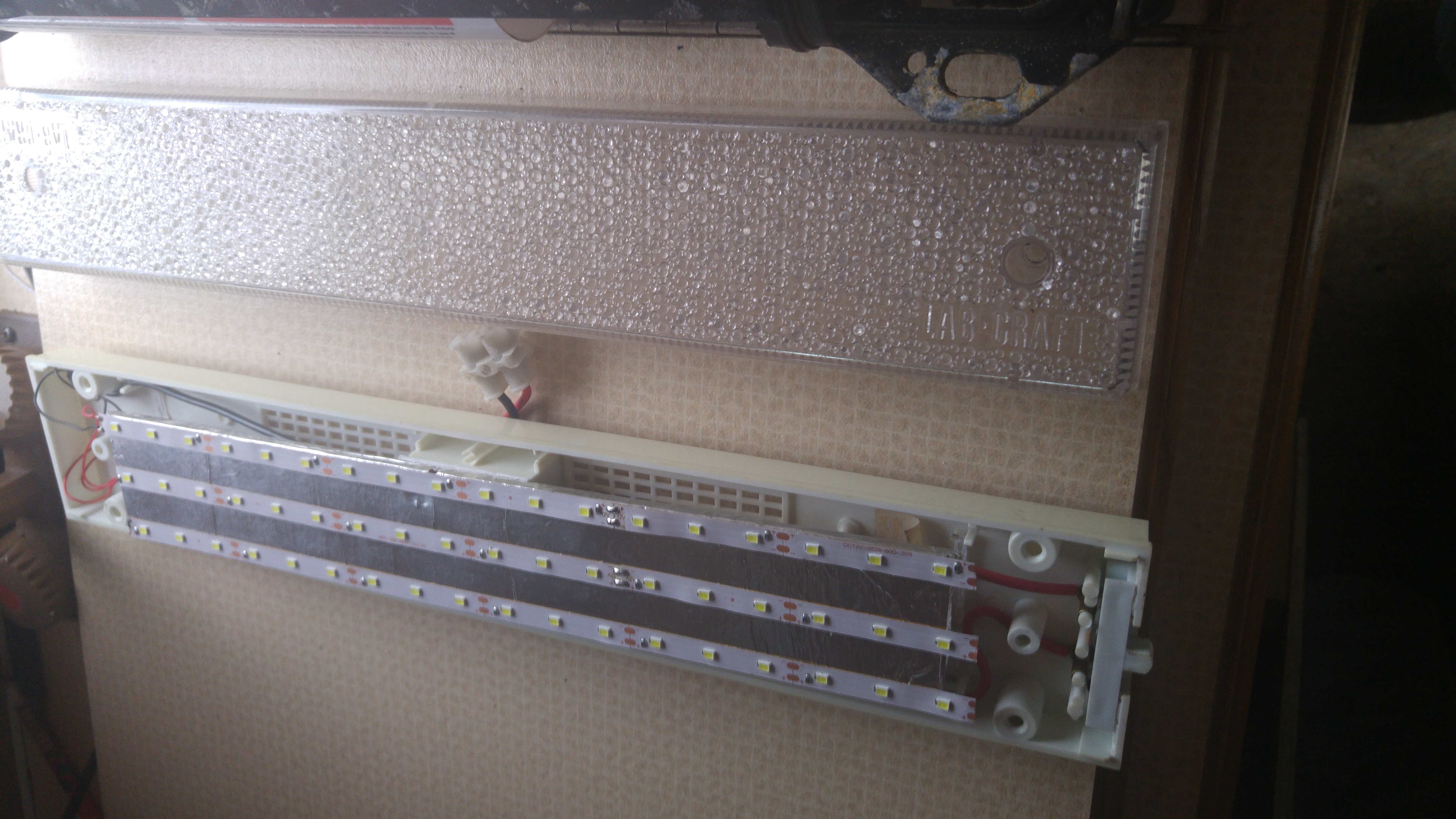

hi all
stripped out the old tube lights and made these up...
great job and easy on the battery too

That's a LOT of Leds.....it's going to be very bright; maybe too bright!
sorry for the late reply
it is a lot of leds but got them hooked up to a remote dimmer from china
a great wee bit of kit
