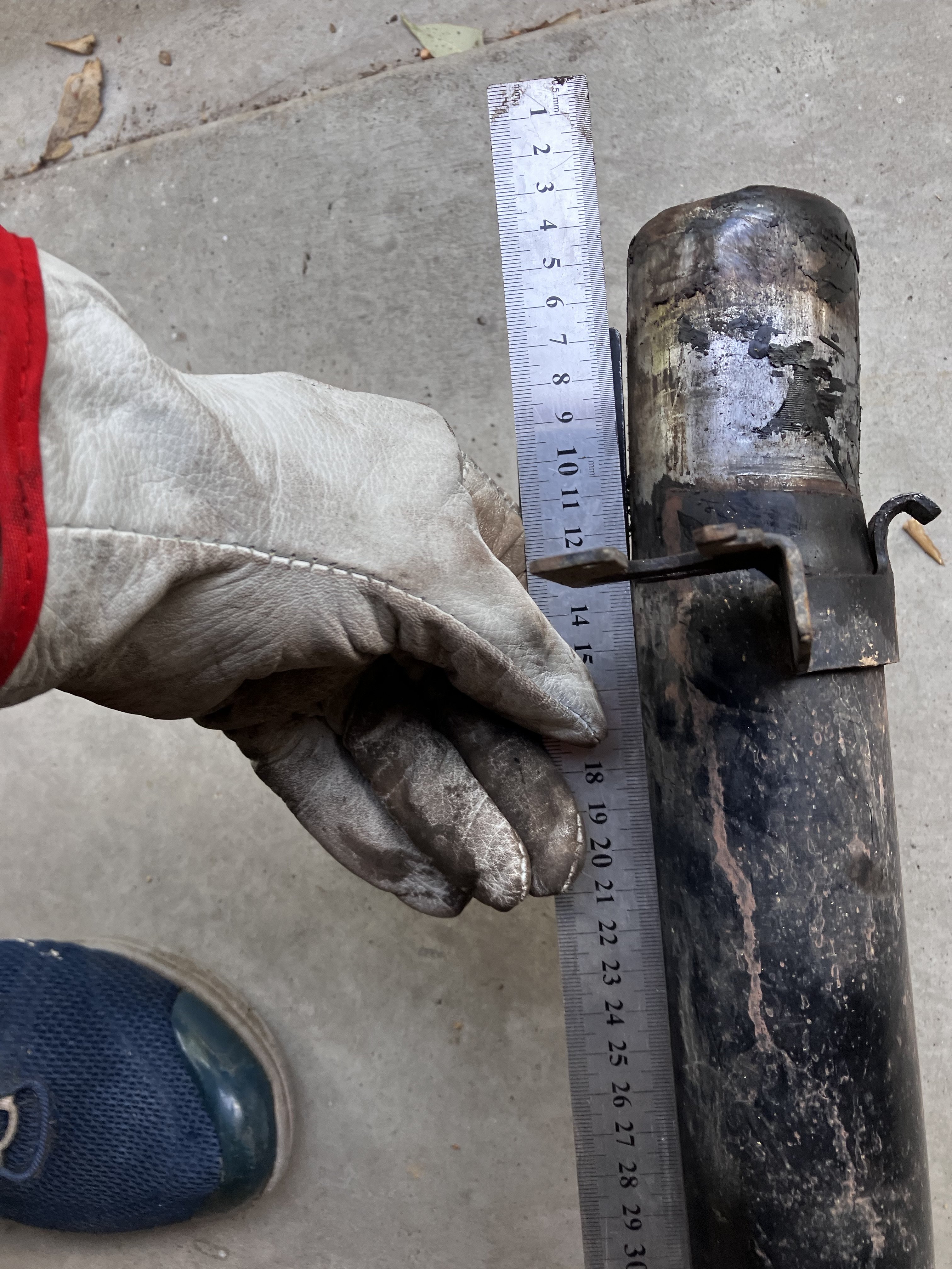

Interestingly, i have rechecked the struts i removed (unbranded) and found they have only 160mm shock travel !!
Compaared to the 185 mm on the Munroe’s
That would suggest there was less than 40 mm compression travel before bottoming out ! ..Rediculous !
