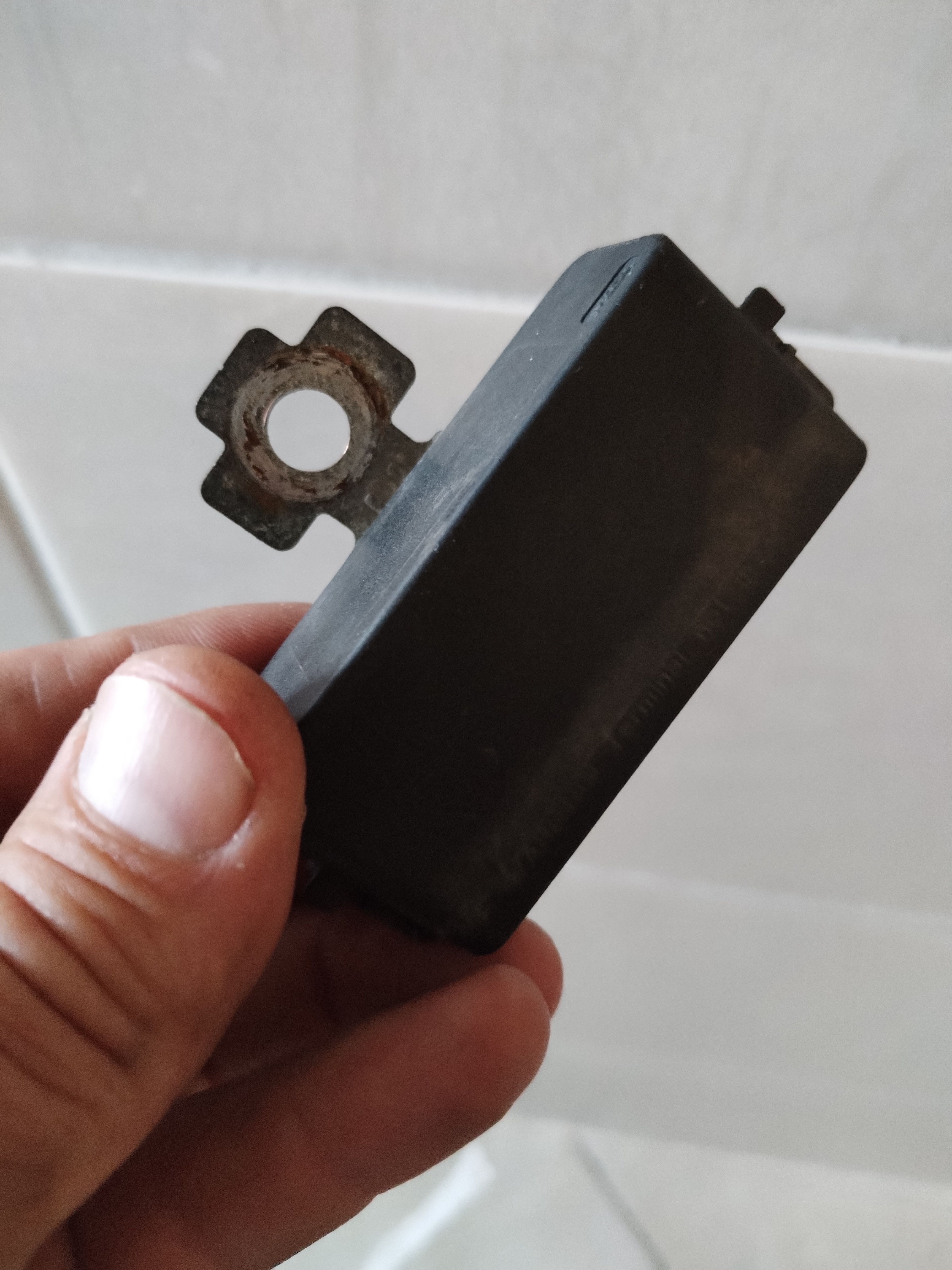

I can see that it is bad connection in this. Its a ground spor behind the mainlight. A lot of earth wiring into it
See C015 on attached drawings, but also check C040 (ECU) earth

C015 have no connections
My friend, you have not understood.
Earth point C015 is I believe, the one in your photo. It has many connections, and associated functions. From the previously attached drawing, starting at the left:- sidelights, dipped headlights, main beam headlights (same connection, but different diagram), direction indicators, front foglights, and several other items.
Earth point C040, is the main ECU earth point, but the main chassis earth point (flag terminal), near the RHS engine mounting, is also in the circuit back to the battery.

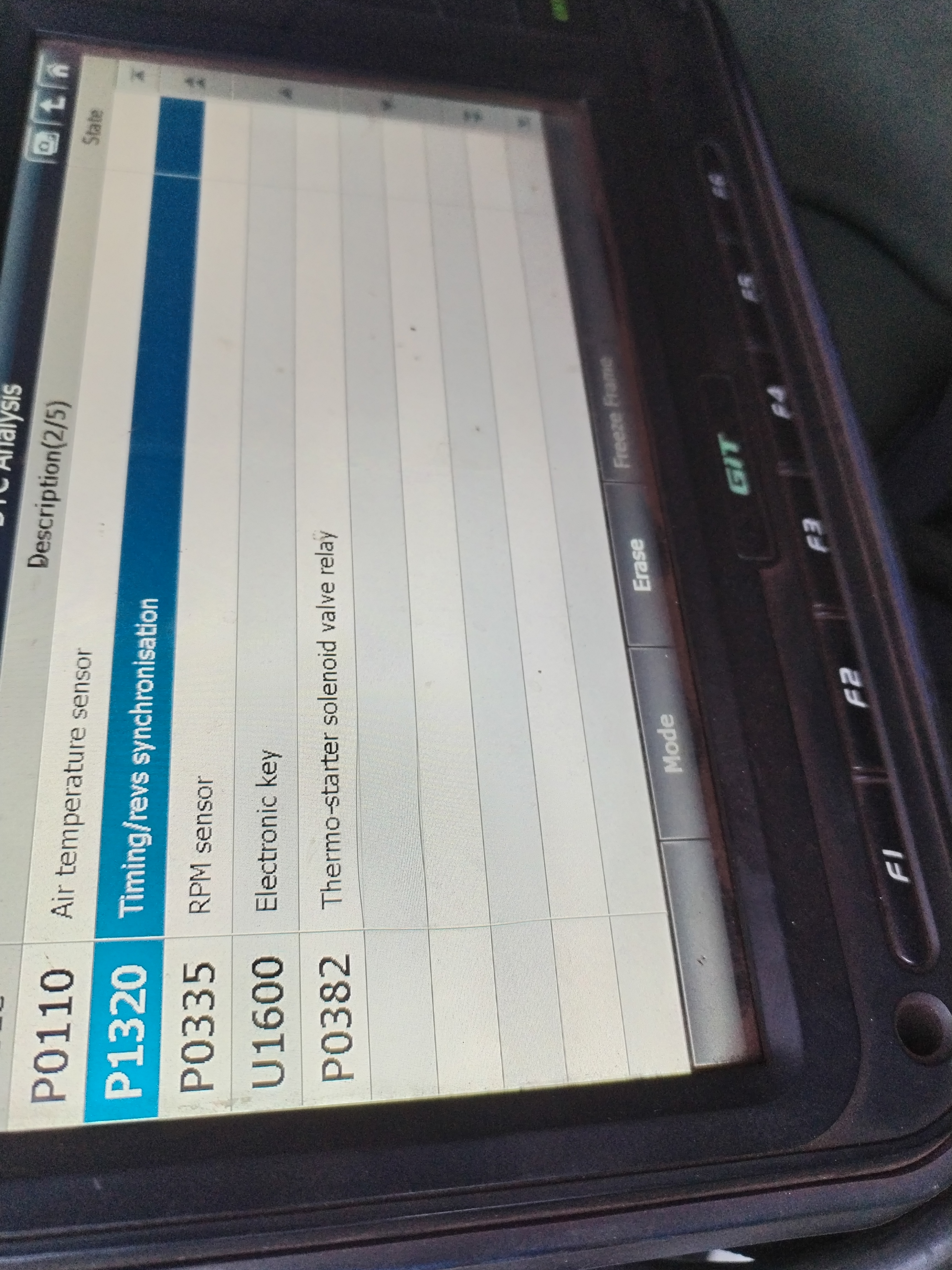

I have now changed the parts that showed at the fault codes. The car is almost starting now. But I got a fault code that I haven't seen before. Diesel heater.. The one on the diesel filter. There is No power on the wires there. Do you know where the fuse are for this? The pic is from before i deleted the fault codes

The diesel heater is supplied via fuse F20 in Engine Bay Fusebox. Drawings show 25A (white, or clear), but Fiat do not seem to use this fuse rating. Mine has a 30A (green) fuse fitted. As the heater is controlled from the ECU via relay T19, it is more probable that corroded contacts at the relay.fusebox are the cause of the problem. The heater is only used when fuel temperature is below 6 Centigrade. If the heater relay is not included in ECU initial self checks, then probably your are experiencing temperatures below 6C. You will know better than me. It could explain why the code has just been seen.

Are you still getting the RPM sensor code, as if ECU cannot read the Crankshaft Position Sensor (CPS) then it will not know to fire/open the injectors. The Rev counter in vehicle should be moving if CPS is working generally as a basic test.
