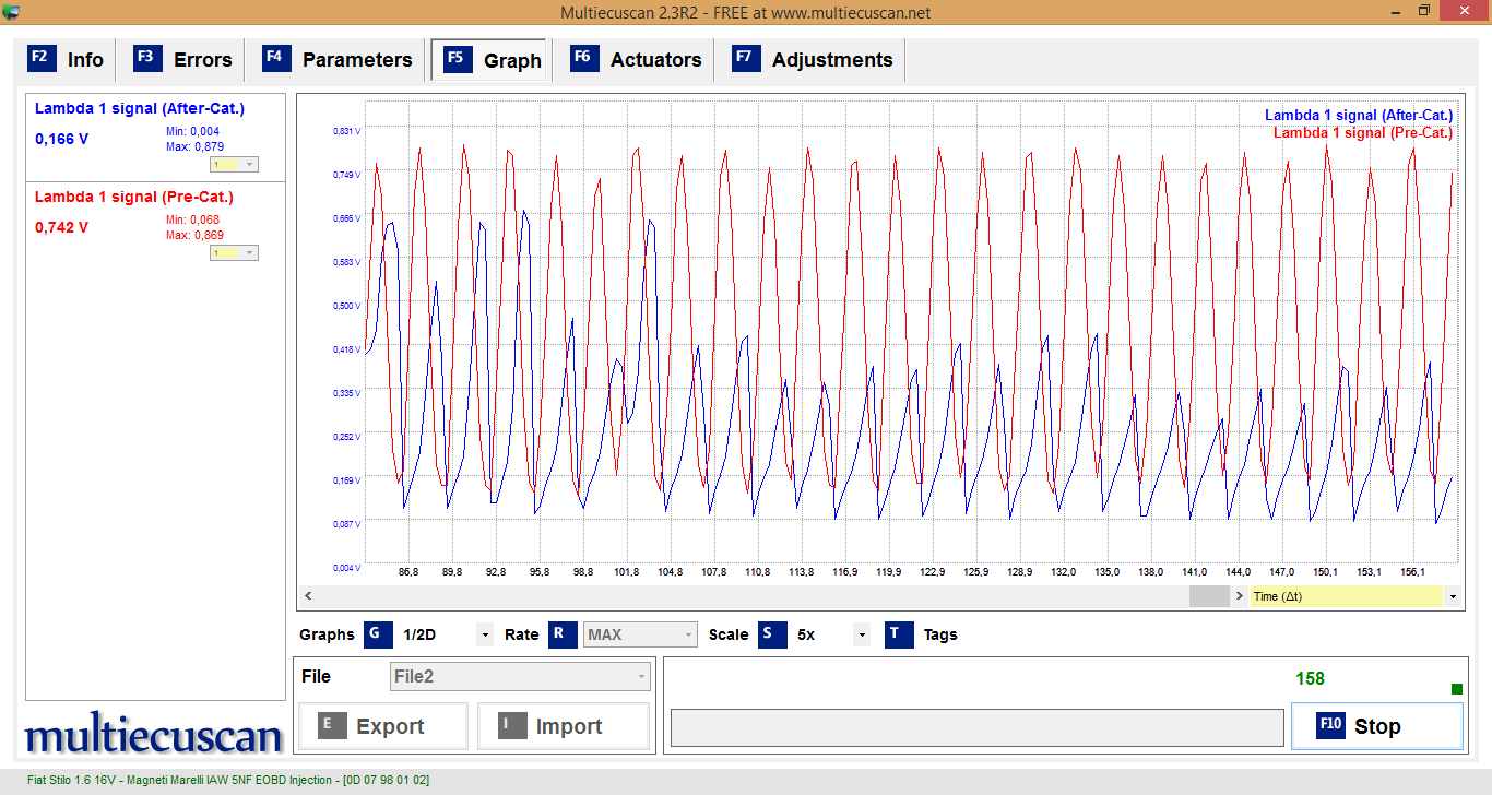

My Fiat Stilo 1.6MW 2003 gets same error code P0420, nothing else (no lambda codes etc.) I read it with multiecuscan+ELM327 v1.4.
Here is some data.
Simple question, is my kat gone bad or something else?

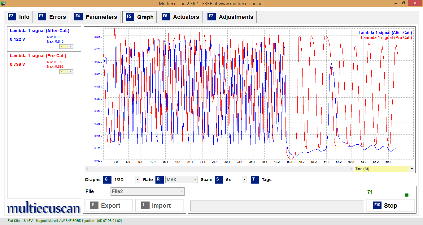

First picture is taken warm engine, about 3500-4000rpm.
Second instantly to about 800rpm idle speed.
Third is quite hot engine and idle speed.
