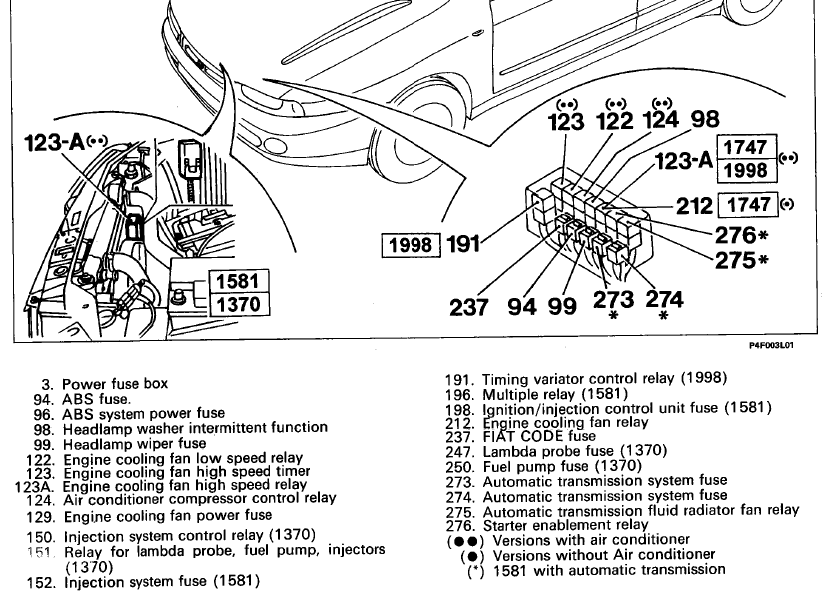

well believe it or not bulldog hit the nail on the head dodgy ebay starter,striped it tonight and freed up the shaft with the dog on the end,main shaft it now moves fingers crossed it works ok tomorrow any one know what the black box next to battery is it's not the one in front with the fuses in but the one at the back below bulkhead side ,think i have seen one on a pug td but not sure
Here you go, the diagram on the right :)

well it did'nt work put old one back and touch wood(grabbing my head) it's working after a good clean up ,thanks for the diagram evil marea is that on the work shop manual that you can get on ebay:idea:
Think it is the same one :idea:
