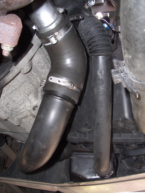

my pipes are also all ok, no cracks in them as far as me and dad can see. Checked both pipes below and cant find any cracks in them. The smoke seems to decide when it wants to be bad, its doesnt do it all the time, mostly when i floor it. However at low revs when the engine is struggling. say for instance when i go into a corner on a really steep hill to slow and the engine is strauggling to find revs, the smoke will poor out.
Im having the Fuel, and Oil filters changed on wednesday to see if the helps anything, if not its back to square one.
Stu.

That picture only shows the turbo to intercooler pipe. It's the one the other side which I gather can be the problem (intercooler to manifold - it's hard plastic).
Another check to do, that's real easy, is to disconnect your MAF sensor and then see if smoke decreases and mpg goes up. If you don't know what I'm talking about then use the Search tool. Absolute doddle to do.
