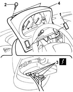

Disconnect the negative battery terminal
- Tilt the steering wheel down
1. Remove the blank switch covers from either side of the surround (1). (lever up from the bottom side)
2. Undo the 2 fixing screws under these 2 covers (1) & the 2 at the front of the surround, remove the surround (4)
3. Disconnect the connections.
4. Remove the instrument panel surround complete with instrument panel.
1. Undo the fixing screws.
2. Separate the instrument panel (2a) from the surround (2b).

Thank you Freespirit. Seen the 2 screws on top but was not sure if there were some hidden underneath. Will give it a go removing it today.
