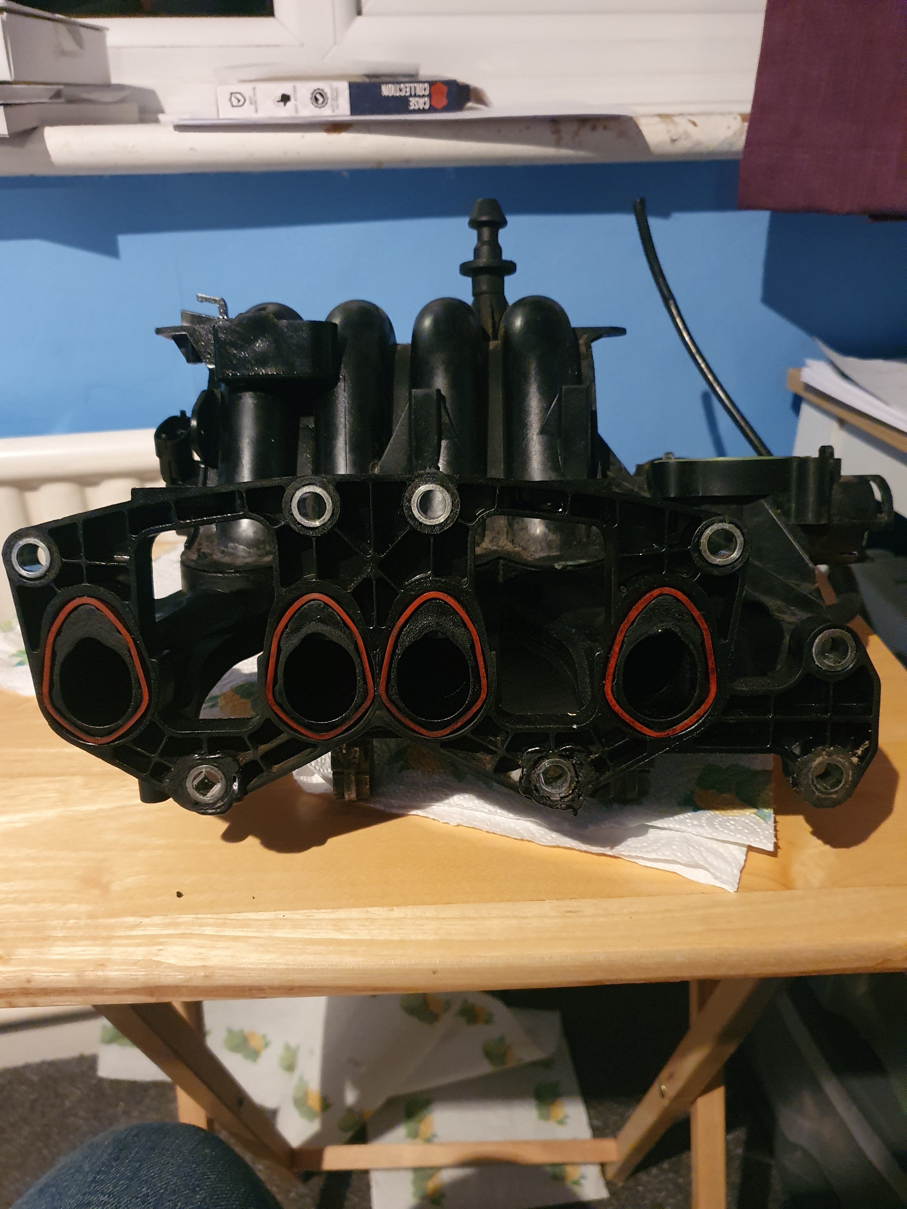

Hi new to the forum, i need to replace an inlet manifold on a Fiat 500 1200cc 2009, looking at the 1.4 inlet manifold it looks the same, my question is are they interchangeable or are the volumes or anything else different , thanks.

Thanks will give it a go, there's a 1400cc one 2017 and that looks identical to the one I have, will try get the part numbers 👍
