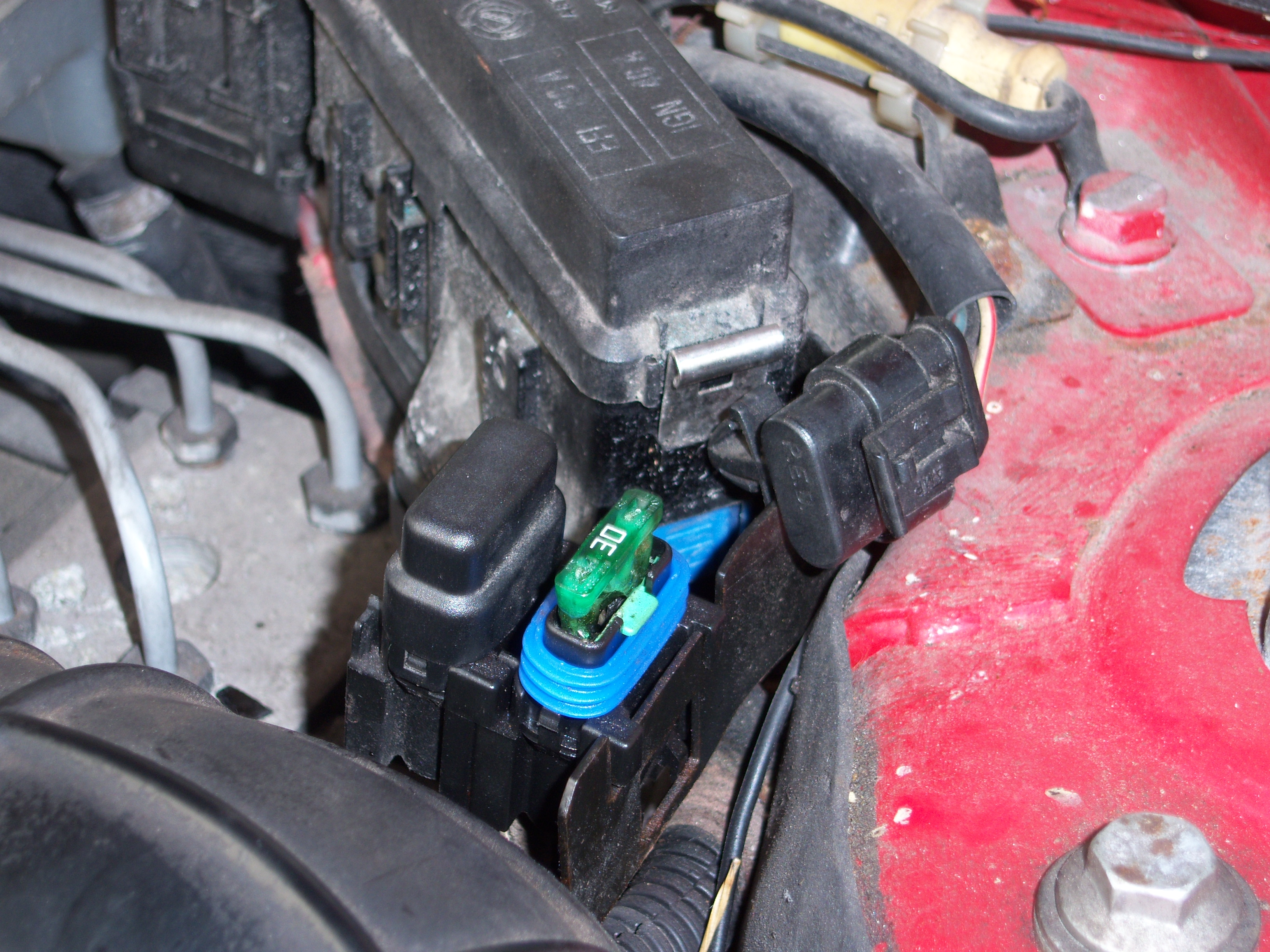

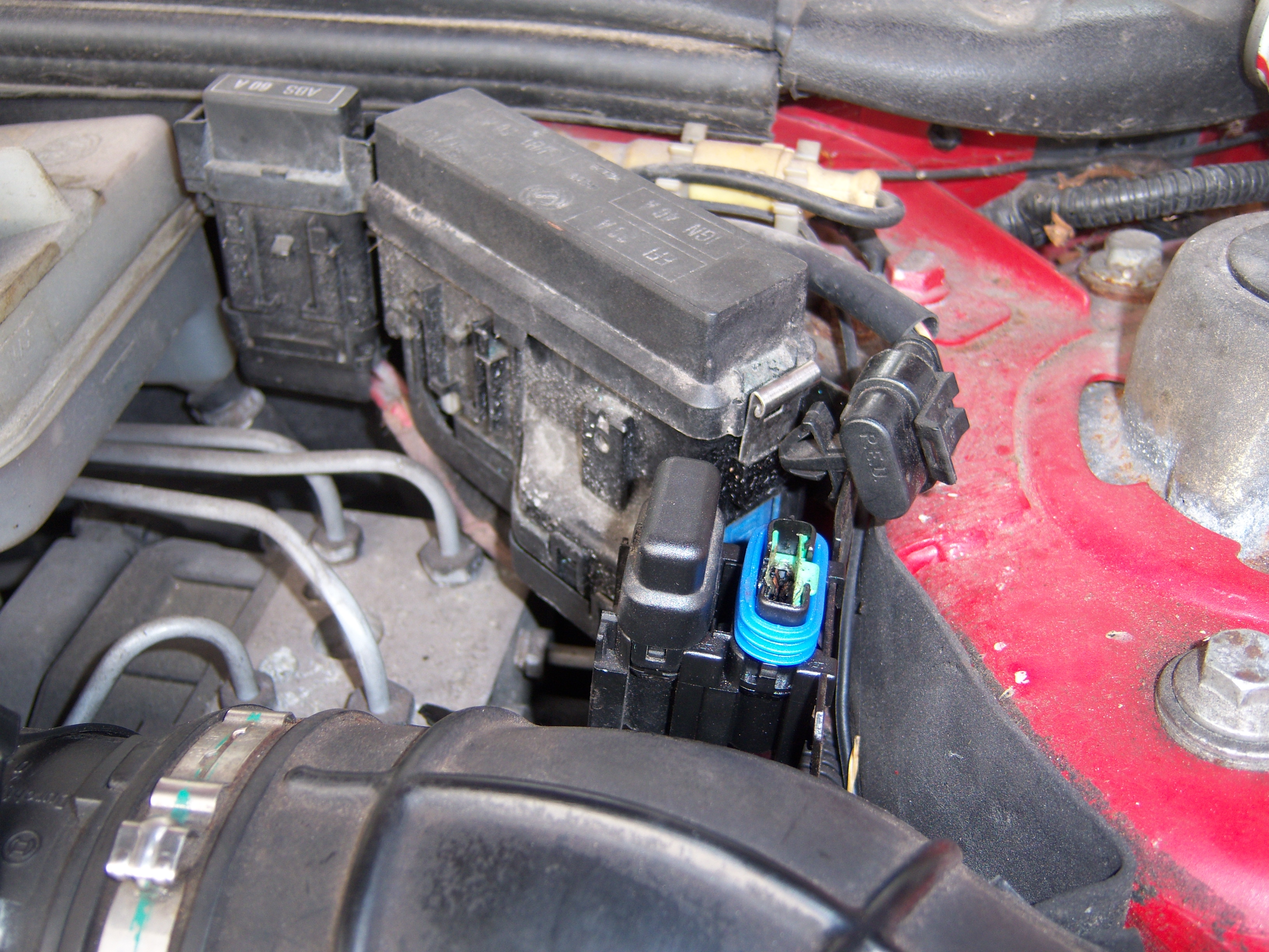

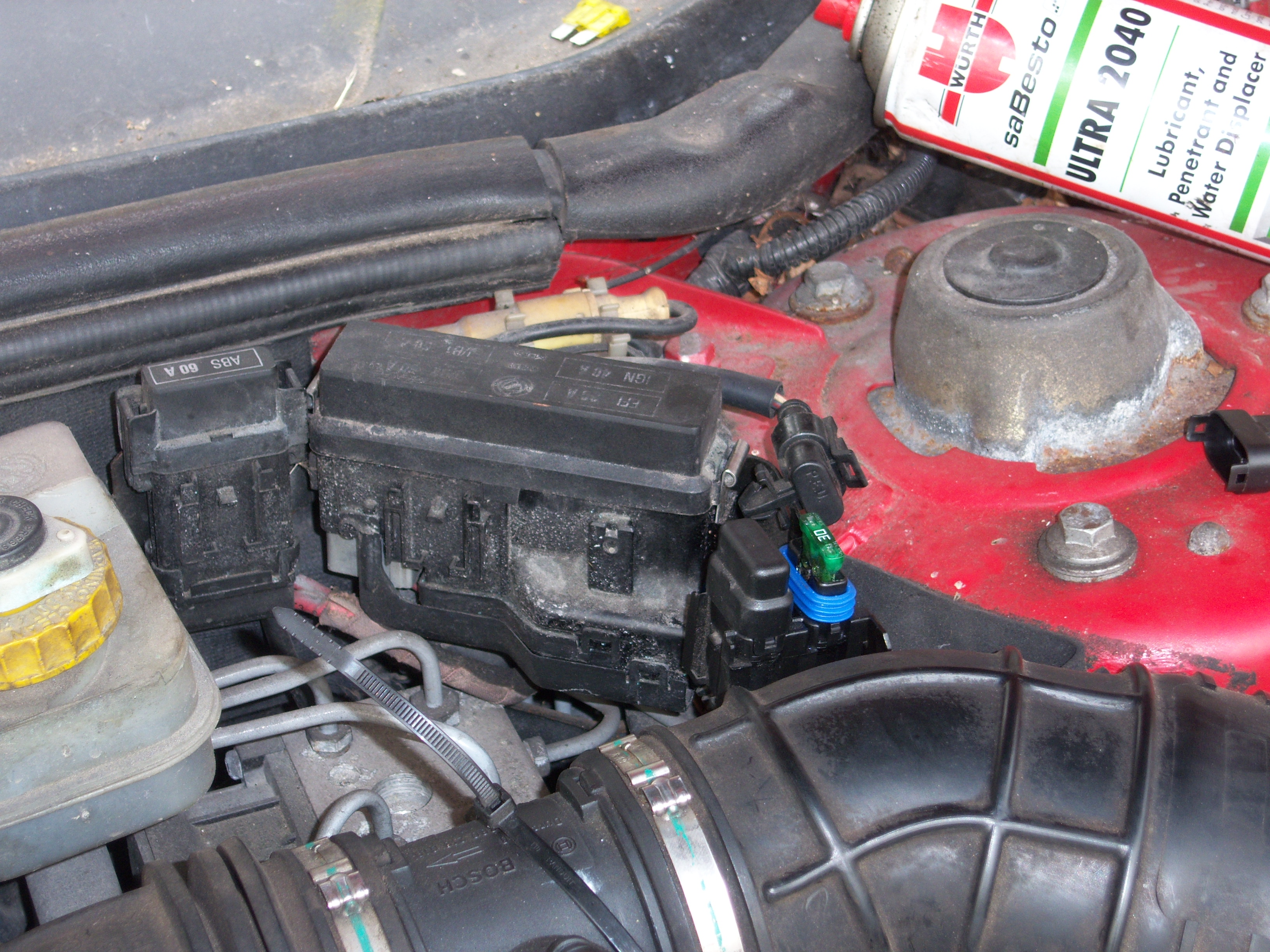

Well I had the ecu sorted by Schepers Autotechnic but the car is still a non runner. It was noticed that a fuse near the Abs control unit was badly burnt out ! Can anyone identify it !

Ouch!. Why's it a non runner now? or does it keep poping that fuse?
Well the problem with the fuse was eventually traced to the fuel pump being knackered! Well I purchased a new one and the car fired up but badly! Now the plugs are all oiled up and the mechanic says all 5 cylinders are full of oil. He is putting it down to a head gasket failure. I was under the impression that water in the oil would happen if this was the case but the oil is fine as it only done about 15 mile from the last service, no exhaust smoke , nothing ! Any ideas !
