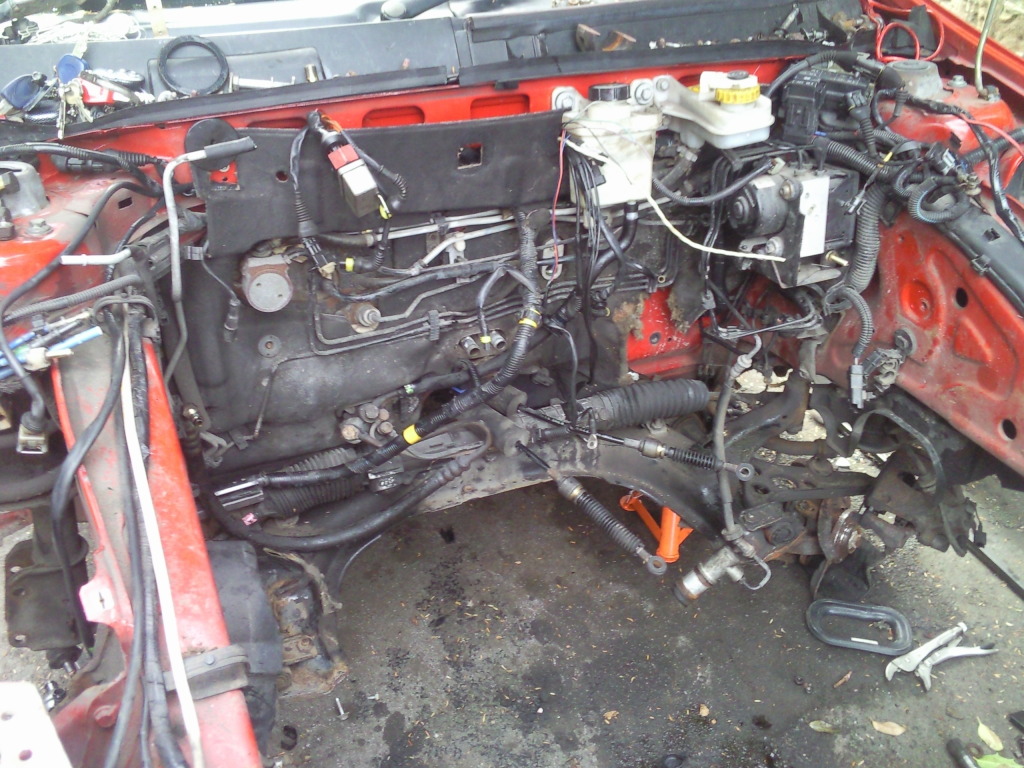

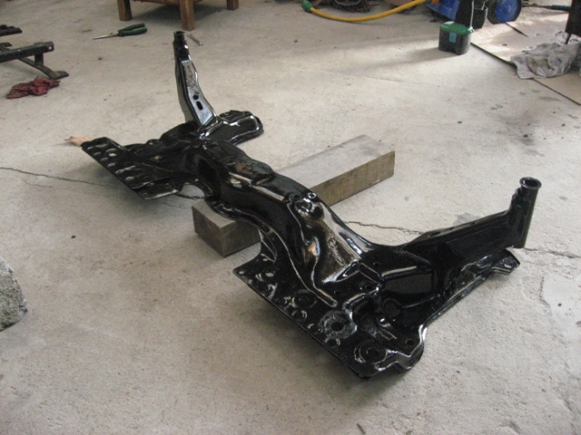

£30 + £15 delivery. Came wrapped in cardboard and although not pristine was extremely sound and in infinitely better condition than the one I took off. Fitting was reasonably straightforward too. All the holes lined up so nothing was too bent.
Just a couple of words of caution if you plan to fit it yourself
1. Have a good set of drills & taps&dies to hand as you will undoubtedly have to remove a sheared bolt or two, and running a tap through all the treads to clean them up makes refitting much easier.
2. Remove the exhaust tunnel heatshield. It will make the job soooooo much easier. I didn't but wish I had.
3. Drop the thing off (& refit) with the suspension arms & ARB still attached to it. They are much easier to remove once the assembly is off the car. You just need to loosen the ball joints from the front hubs and a bracket on the top of the subframe that clips the brake (or is it pas?) lines, then undo the bolts and drop it all down.
4. Have a couple of strong mates and a trolly jack or two to help you. These things can feel pretty heavy with suspension attached when you are lying on your back trying to lift it, hold it, and then get a couple of bolts located before it drops on your head.
Depending how much stuff you break It could be possible to do it in a weekend. I did mine over two, but took the time to clean a lot of stuff up (mainly threads) while it was all apart - drilling sheared bolts out took up a bit of time too.
