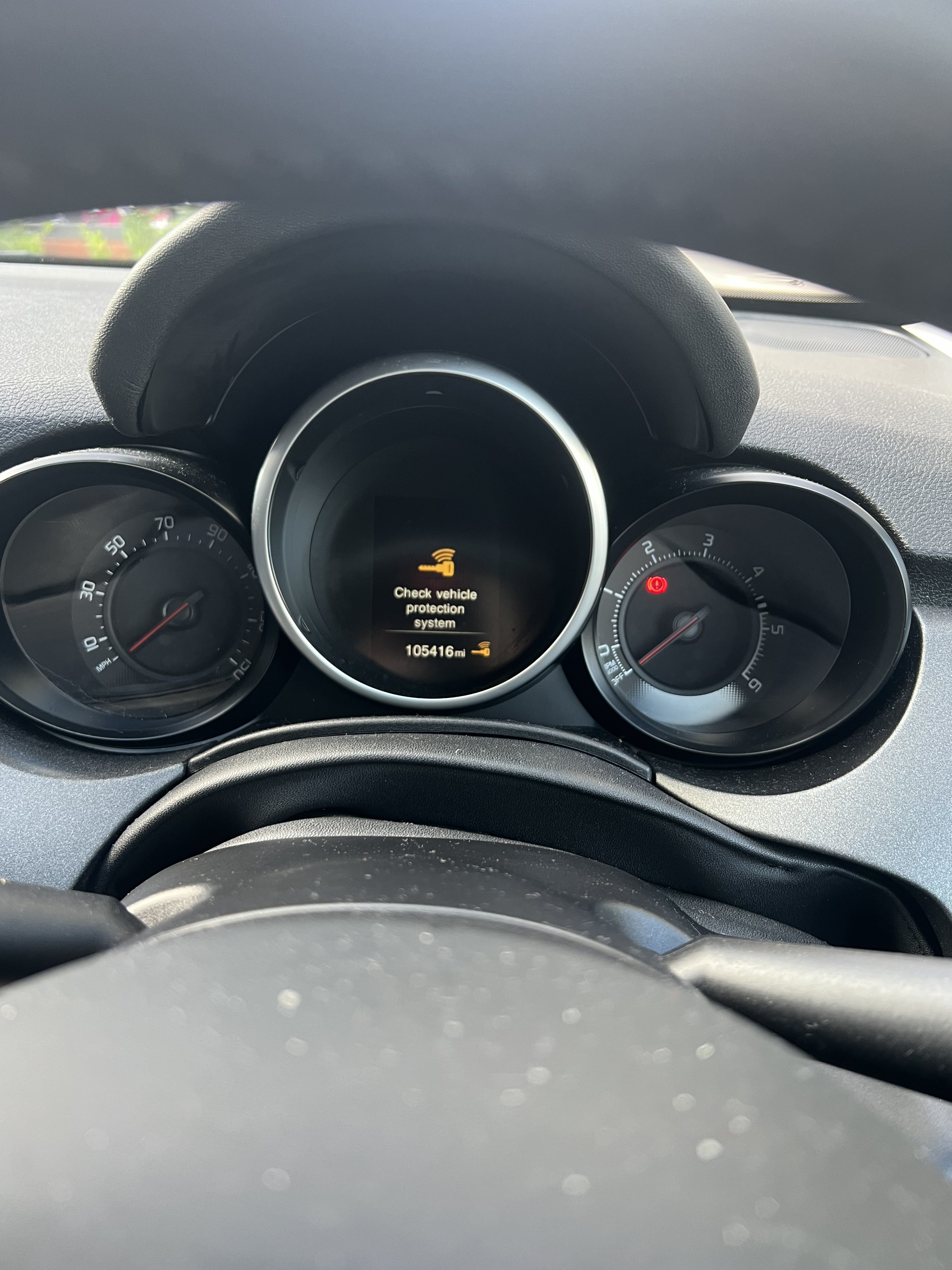

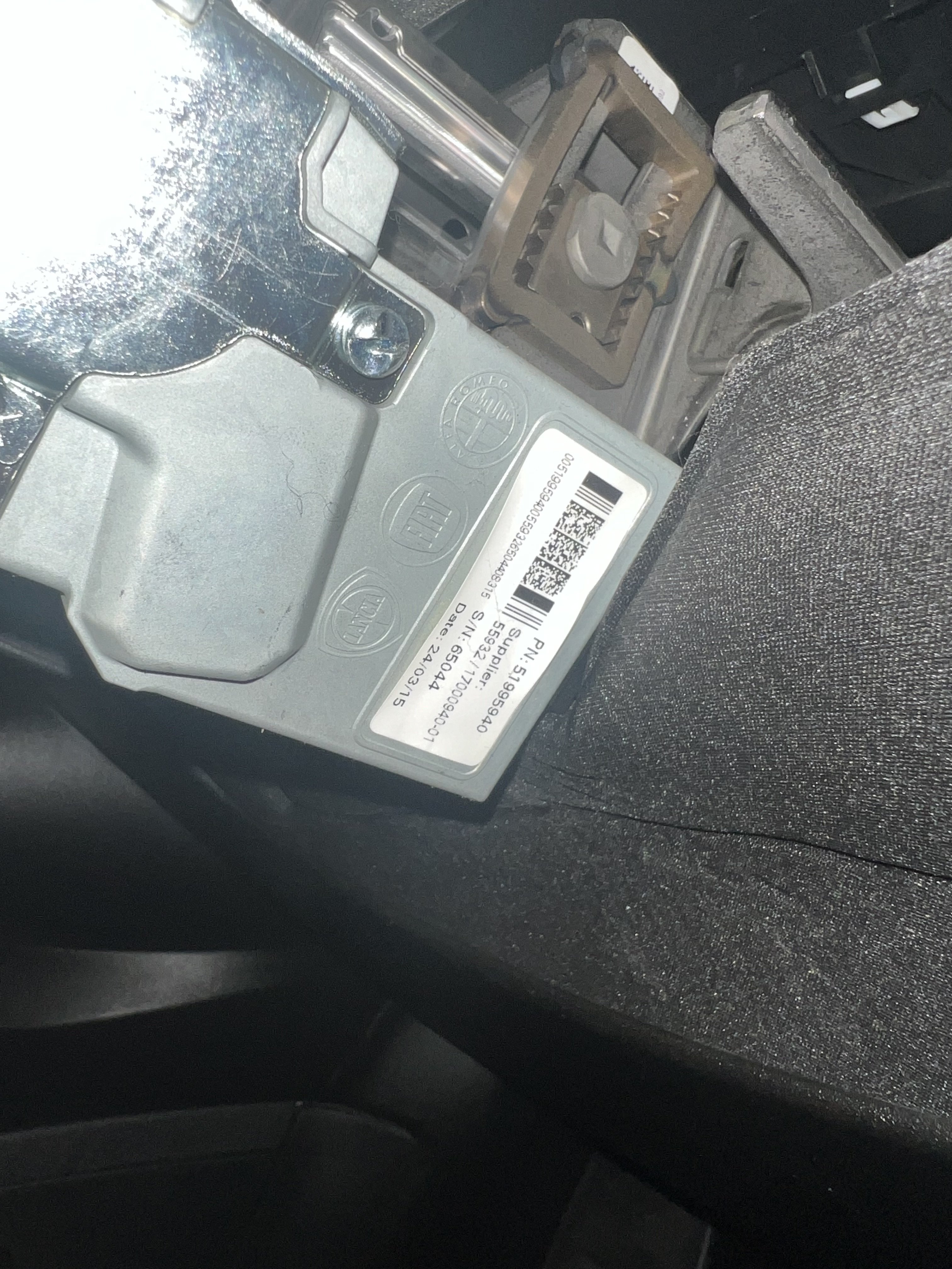

Hello everyone, I have a Fiat 500x keyless and the immobiliser is not letting me to star my car , is saying to move the steering wheel but it get blocked and ia not moving! I just called The AA, but maybe you can help me before they answer back. I have 1 h since I’m trying to start it. And also if you can tell me a garage where can I repair it in London.

Sometimes when the steering lock engages the wheels, due to caster, camber and road angles, leave excessive force on the steering column so that the lock mechanism/pin can not disengage.
Try forcing the steering wheel to a mid position between the lock clockwise/anticlockwise movement limits. This can be physically difficult as there will be no power steering assist. When you think you have the mid position press the Start/Stop button.
You may have to try several times.
Also can you hear the lock solenoid/motor operating?

Direksiyon kilidiyle ilgili bir sorun. Açma tuşuna basıp kolon kilidine çekiçle birkaç kez vurarak sorunu geçici olarak çözebilirsiniz. Bazen kapıların kapılarını çekmek de işe yarar.
