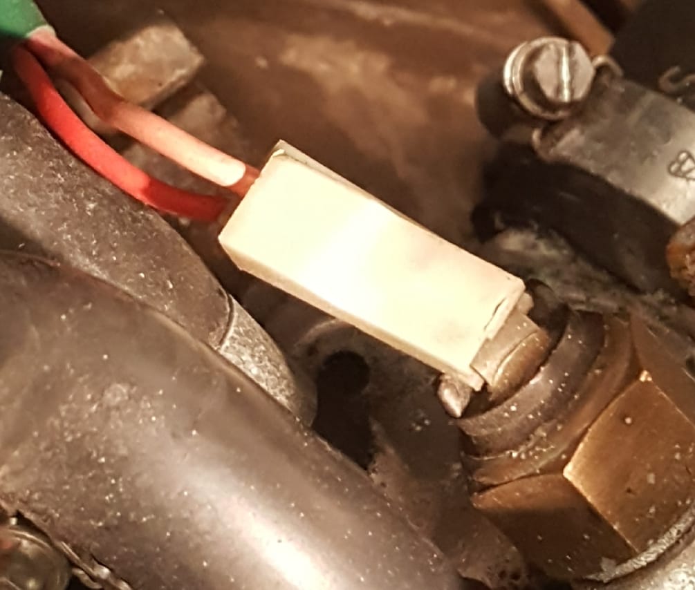

I asked an owner of a late model car. He has two pink wires too. The second pink feeds a thermoswitch on the thermostat housing, which then feeds the autochoke on the carb via a red wire. Thus the autochoke gets electric heating until the coolant gets up to temperature, along with regular coolant heating.
Wow! Really? I’ll have to check mine out, always wonderd what the red wire to the choke housing was for....
i cant see any reference in the extended Haynes manual. Mine's a 1987 car and it doesn't ring a bell: i can;t see where my extra green (not pink!) wire goes.
Can either of you post pictures of where the wire enters the auto-choke mechanism, please?
cheers
RDS
These photos are a Gran Finale model. The owner "Bert" prides himself on keeping his car pristine and absolutely as it came out of the factory. I don't have a photo of the carb autochoke, but the red wire should go to the choke operating mechanism on the side of the carb, which looks like a can with two small coolant pipes attached to the end.
This doesn't help with the mystery green wire I'm afraid. I think you will just have to trace it to see where it goes!
