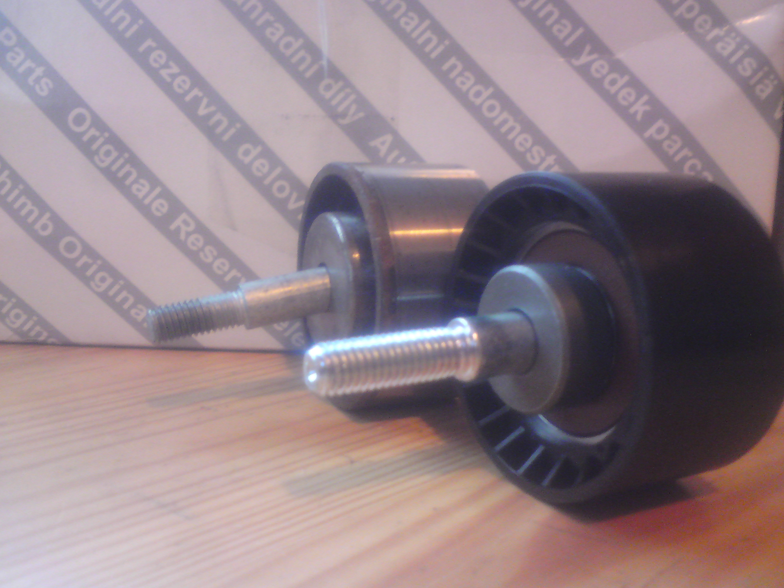

The dealers you've spoken to are partially correct, in that Fiat don't supply a timing belt kit for JTD 8v Stilos up to engine number 3646771 (fitted 15/05/2003). On ePER (the Fiat parts catalogue), this is shown as Modification number 6988. Items marked C6988 are up to that engine number and date, Items marked D6988 are for after it.
Item #15 (the kit), part number 71736726 is marked D6988, so is only suitable for the later engine numbers. The idler (item #3), the bolt (item #4) and the washer (item #12) are all different for before and after engine number 3646771.
As far as I can make out, you would need to buy the later bolt, part number 55190553, and the later washer, part number 55190554, to be able to use your new kit.

Is this the bolt you need. see attachment.

Just thought I'd complete the thread and upload a couple more photos of the old and new pulleys and bolts in case it helps anyone.
Thanks again to everyone who helped me get this sorted, my car is running like a dream :)
