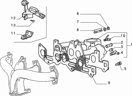

Does anyone have an ePER part number for the little blue connector that you replaced to fix the idle speed issue?
ePER isn't very clear on the diagram
Right I found it now :)
A question though - how did you manage to get it for just over a tenner when it is listed as about £40 on ePER?
First place I went was Fiat, they told me there were two possible options, one was about £45, the other £12. They couldn't tell me which was the one for my car so I went to a motor factors, much easier. There's still a choice of two, post no.15 of this thread explains the choice, but the dearest of the two is still only about £14 so I don't know where Fiat get 40 plus from :confused:.

Is the coolant temp sensor item 2,3 or 4 ?
naread.exe
Alex, no-one can see the picture in your post other than you. Save the picture (screen-grab probably) to your computer and upload using the manage attachments thing in the reply form.
