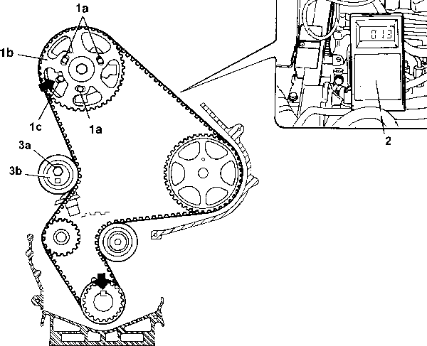

hello can any one help me with picture of the timing gear of the ducato 2,0 motor jdt:worship:
is this 2ltr petrol and what year?i have a 1989 ducato giving trouble .try to find an old school mechanic and from what im told the distributer unit can be loosened annd turnedby hand to adjust timing.
No I have 2,0l Diesel and the motor has wrong timing but I dont find the marks to check the timing so if some one has the marks please contact me (y)
Hi
Attached is a pic of the timing for a 1997cc JTD diesel but I think you will need the whole instructions for setting the timing which I will post in a word doc - attached, if you need more just email me, Not exactly straight forward!
