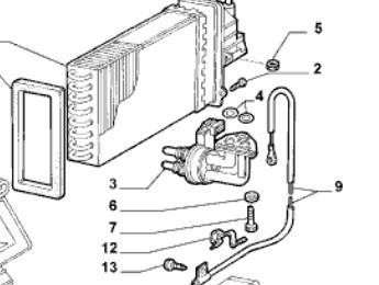

It almost makes sense in an older vehicle where the heater was controlled by a water valve but modern cars have the heater matrix in the circuit at all times, the heat being contolled by an air valve.

Found it on the parts CD:
