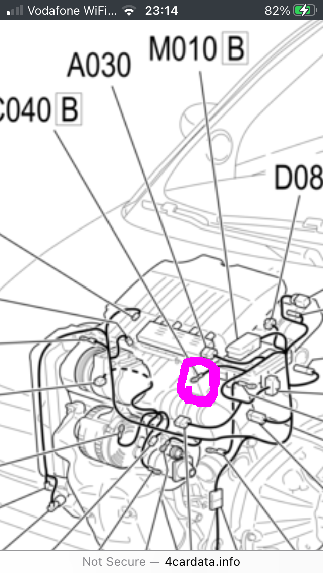

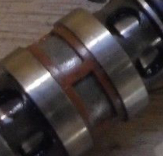

Have you looked at the VVT solenoid
The fine mesh grill can get clogged worth checking anyway as it’s only one bolt, easy to get to and a visual inspection
Flow would alter as the oil changes viscosity
It’s this mesh here and always on the side at the bottom that gets blocked

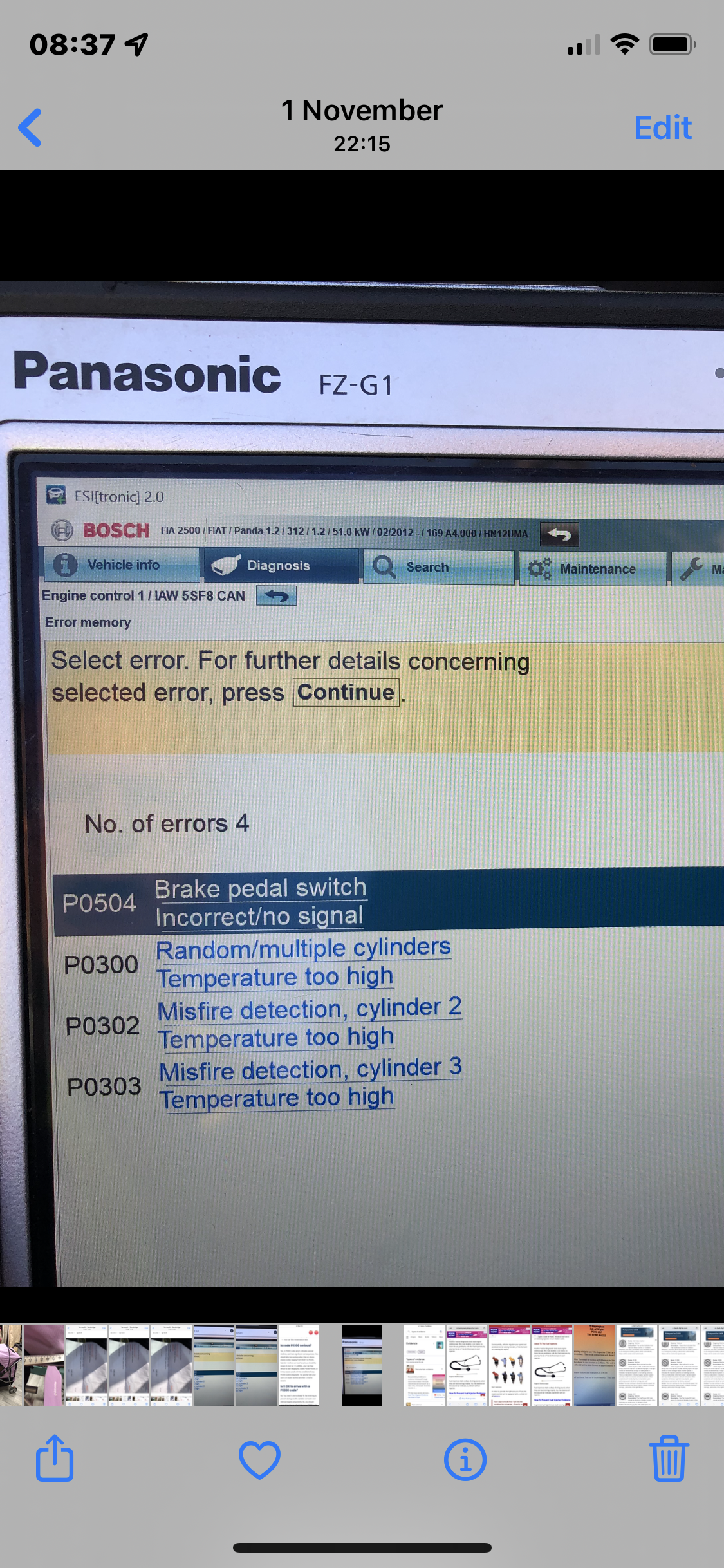

Hi, did you ever get to the bottom of this? The reason I’m asking is because I’m having the same problem with my fiat panda, 1.2 2012. Although the temperature outside and RPM etc makes no difference. It can happen a short or long distance from home. I’ve had two new coil packs and leads, but the intermittent fault persists.
It’s been to an electrical garage but they can’t get to the bottom of it either.
New timing belt this year.
I’ve attached the fault codes and engine misfire sound.
