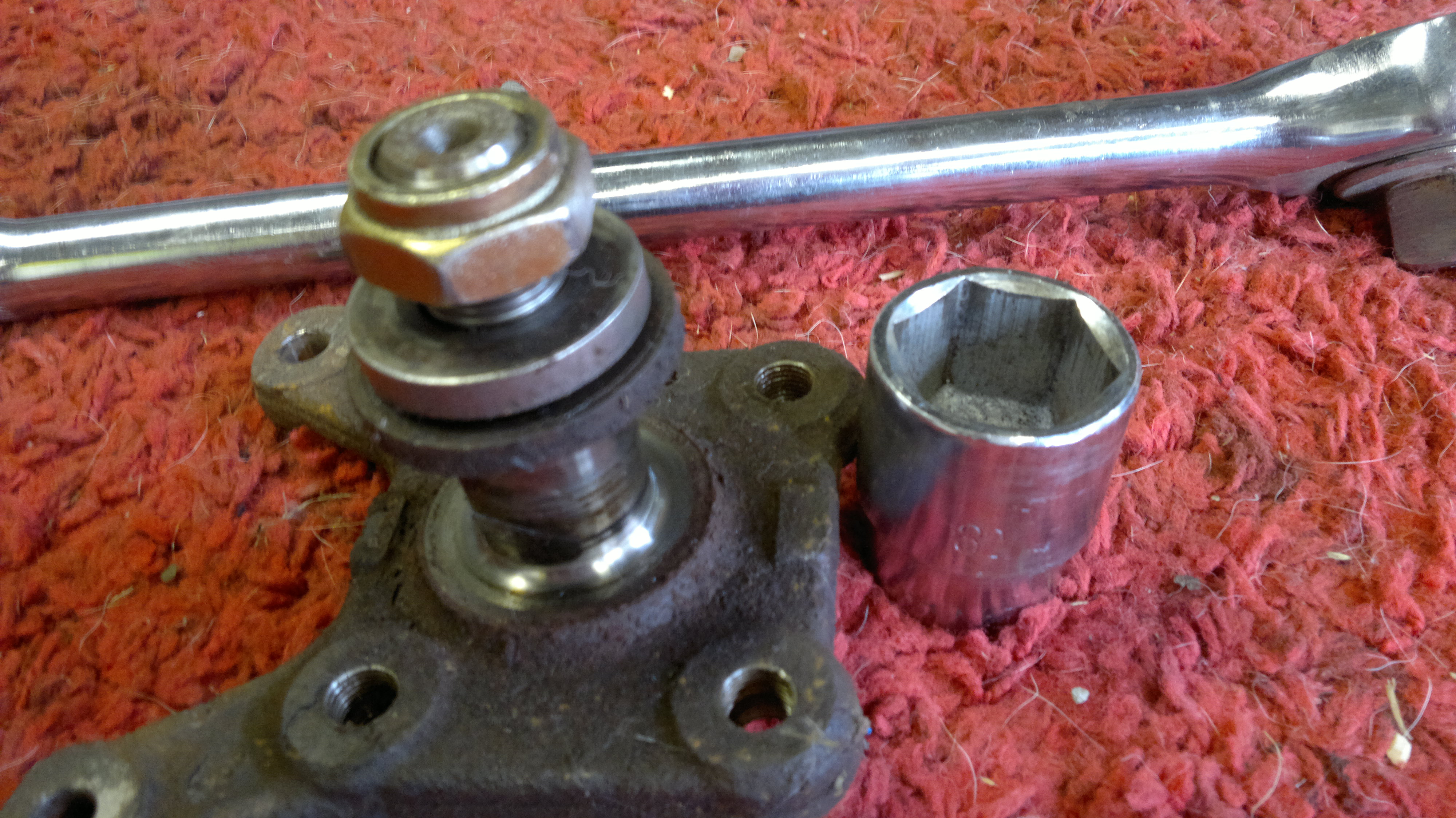

But the size of the nut on the rear of a 2004 Multiwagon is 32mm, not sure about the 3 and 5 door versions but I'd expect it to be the same.
Here's a couple of photo's of a 2004 Multiwagon rear stub shaft with nut and washers. Popped a 32mm socket on it just to check.
