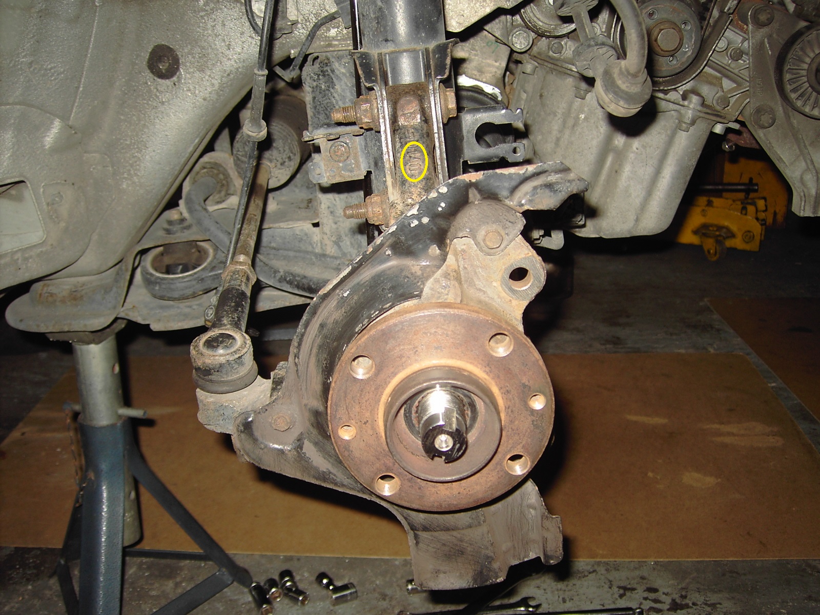

According to ePER, 50701140 fits some Bravos with the 1.9 JTD engine, but not all of them.
50701140 should have 140 (last 3 digits of the part number) moulded into the casting.

Thanks for that... it's most splendid.
I think I can just about make out a "140" on photos that a couple of breakers have posted for knuckles from Stilo 1.6's, so at least I know where to go if the one I've ordered doesn't fit.
The one I bought is on the way now though, so I can't check it... but hopefully it's not one of those parts that fits one particular model/year of Bravo but doesn't fit the 50 others that use a different part.. :D
