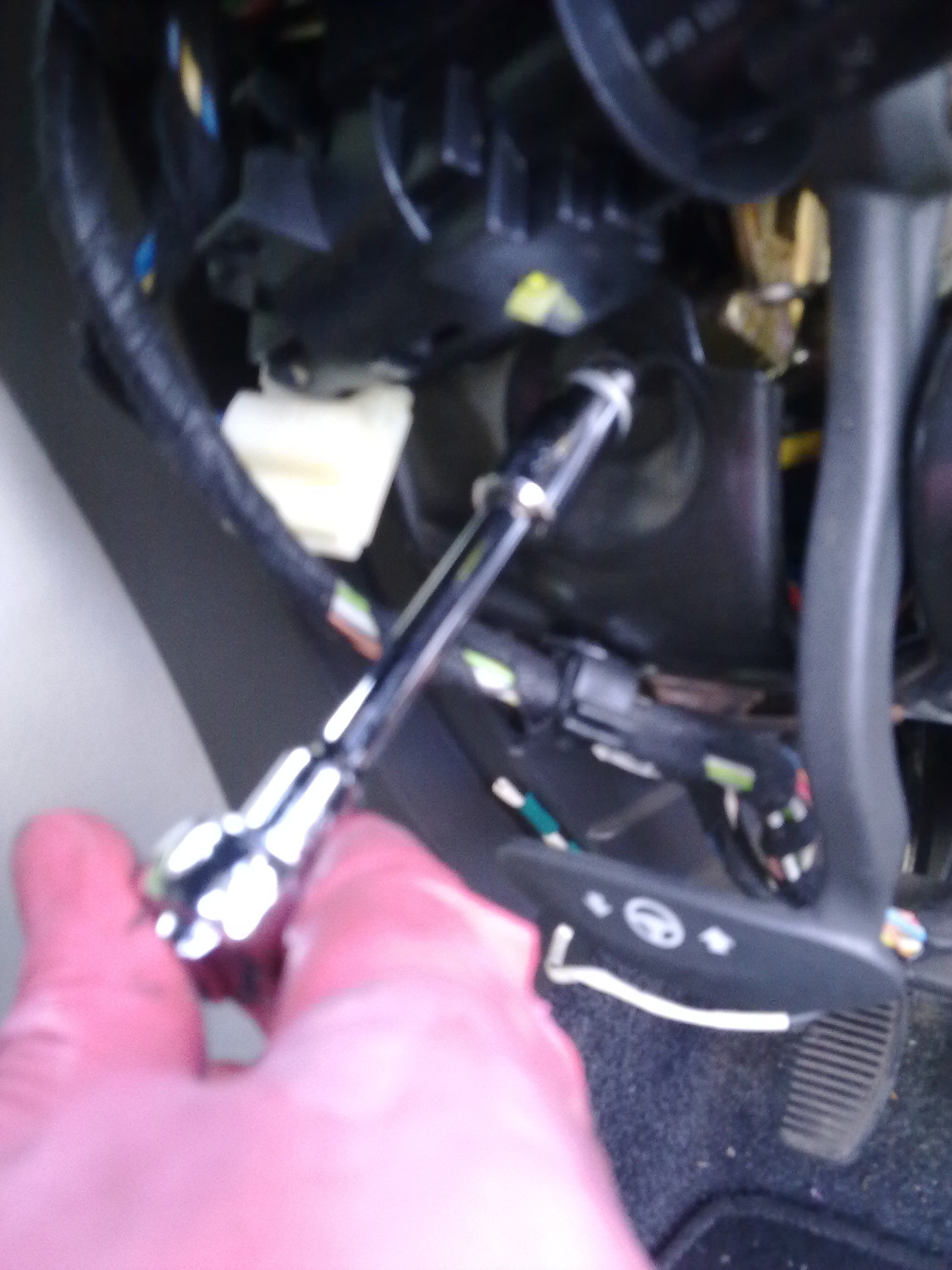

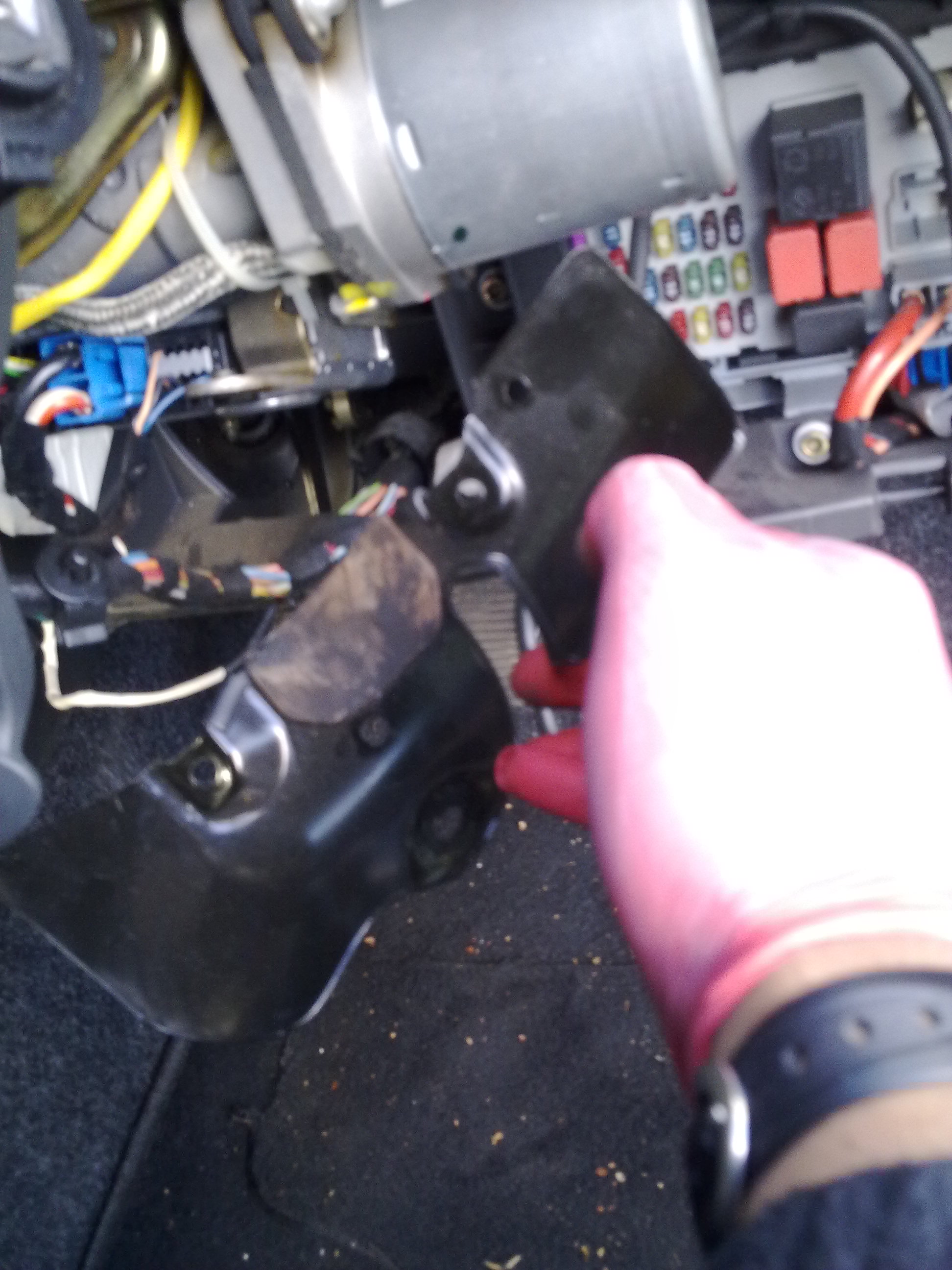

1. First, release the adjustable steering column lever at the base of the column to the 'down' position, then undo the bottom of the PAS columns plastic trim ensuring you keep the screws together once removed (Pic. 1).

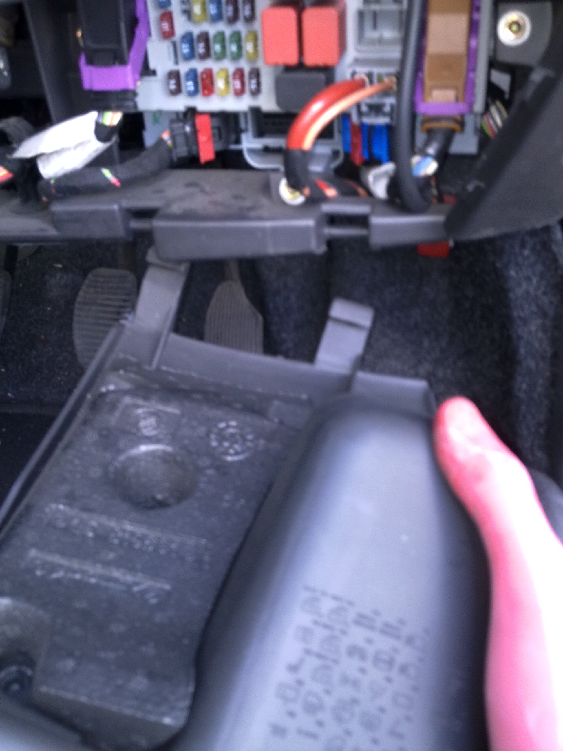

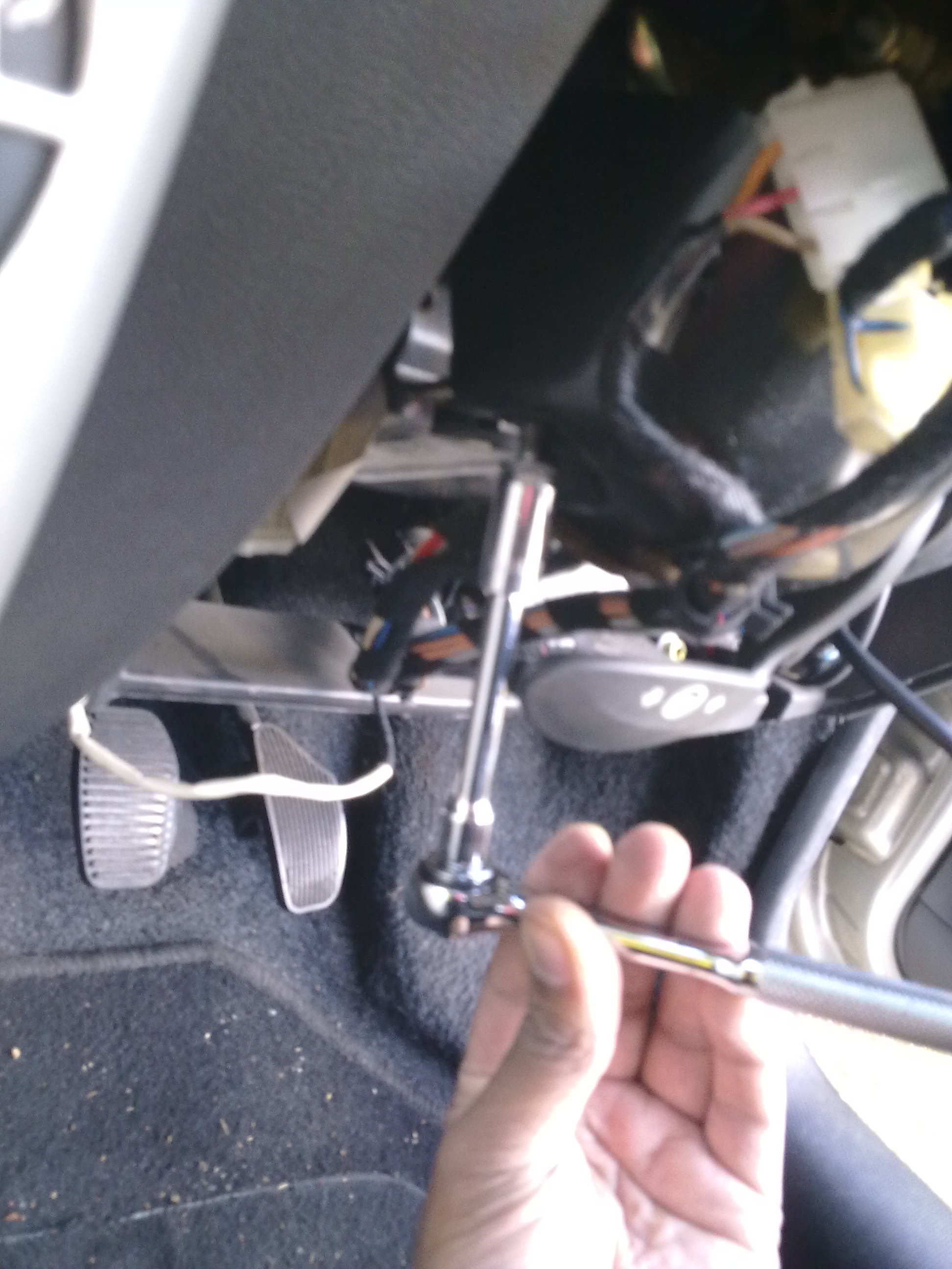

2. Remove trim that covers the interiors Fuse-Box (Pic. 2), taking care not to break the plastic hooks that are attached to the rungs below the Fuse-Box...

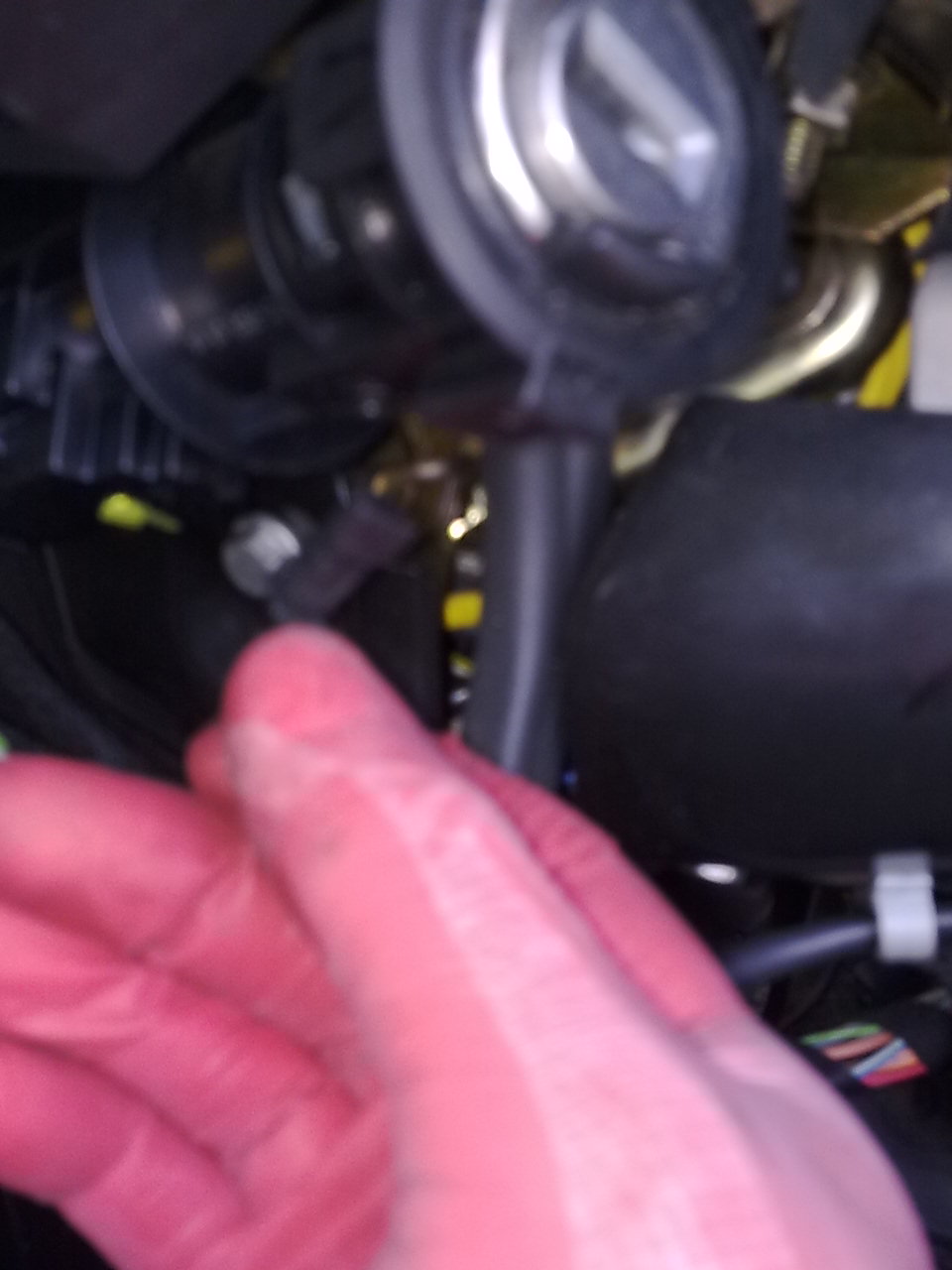

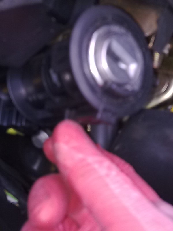

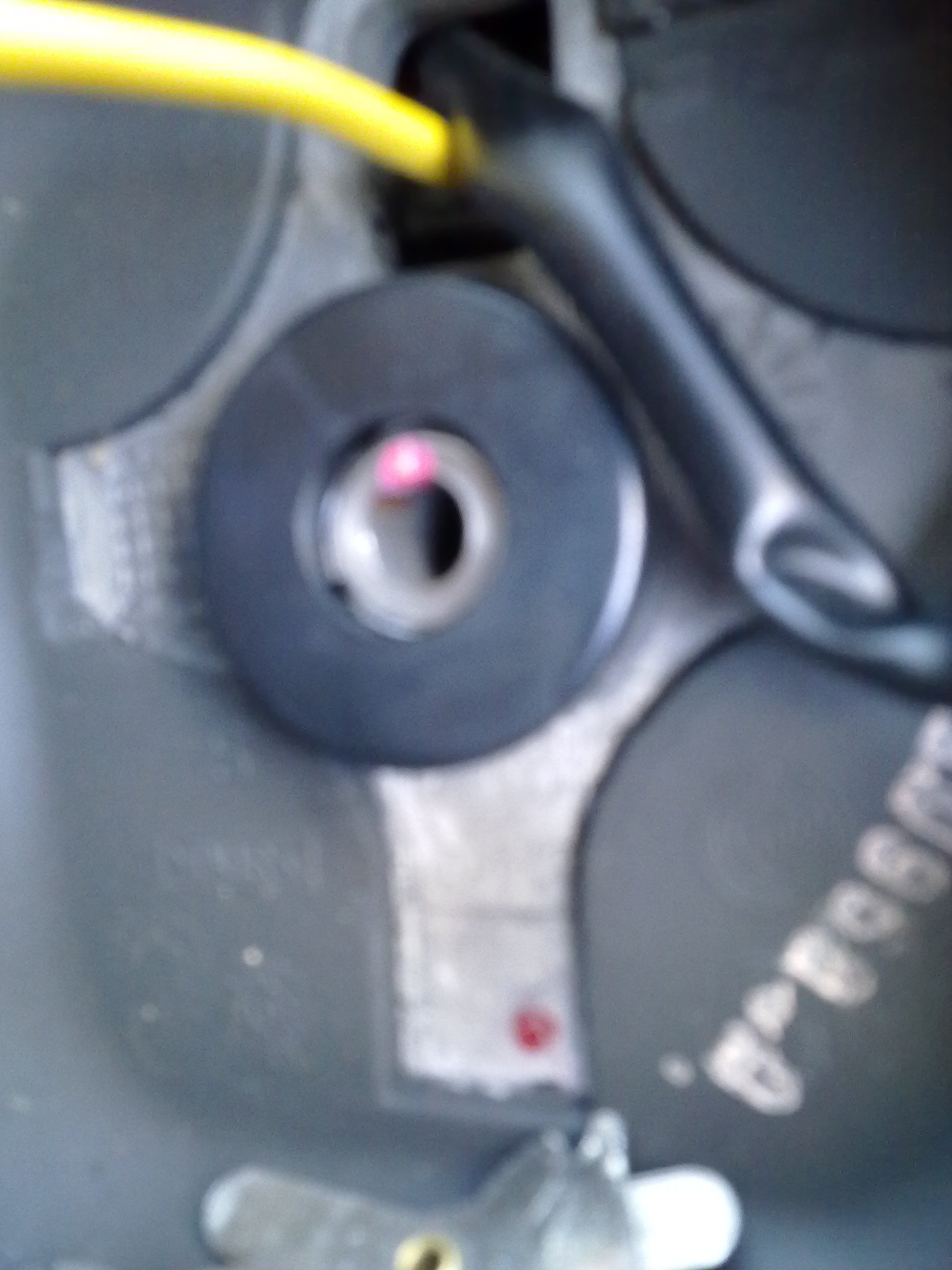

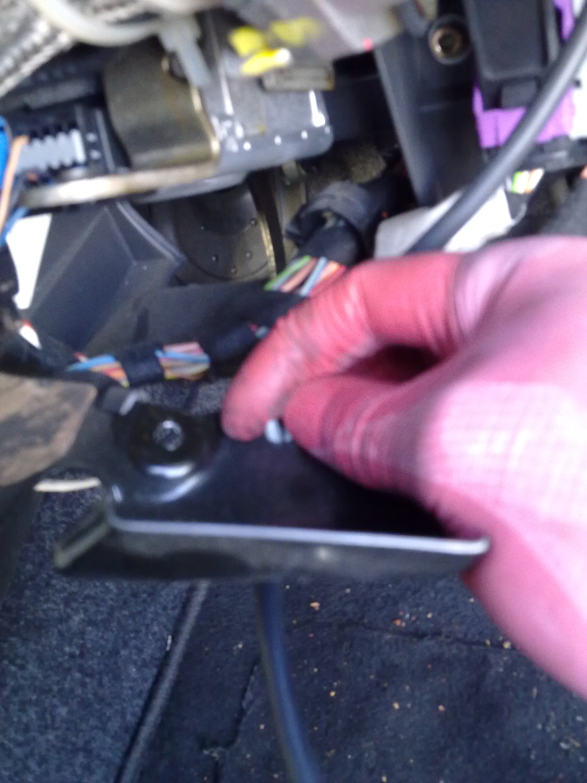

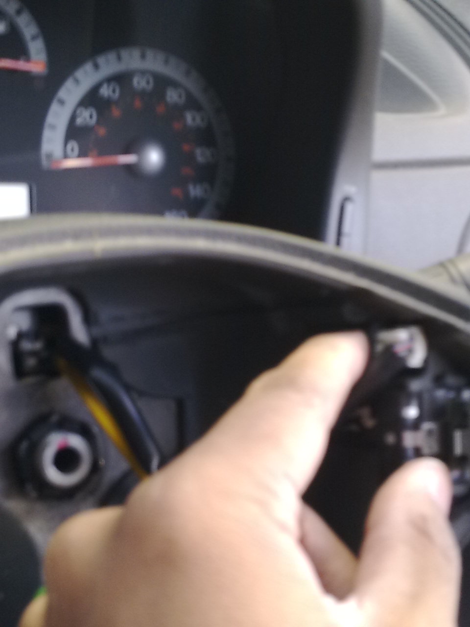

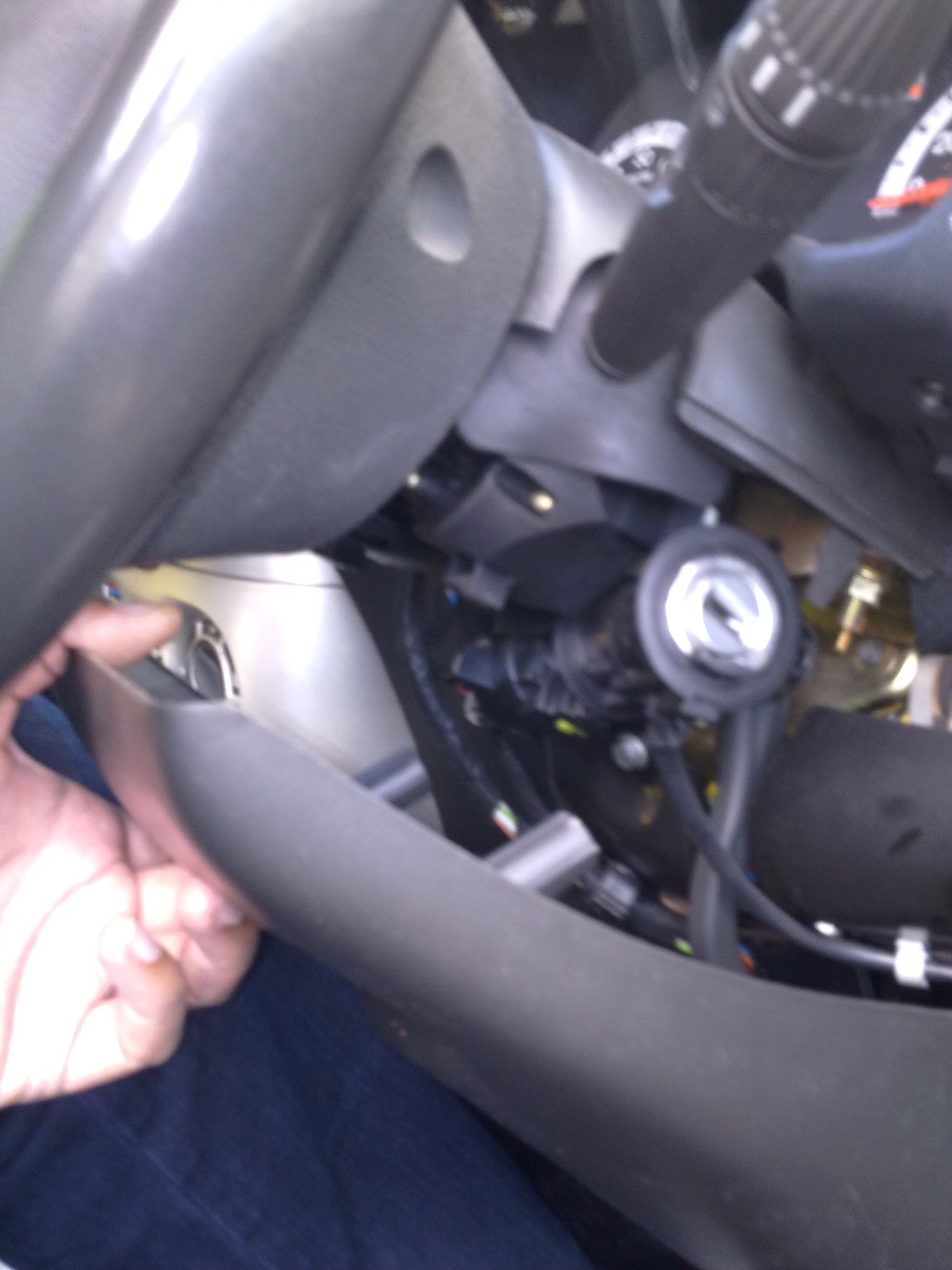

3. Then moving on to the ignition barrel (Pic. 3-6) carefully detach the connecting blocks from your ignition barrel taking note of where they go, if unsure don't be afraid to label them in a way you remember,
( I wrote on bits of masking tape to help me remember where things went).
Remember it's nothing to be ashamed of to label things up it's just good common sense! Otherwise you might end up in wire re-connecting Hell lol.

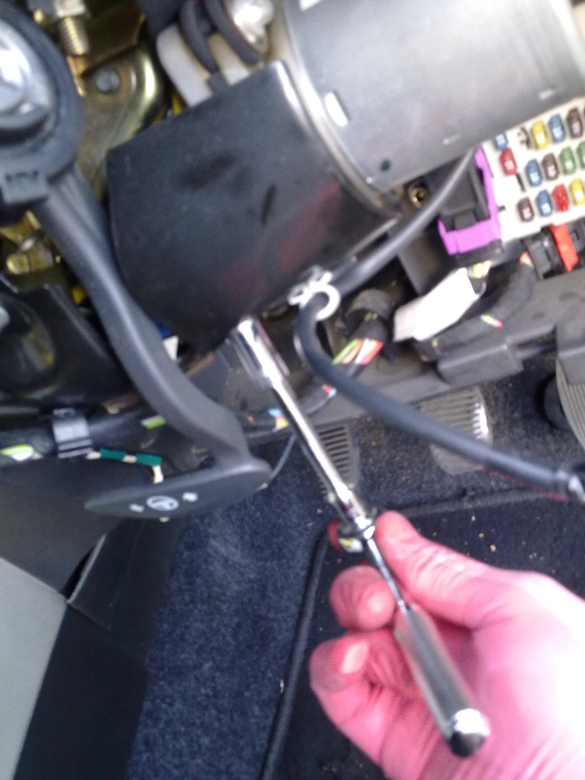

4. Next you'll see like a black metal casing on part of the base of the PAS column (Pic.7-9). Use your ratchet set or spanners to remove this...

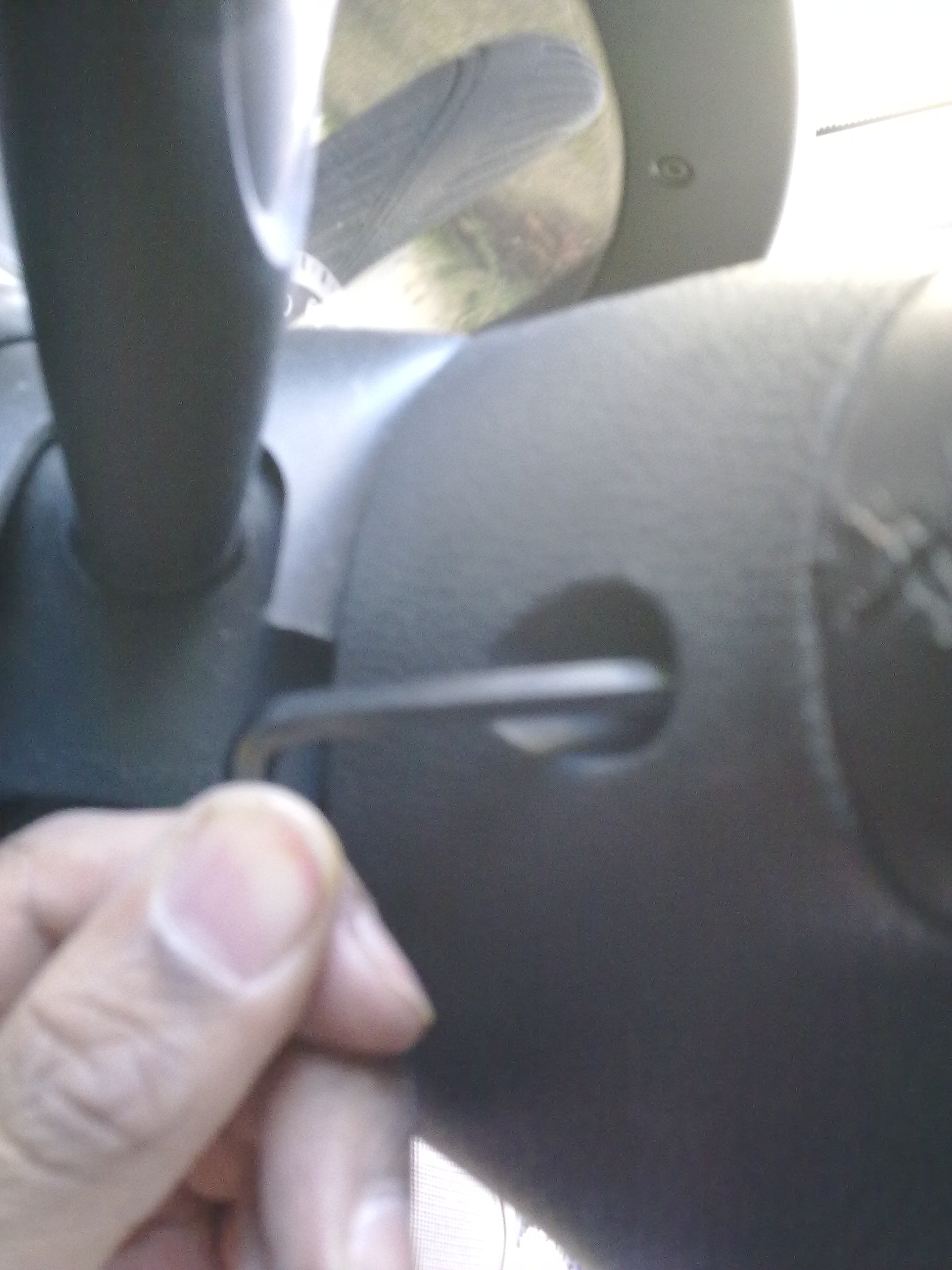

6. Moving to the Steering Wheel, grab your Hex tool and start loosening the bolts housed on the back of the Steering Wheel (Pic.13-15), taking note of how tight the bolts are screwed in as you need to know how tight they went on when you re-attach it...

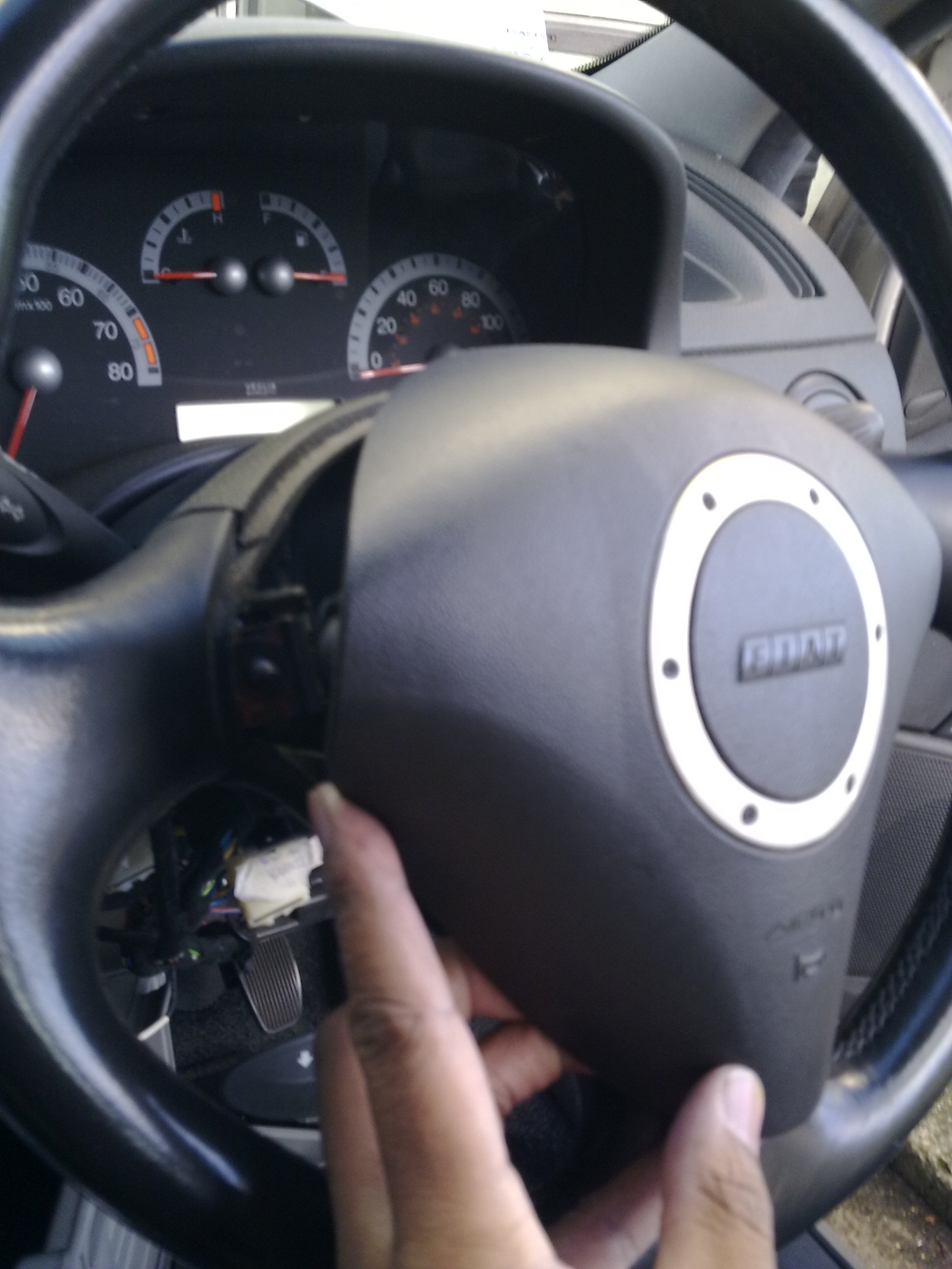

7. Once you have done this you should find that the central part (Horn) can come off (Pic. 16).

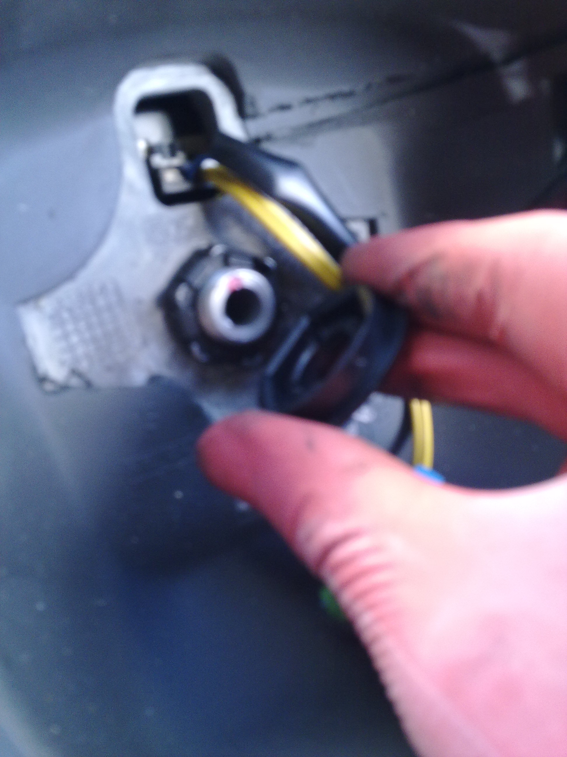

BE VERY CAREFUL AT THIS POINT AS THIS IS WHERE YOUR AIR-BAG UNIT IS HOUSED SO PLEASE TAKE CARE AND ATTENTION WHEN DETACHING, do it slowly don't yank it off !!!.

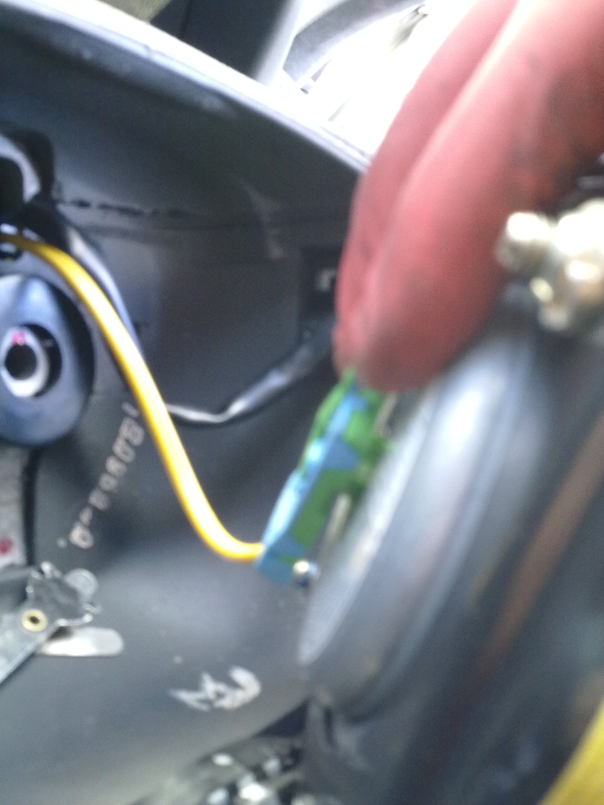

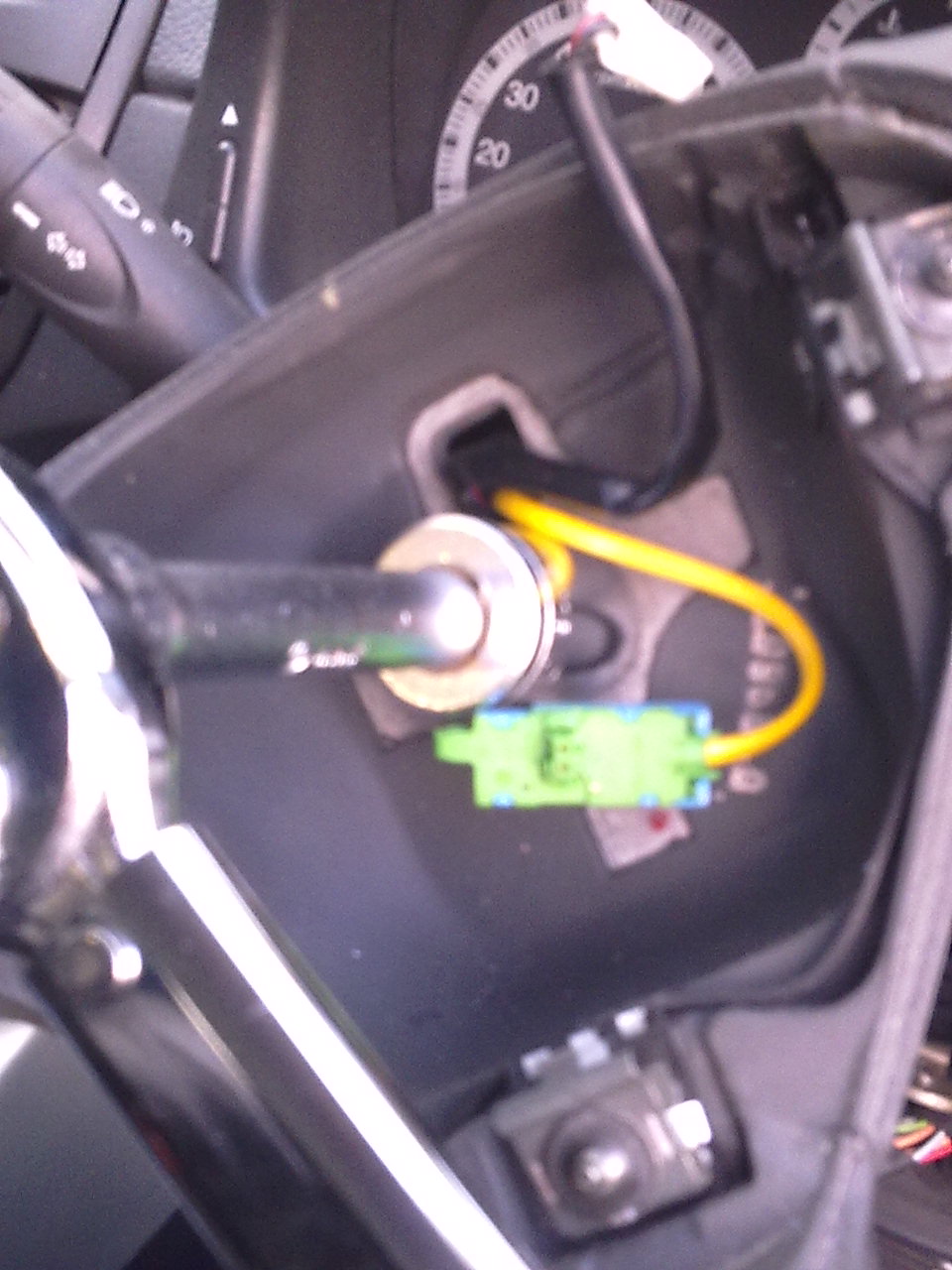

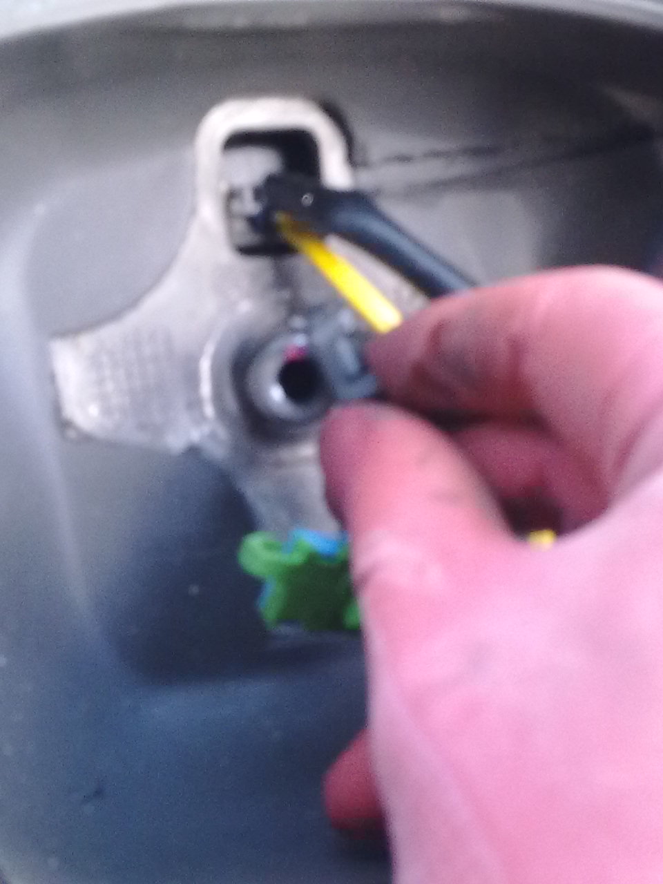

8. After slowly removing you'll see on the back a green coloured module (Pic. 17) attached to the centre of the horn/air-bag. Gently prise this off...
9. Next remove the metal plate covering the central Hex nut that is centrally seated on your Steering Wheel also detach black wire that is coming through your steering wheel from the connecting block inside the steering wheel (Pic. 18-20)
