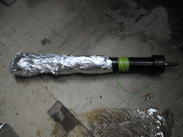

OK guys so if you read my thread will see this fantastic method of removing rust for virtually free is only suitable for dipping items but what happens if the rusty part is still on the car or to big to be dipped such as a rear axial , so I had another idea, check this out.
Take an old dishcloth, well it is old now !!!!
soak it in plenty of water and sprinkle on some baking powder or better still soak it in in a solution of baking powder and water, wrap it tight round the rusty part and then cover it in tin foil to make the other electrode, dont use to much current as the heat will evaporate the water and break the circuit and leave it overnight.
Have a look at the photos I tested this on the old rear shock absorber I replaced on my wifes punto evo as you can see after just 1 day most of the rust has dissapeared and you can see bare metal, the only downside appears to be as the dishcloth forms a barrier between the two electrodes the rust does not migrate to the other plate and has to be scrubbed off with clean water afterwards and of course you may have to to this more than once to get a perfect result.
Any parts not directly in contact with the dishcloth will not be de rusted.

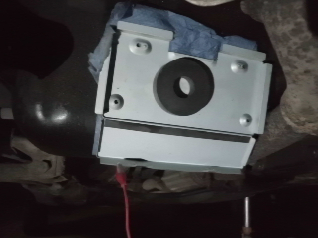

So here I had another idea, what happens if the item is flat and you cant wrap around ?
Same idea , this time I am using a flat piece of metal, soaked tissue paper and a powerful magnet out of an old magnatron to hold the plate tight on to a vertical surface, in this instance I am de rusting the sump on my newly acquired Fiat seicento .

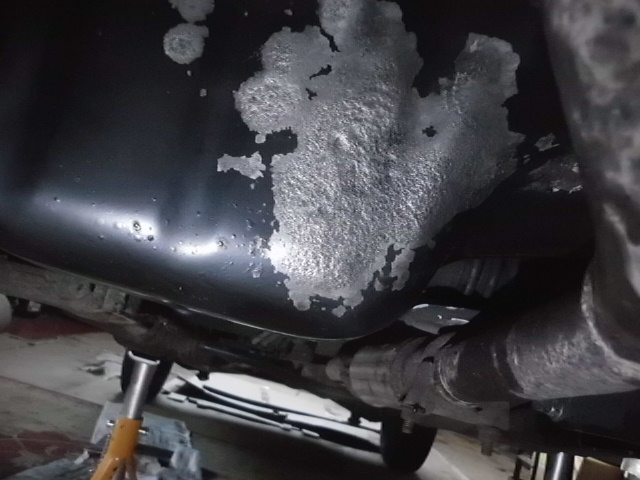

So after standing overnight and a good scrub off with clean water and then engine de greaser here is the result.
Rust can bee seen to have collected on the tissue paper .
