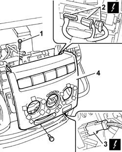

My 2004 Ducato 15 has a failed heater fan, the speed switch has been iffy for a while now, how do I remove the panel? I have removed the two torx screws at the bottom near the ashtray and also the ones near the windscreen in front of the lift up shelf ontop of the dash, but I can't seem to progress any further.

The radio needs to be removed to get the heater control panel off - 2 screws behind the radio face.
You need the tools to release tangs of the radio through those 4 holes on 2 each side of the radio.
Attached are some diagrams from the 244 eLearn on how it is put together & to R/R.

The tools are just 2 u shaped rods with chamfers on the two ends to push the tangs aside to free the radio, you can get them on eBay or just make them yourself. The eLearn can be downloaded from the Forum or from File factory.
