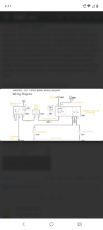

Hello. I have no front dipped and main lights on my 04 Ducato. Rear and side lights are fine. Checked all fuses and relays. Can’t seem to find a wiring diagram anywhere. Help.
This may help & is copied from this forum.
