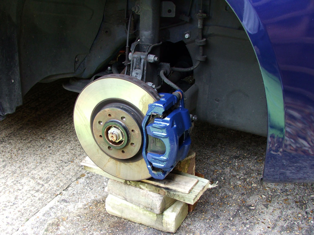

Here's a couple of pictures of my calipers I painted today as I wanted to keep myself busy because of all the crap with Fiat at the moment.
I took loads WIP of pictures and found it to be a time consuming be ultimately easy enough job as long as you take the time to do it right.
I used Hammerite Smooth which iirc was about £5 a tin and I used about a quarter of a tin in total for two coats.
I wasn't too sure about what colour to go for at first, but in the end I mixed two different blues to get something that matched the car and I think they turned out pretty good.

that looks really nice (y) does it just brush on? it looks to good to be brushed on?
Yeah mate, just brushed on. But don't follow the directions on the tin :) It says to recoat between 1-8 hours after the first. But I read somewhere on the net a while ago that when painting calipers with hammerite you should put the second coat on before the first one can harden completely and it worked fine for me :)
The paint 'flows' out after application, so you don't have brush strokes in the finish.

Ooo, I like! (y) Might have a go at this myself this week! ;) How did you prepare your calipers? Just a wire brush and de-greasant job?

Step By Step Guide to how Koa painted his Calipers.
Step 1: Jack car up and remove wheels. If you are using the jack included with the car, you might want to put a few bricks under the axle to be safe.
Step 2: Give the calipers a good spray with some brake cleaner or something similar.
Step 3: Use a wire brush to scrub off as much brake dust and muck as possible, constantly using the brake cleaner to help get rid of any stubborn muck.
Step 4: Wash the calipers off with hot soapy water,(we used Fairy Liquid) use with a good stiff paint brush combined with the wire brush for any more stubborn bits.
Step 5: Let calipers dry thoroughly and use a towel to assist in any hard to reach areas. when they are as clean as the image below, they are ready to paint.
Step 6: Stir the Hammerite, but not too vigorously. Using a small semi flexible paint brush, apply a thin layer to the caliper working from the top of each section, making sure only to paint non moving parts of the caliper.
Step 7: Apply a second coat after only 30-40 minutes regardless of what it says on the tin because if it is allowed to harden too much, the top layer will not take properly. Voila... Painted Calipers... (y)
