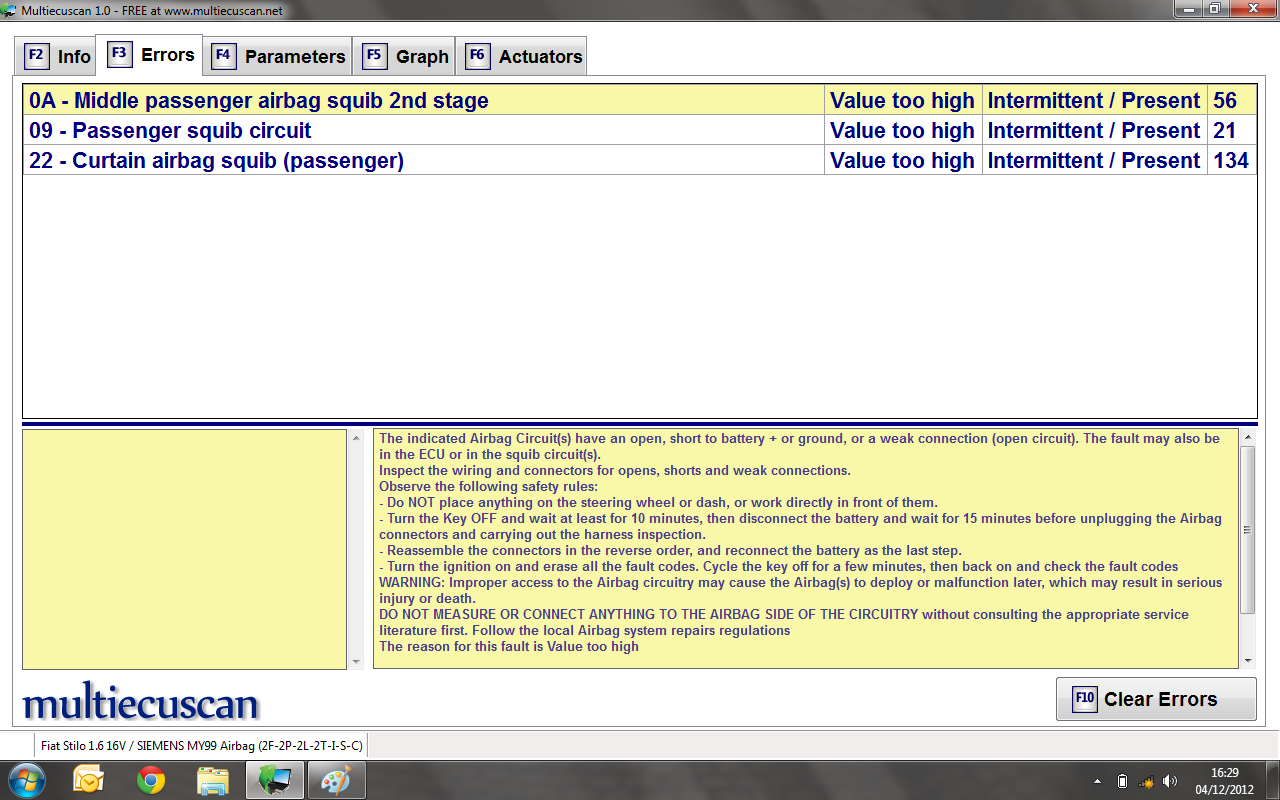

Hi friends,
As many of you and I have airbag problem with passenger seat.
I read a lot ot themes and now I'm so confused what to do.
I want ask you which is the correct sheme with resistors emulating occupied passenger seat and is there anything dangerous in this solving the problem?
Please help me.

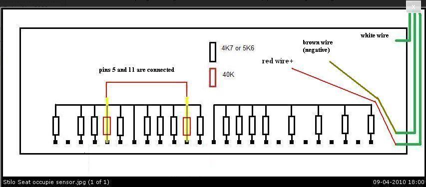

And what about this sheme?
Does anybody tried it?
Is there something dangerous if I make it?
What type of resistors are used here?
4700 or 5600 ohm resistors where the black squares are
40000 ohm where the red squares are (probably have to use a 39000 and a 1000 inline when i looked i could only find 39k or 41k)
try to get .1% or .05% resistors to ensure accuracy (purple or grey band respectively)
I too tried the diode/resistor mode didn't work I've just ordered the resistors now and I'll give that a try
resistor mod worked perfectly, OH very happy not to have the car beeping at her every time it starts, thanks everyone!
