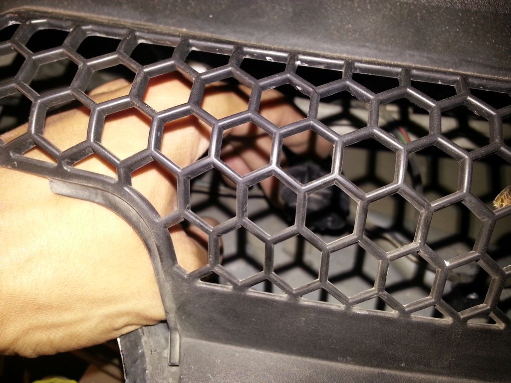

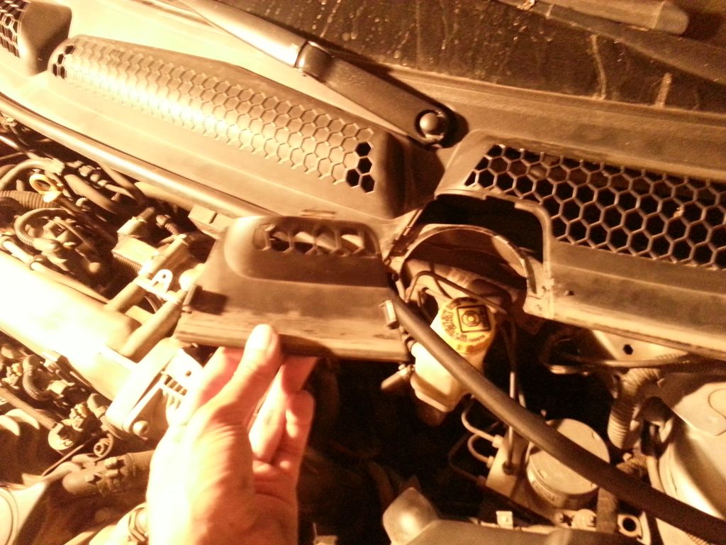

A lot of Bravos have a rattle behind the dashboard so here's a guide on how to fix the most probable cause for this issue. It's a 5 minute job and doesn't require any tools.
1. Inside the engine bay, locate a little removable cover on the right side of the trim covering the lower edge of the windscreen as shown on the pic.
2. Don't try to open it by force or with a screwdriver. Remove the rubber seal from the right so you can slide out the little cover easily.
3. Locate a loose plug inside the empty space as shown on the photo. That's the culprit.
4. Slide your hand slowly, be careful, the black plastic is quite sharp.
5. Grab the plug and pull it out.
6. Hang the plug on the edge of the opening and put the cover back over it.
7. Put the rubber seal back and you're done :)

Another option could be to wrap the connector in foam and stick it down with double sided Velcro?

I don't think it's a good idea as that space is for water drainage. anything you add there could just jam it and cause problems.
And why would you look for solutions that are more complicated?

The foam and double sided tape you want to add would come loose with water and then jam the conduit. Not the plug.
The wipers mechanism is also there and could get jammed.

Hi, I have this rattle on my 08 t-jet 150 but inside the space there is no plug. I've checked and doubled checked and it is not there. Is there anything else I can try to stop the rattle?
Thanks in advance, Sean.
