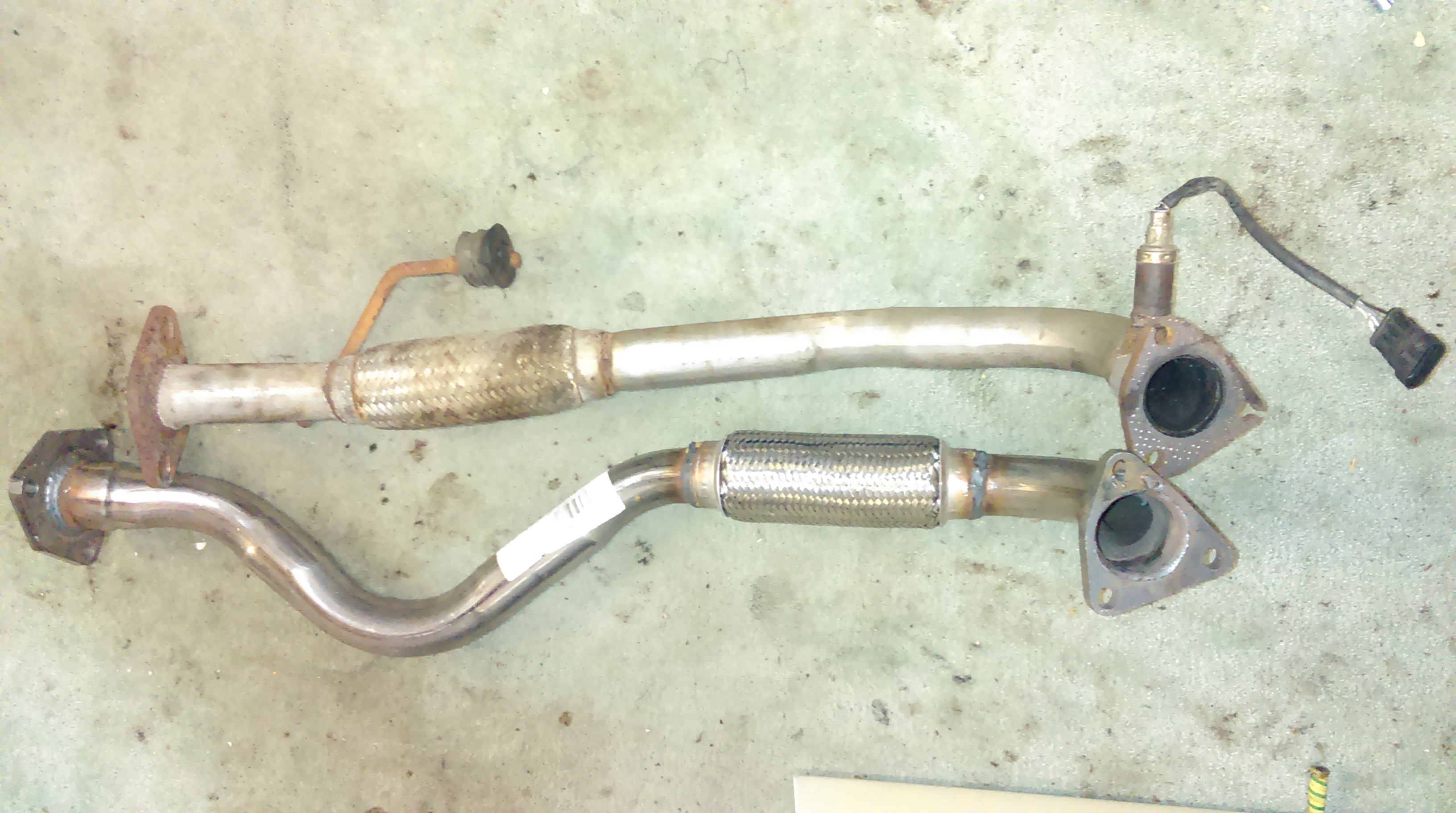

Thanks to panda-sport for the advice on downpipes -
The kink in the Brava/Bravo version clears the gear selector rods perfectly. But..
The triangular exit flange's top 'point' runs very close to the floor and the pipe diameter is going to make fitting the sump guard back on a challenge. We'll see, but I think the welder will need to come out.
As you say John.
The Brava/o pipe measures a few mm wider internally than the Punto version and the same externally.. so cheap pattern parts (£26) have thinner walls I'm concluding.
But if the sump guard won't go underneath it, then downpipes and sumps may become service parts following a bit of enthusiastic rough roading.
Also need a lambda boss - which could be fitted to the 4x4 version of course, but..
Anyone got a 4x4 downpipe handy and can be bothered to measure the internal pipe diameter for comparison?
umm i can tell you that the 2 pipes coming down are a few mm smaller in diameter than the putnto 75 twin down pipe... if that helps..
also for the lambda you could drill a hole towards the back where the 2 pipes meet and mount it there.
to get the threaded hole that a lambda, you could get one from off a scrap exhaust. it is what i have done for both Talon and Fallout.
as far as downpipes fouling the sump guard goes, it does take a little bit of bending, but... Talon is using a downpipe designed to go on a engine with a taller block so it sits very low (as i am still using talons original engine). i can safely say that if the exhaust down pipe has to be made 2cm taller, it will not hit the sump guard.
as for measurements.. i should be able to get them to you by tomorrow evening. i need to do a little bit of modding to Fallouts downpipe as i welded it in the wrong place.:rolleyes:
