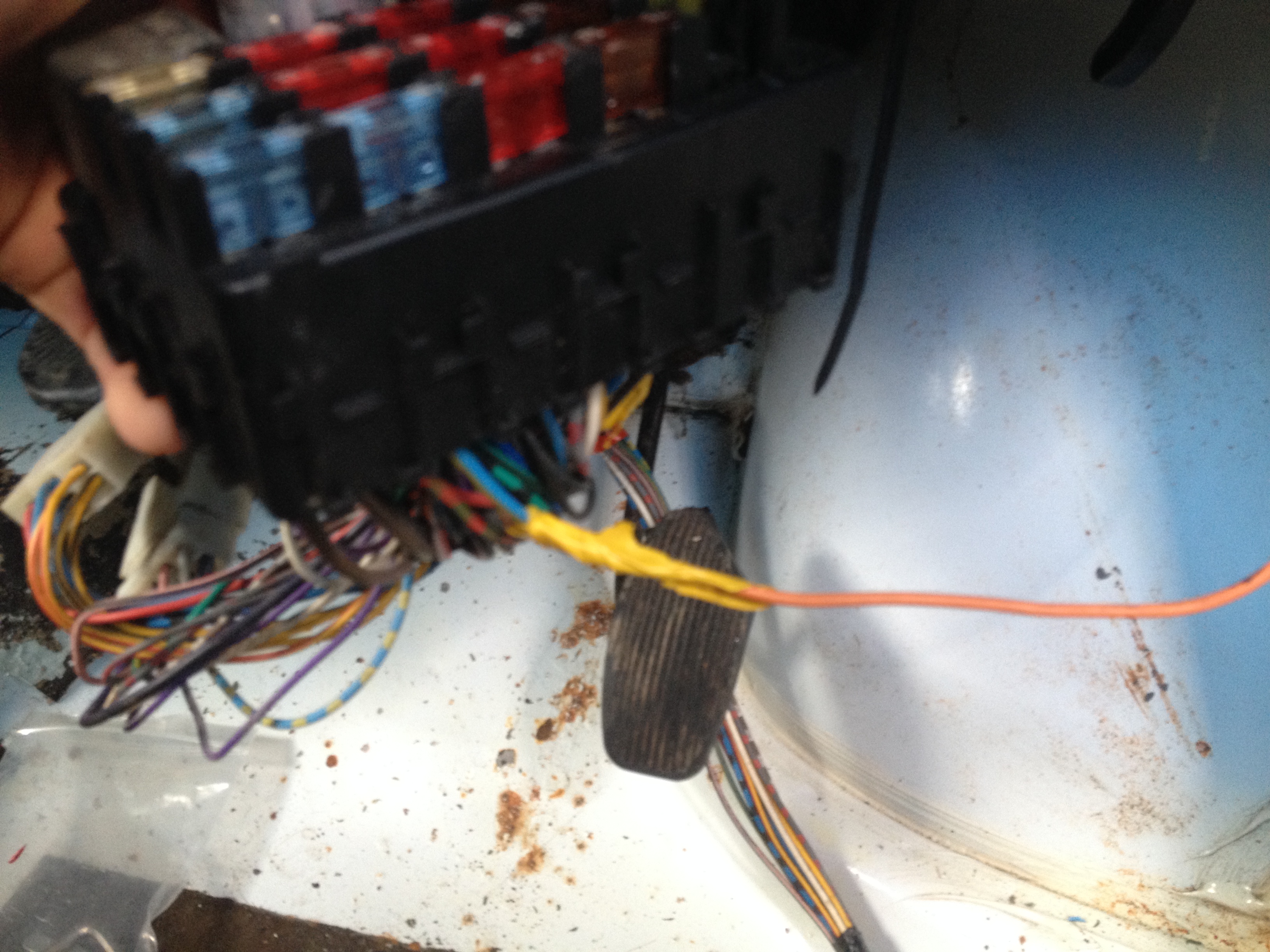

im getting the car to turn over just getting no spark at the plugs i think its because im missing my key reader!! but i did pay some1 to take the immobilizer off the ecu.. its starting to get to me

can you take some pics for me of exactly were iv got to spur red/black into panda and the orange wire plus the small blue/white out of code box were it gose thanks tom.
yes mate its a mk1 AND everthing is working but the only thing letting me down is i cant get no spark to any of the plugs because i dont no were to join the red/black wire to the panda loom and the orange wire were to join on panda ignition + spur to code box for both

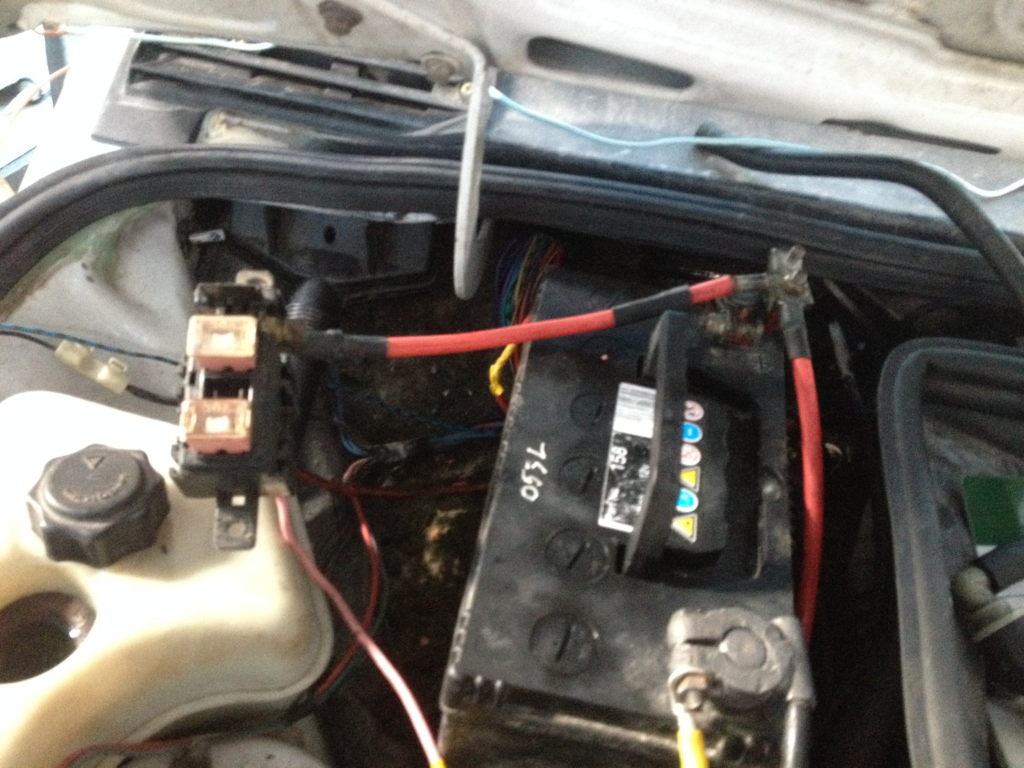

the red/black wire goes to the + terminal of the battery.
find ANY ignition live wire, and splice the ORANGE wire into that.
the blue/white wire connects to a light bulb. you can ignore this wire.
make sure that the original matching key for this new ECU and code box is held in place THROUGH the loop aerial with tape.. and make sure the loop aerial is connected to the code box.

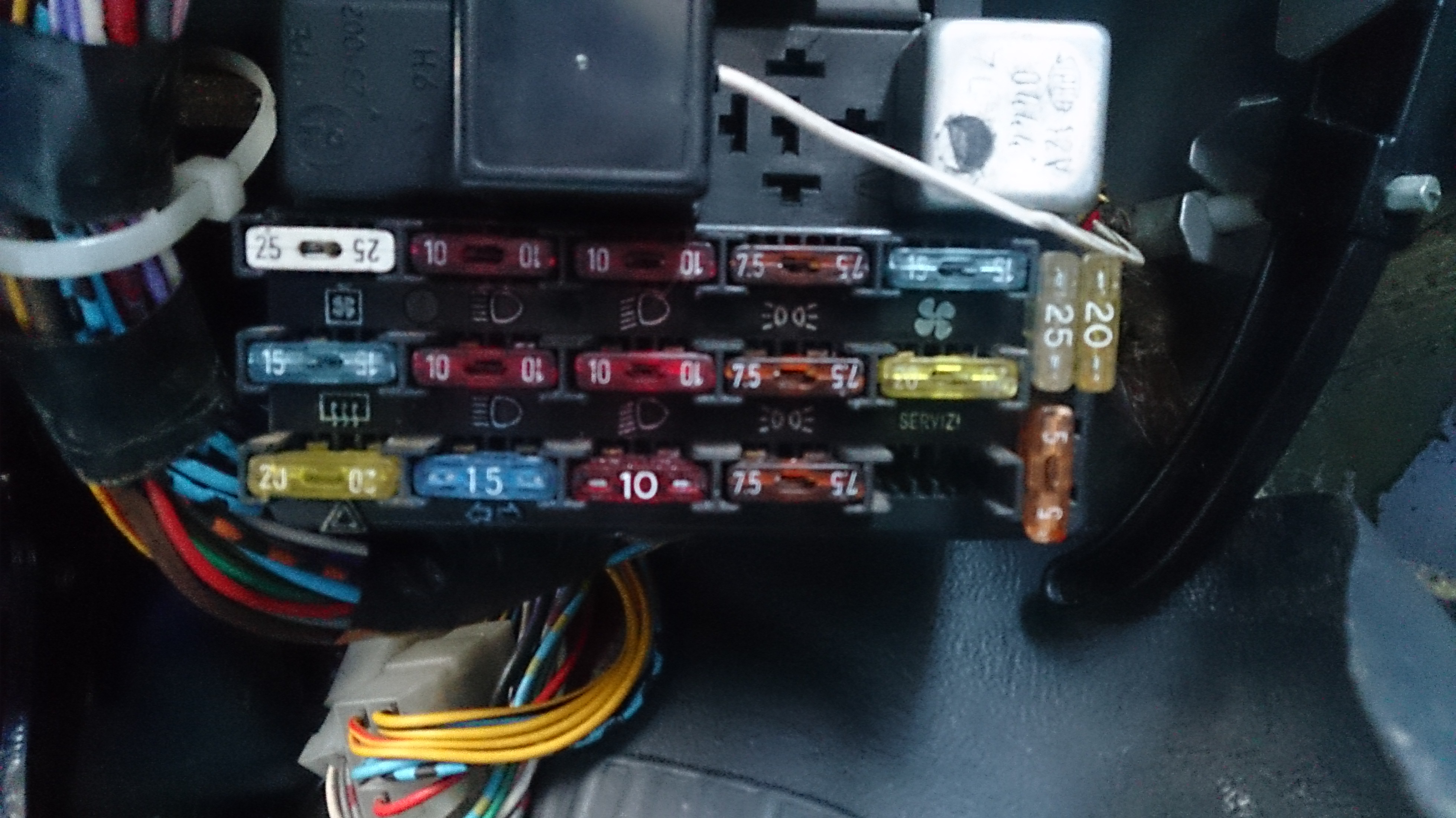

in fact.. here:
the bottom row, 2nd fuse along. a 15 amp fuse with a picture of the indicators (<-->) below it. this fuse has an ignition live feed it. Tap into that with your orange wire.
i hope this makes it more easy to understand :)
its a mod i had to do when my indicator relay stopped working. i didnt have the correct one to replace it with but had some others. i just found a 3 pin one that almost worked, then added the extra wire :ROFLMAO:
the white wire makes the turn signal bulb in the dash light up. it was hard to make it do it as the relay gives an output for left and right. not just one output the column switch then routes left or right.

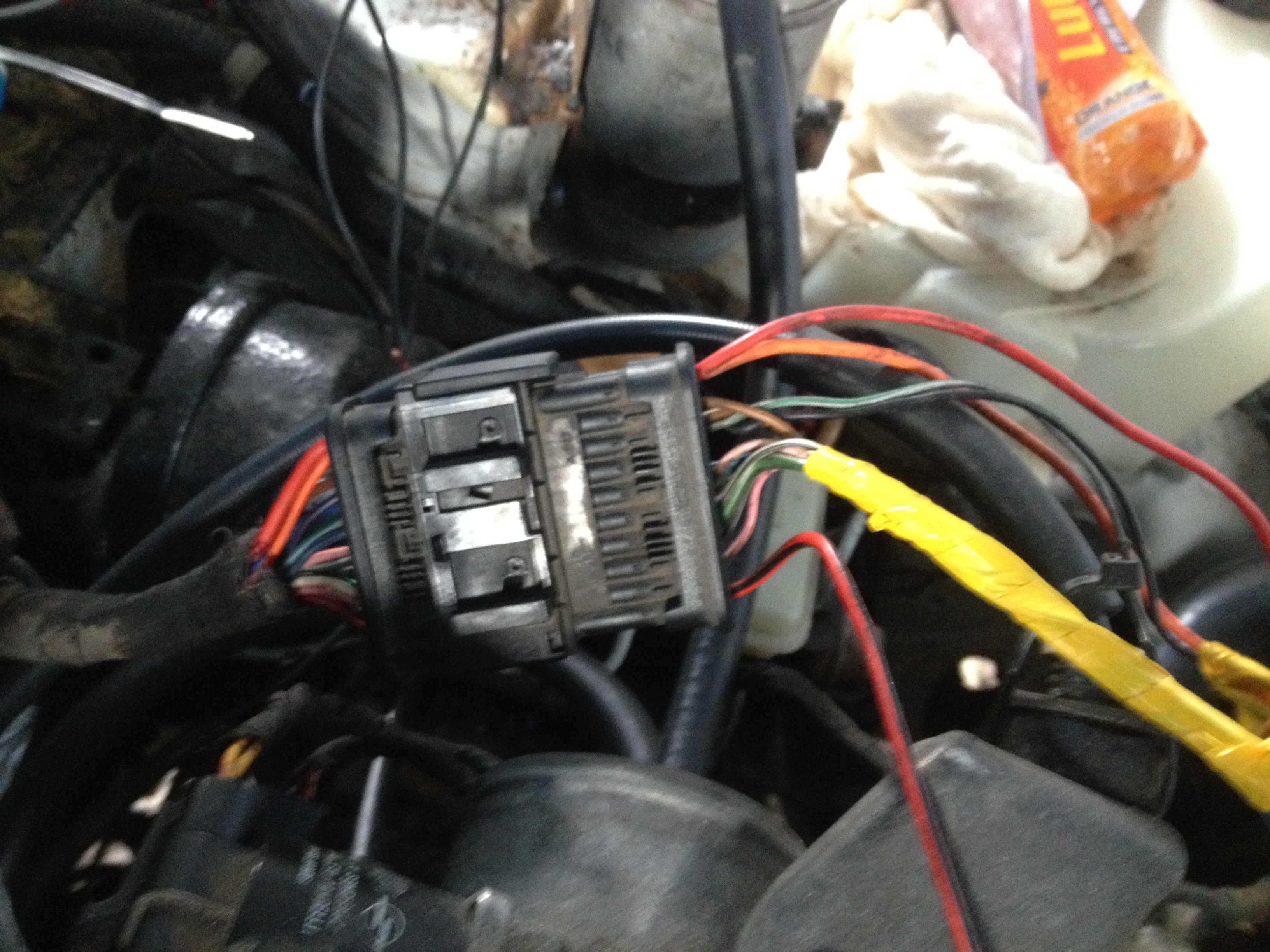

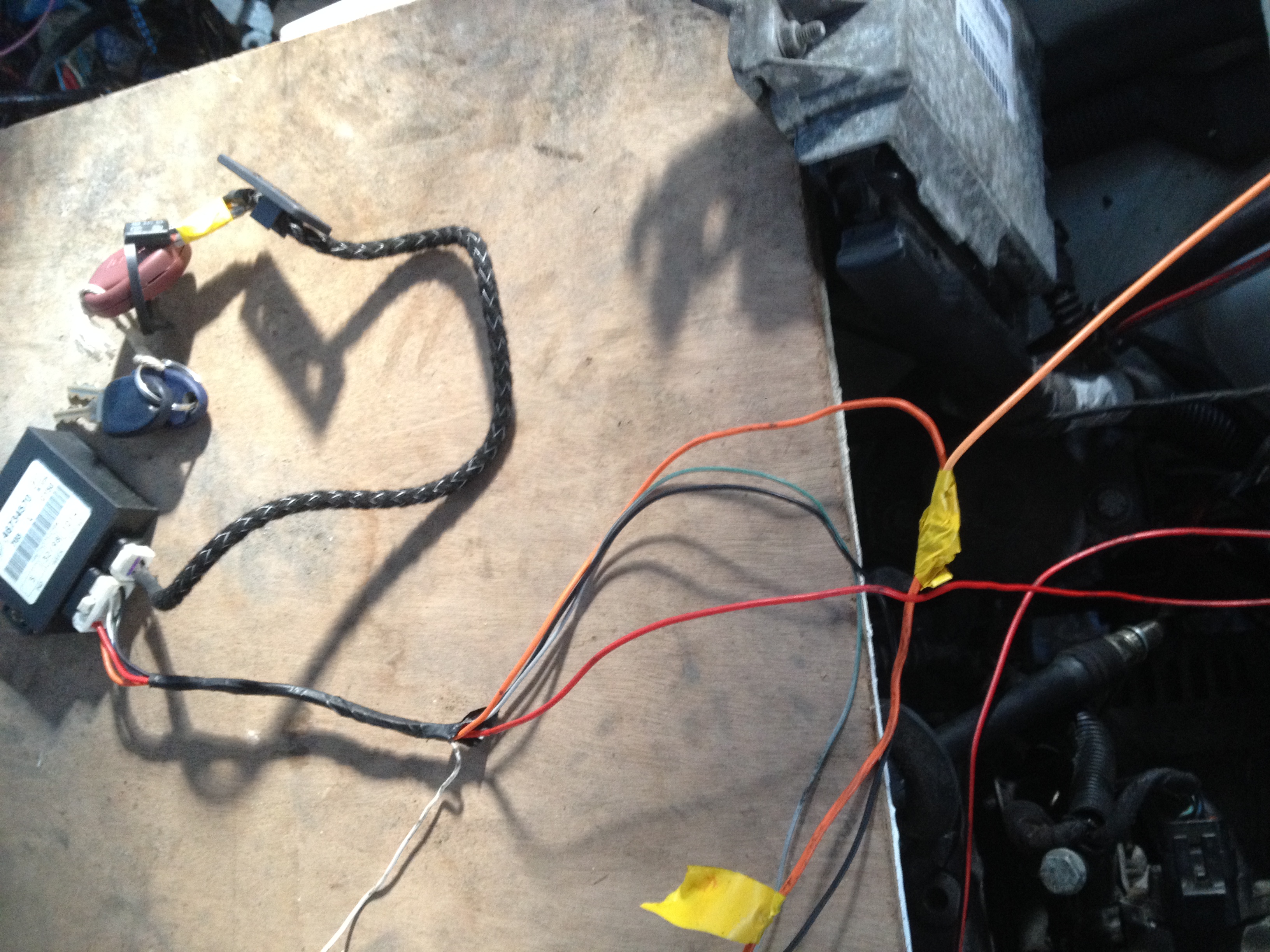

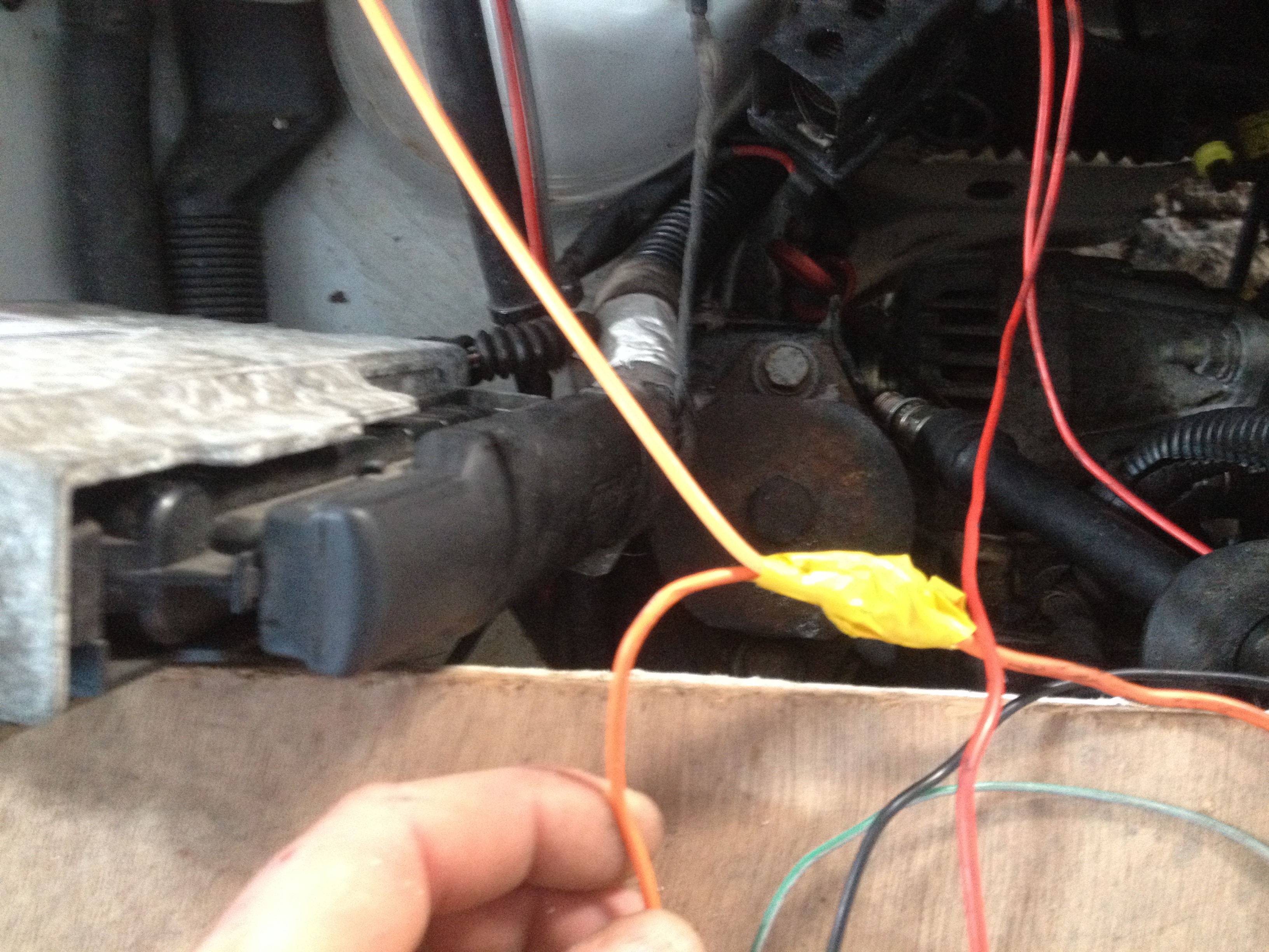

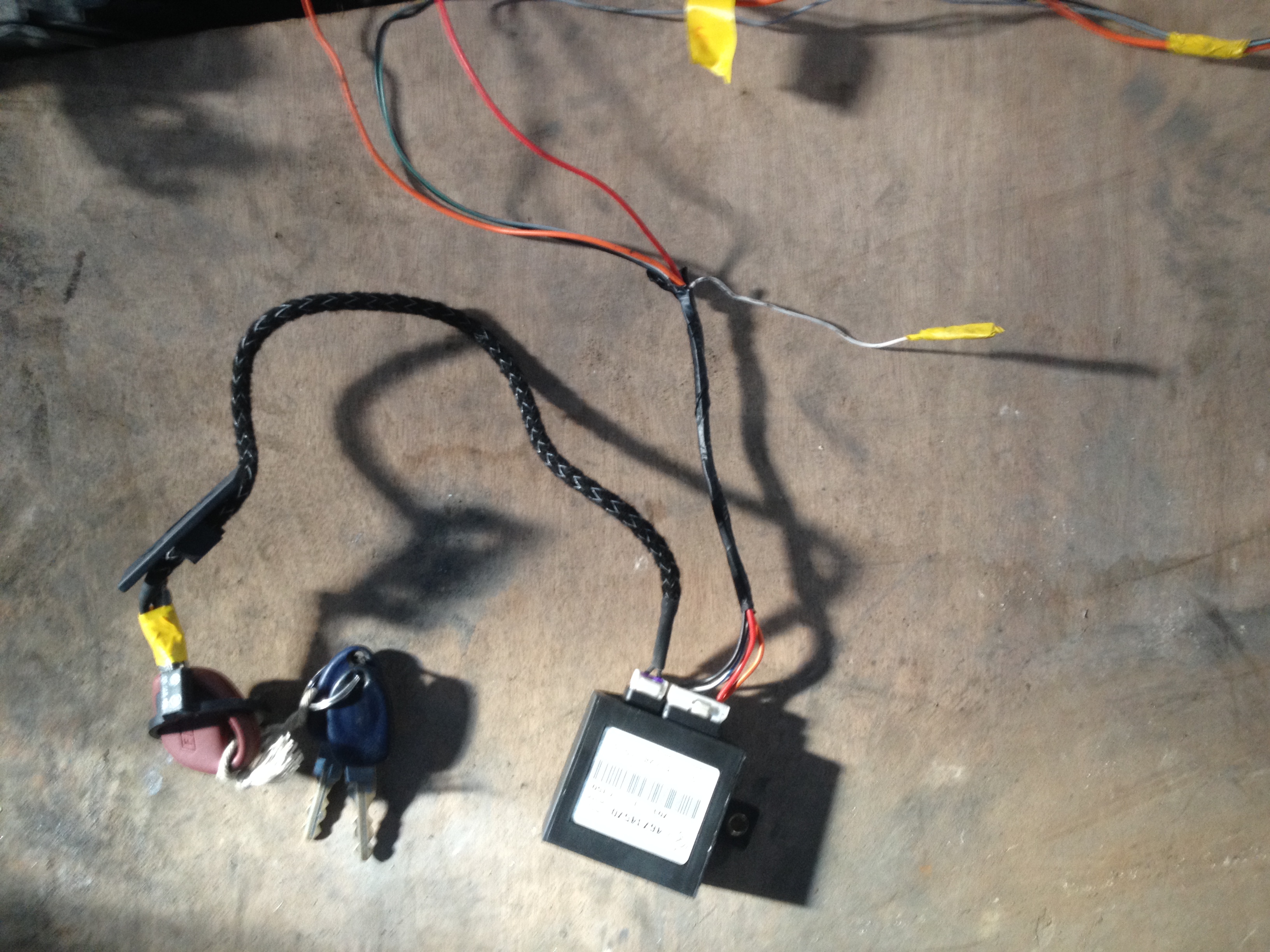

iv gone and tryed what you said and im still not getting any spark ????
am i spuring it right

hmm ok, well we could learn a lot by now attaching a bulb to that white/blue wire..
on a bulb you have 2 connections, connect one connection to the white/blue wire, and the other connection to a 12v+. make sure that the white/blue wire NEVER contacts the 12v+ wire as it will fry the code box.
i would use a festoon bulb, like the one that is above the rear view mirror.
doing this will tell us if the imobiliser is being lifted.
the light should flash with the key out of the ignition. when you switch the ignition on the light should come on solid for a second, then go off completely.
if the light stays on solid with the ignition on it means theres a fault reading the key.
try moving the key placement around a little. they can be fussy.
also this sounds daft, but have you made sure that the crank position sensor is connected. do you get any "sounds" when you now turn the ignition on? like the fuel pump? or any relay clicking?
i am not sure if the 16v engine has them but i know on mine i have 2x purple relays and some fuses. make sure they are all ok if you have them.
i know some just have one white relay and a fuse. i know if the relay is not clipped in correctly it can also cause issues. also check the fuse too.. pull it out and push it back in again. fuses not making good contacts are quite common.
