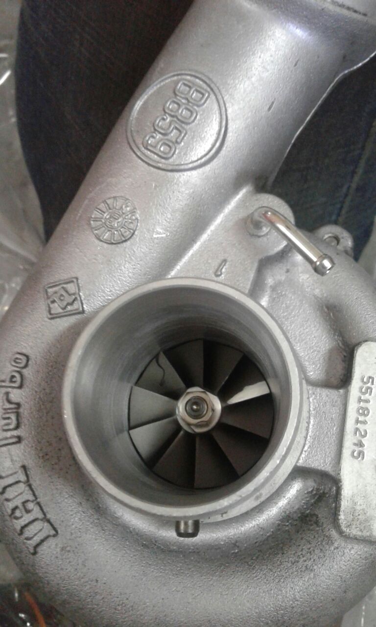

I have hybrided my turbo for a larger compressor, deleted the egr system, put a larger intercooler, dpf delete hks evc 6 to controller the boost and tuning. Pushing about 200whp on stock clutch. Only did hid kit for aesthetics. Prefer a sleeper.
Which turbo is that? I have a Fiat Doblo Cargo 2004 and thinking about making it a bit more of a sleeper. Currently just have EGR deleted and a basic remap, and it goes well enough.
It is the stock VL25 turbo but just with a larger compressor wheel. I would recommend sticking with the stock turbine as going bigger will make the boost threshold very high up in the rpm range.
