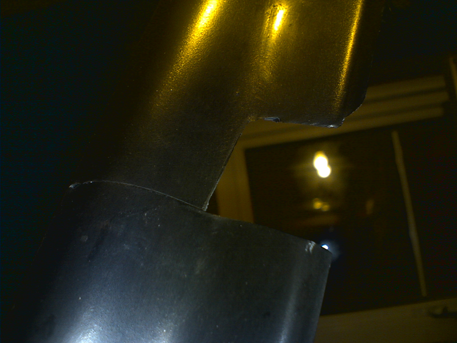

beau Patron member Parked in the garage Joined Nov 26, 2004 Messages 15,373 Points 3,223 Location southend on sea, essex Mar 4, 2006 #1 how can i repair this? i still want to keep them the black plastic so how can i repair them? theres the bit missing and then a crack. Attachments Image579.jpg 259.5 KB · Views: 71 Image580.jpg 259.1 KB · Views: 32
dave ****** Parked in the garage Written 10+ guides Joined Aug 10, 2003 Messages 125,214 Points 24,472 Location Essex/Suffolk border Mar 5, 2006 #2 fibre glass from behind, filler from front
OP OP beau Patron member Parked in the garage Joined Nov 26, 2004 Messages 15,373 Points 3,223 Location southend on sea, essex Mar 5, 2006 #3 dave said: fibre glass from behind, filler from front Click to expand... but then how would i get it the matt black plasticy?
custard Status: DEFCON Grumpy Written 10+ guides Uploaded 5 resources/downloads Joined Nov 4, 2003 Messages 48,591 Points 10,663 Location Edinburgh Mar 5, 2006 #4 you dont,just primer the whole skirt since you are selling them

thepottleflump Shut Up, Fool! Parked in the garage Joined Jan 29, 2005 Messages 2,905 Points 574 Location Surrey Mar 5, 2006 #8 Prime and spray a matching grey/black colour?
faster4_tec Burninator of threads! Parked in the garage Joined Oct 22, 2004 Messages 7,344 Points 1,120 Location Sunderland and LakeDistri Mar 9, 2006 #9 as dave said, fibre glass them, filler on front, sand, flat back area, prep whole skirt, prime, flat back, prime, flat back etc. then paint, then paint, then paint, then lacquer!!! And don't scratch them with your foot the first day they are on
