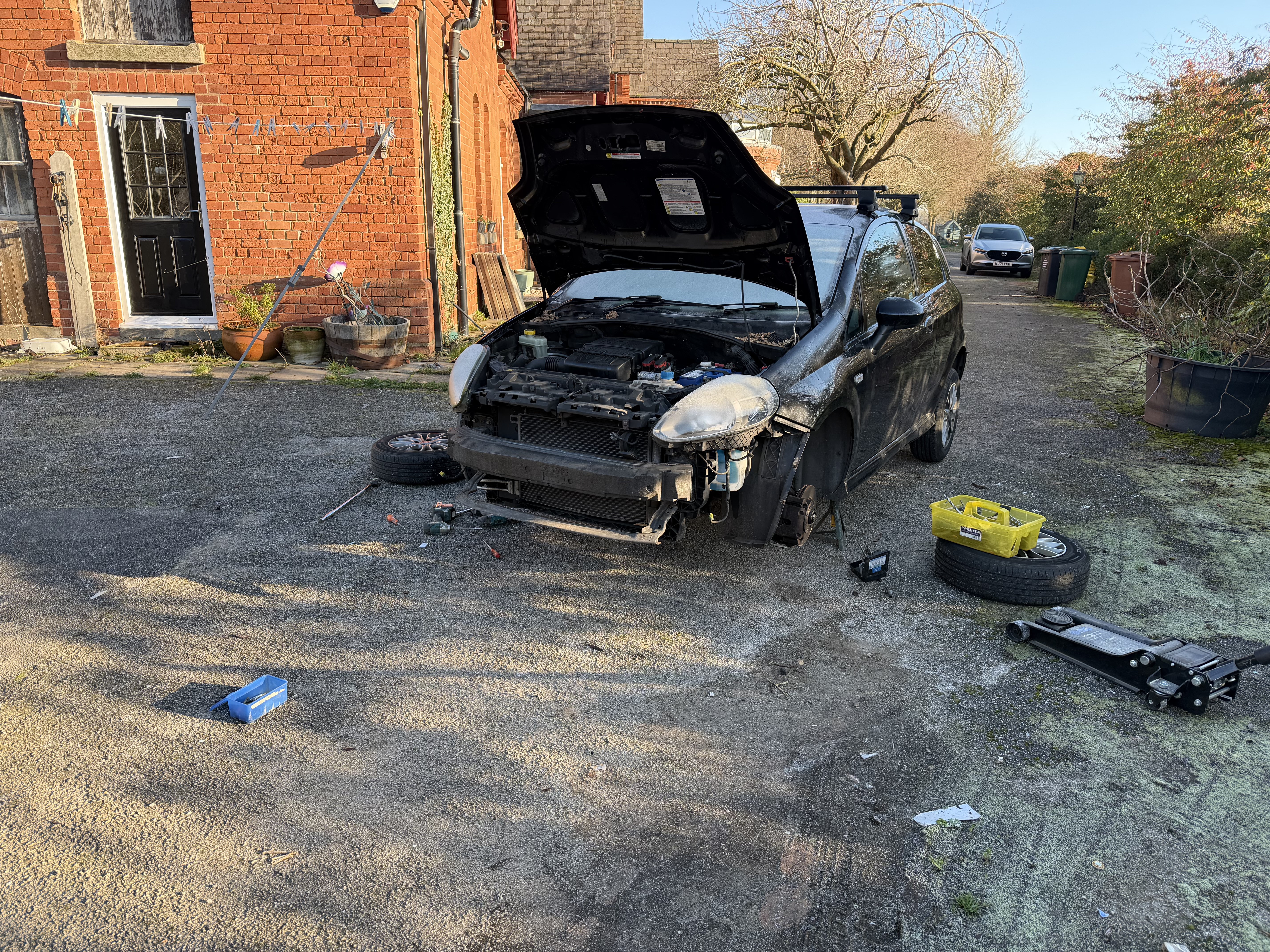

Arch liner screws are rusted up so waiting on some replacements before i drill them out and drop the bumper off and check the voltage on the horn.

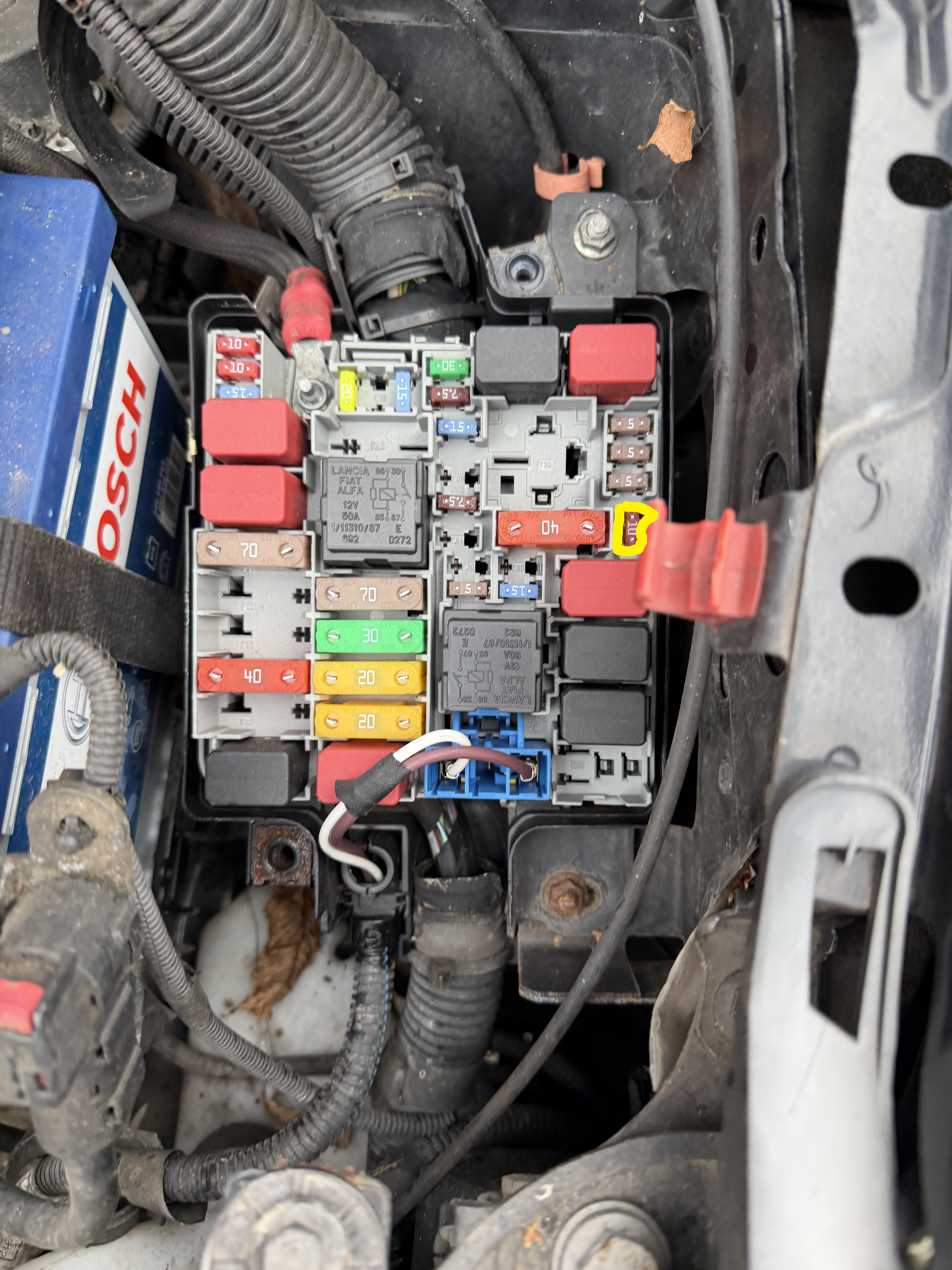

In the meantime I thought I'd check the fuse and the relay. All the wiring diagrams I can uncover show a different fuse box with a fuse and relay not just a single fuse.
The fuse box is as below and think F10 is the horn fuse but no relay?
Anyone got access the to relevant wiring diagram or can offer any advice.

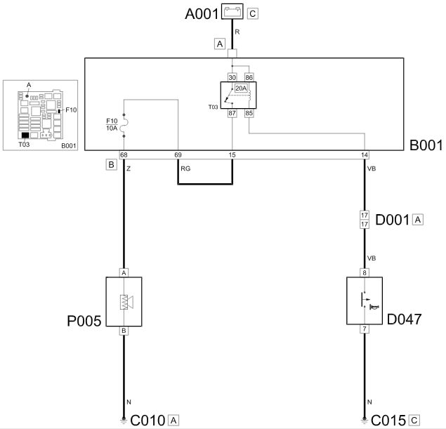

Wiring diagram allowed me to check the relay which was working fine so directed me to the horn. As suggested unplugged the connections and put them back together and its back in action.
Not the most accessible place to get to but not so bad when you are sure its the problem.
