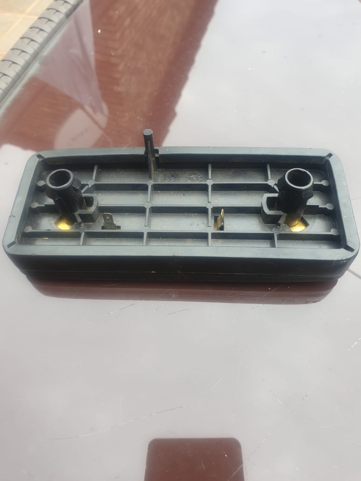

I have a 1993 uno 1.4. the horn does not work. i took the steering wheel and removed horn buttton. there are two spade connectors. do these connect to something please help.
peter
