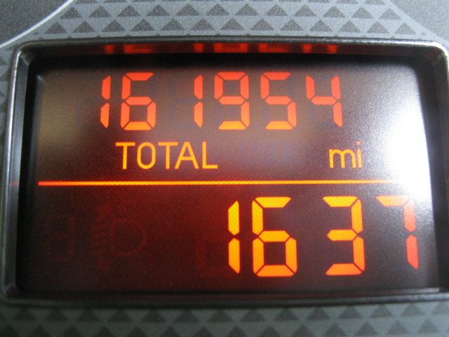

This is the only one I've got on this computer:
