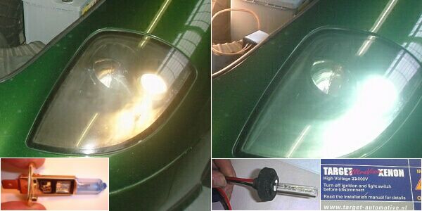

Technical HID Headlight Conversion……….
Is it me or in the bottom pic, it looks like you have LHD headlights installed??
And in the top pic, why have you been coating your underside in cuprinol:D
Trick of the light - they are RHD's..........
Ah, the cuprinol can - erm a bit embarrassing but that's full of spanners - really must get myself a proper toolbox - another one on the 'to-do/to-buy' list...........
Fitted a set of white 4600k's. Look good with a blue car and the difference at night is :eek: . Simple to do. basic electrics, screw driver, cable joiners etc. Box of band aids... I'd like to meet the comedian who did the lamp design. Lots of room there isn't.
Agreed - easy to do but lots of band-aids, patience and a disjointed head needed - I will get around to posting a how to with piccies as soon as I stop posting on the FF!!
wanted: multi-elbowed, multi-joined greasemonkey
prospects for promotion after successfull completion of lightbulb replacement exercise.

My HID conversion worked fine. Hardest part was making and fitting a bracket for the HID transformers. It now blocks access to the back of the light unit so adjustment / bulb change on the mean beams means the bracket has to come off. I found the lights beam needed lowering after HID fitting..lots of irritated users flashing their lights coming the other way.
Worked fine for a week until somebody drove the car off a ramp and smashed both lamp housing and bulb unit..
If anybody is interested I'll put up some pics of the conversion / brackets?
I have found the difference since fitting my HID conversion 'night and day'......

HID conversion is a must, mine is a daily driver and the thought of driving around the unlit roads where I live was enough to drive me to buying a set from Hong Kong. Have to say that they work REALLY well and only cost £50!!
